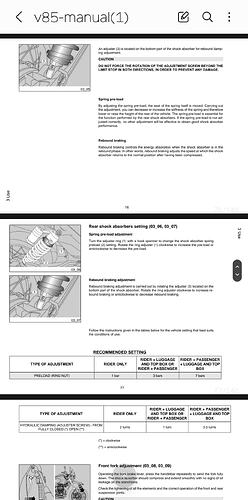

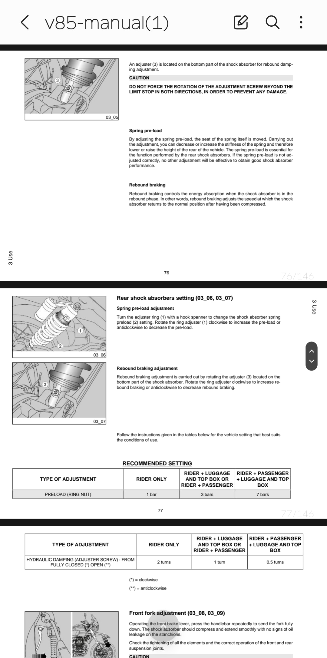

Is there a standard suspension set up as I can’t find anything in the manual which suggests settings?
yes, there is a standard set up.
Thanks for finding that, for some reason I haven’t got that in my manual (handbook), it’s very short on information? Do those adjustments apply to the front suspension?

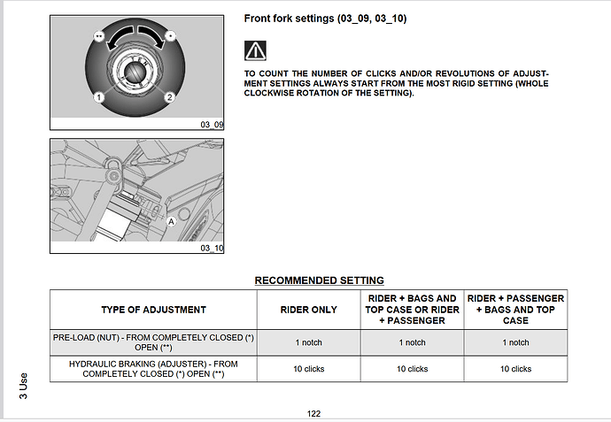

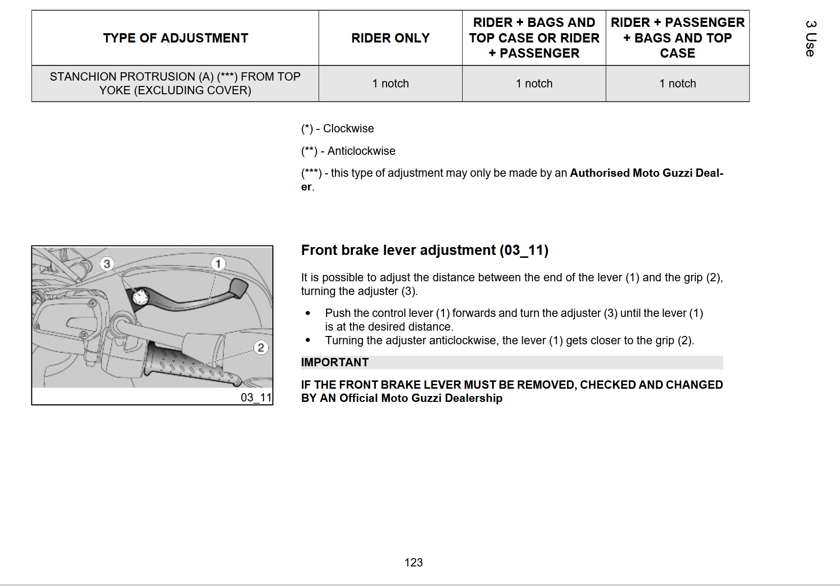

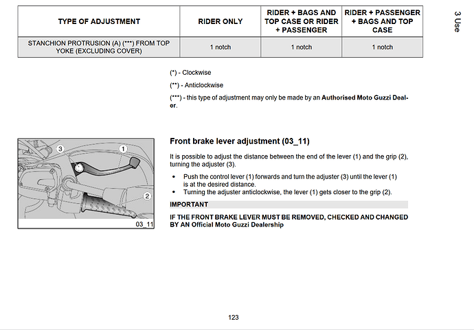

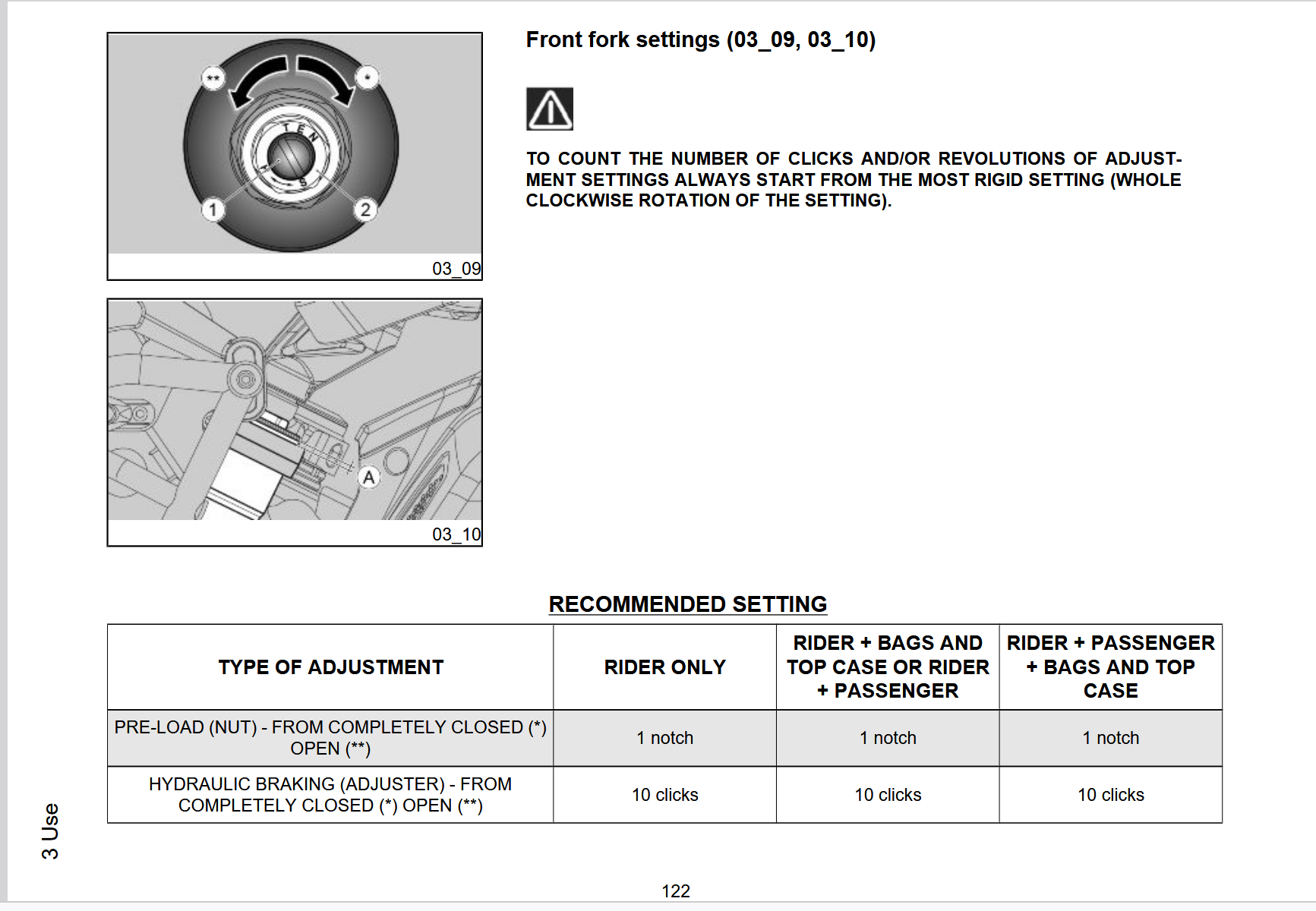

there’s another page for front, but i don’t have a screen shot, it gives the same setting for all situations anyway, I think from memory it was one turn out anti clockwise from fully clockwise but I will try and get you a screenshot later and add it to this post
Pages 122 and 123 from the owners book on front fork setting - i think they may display here in reverse order
