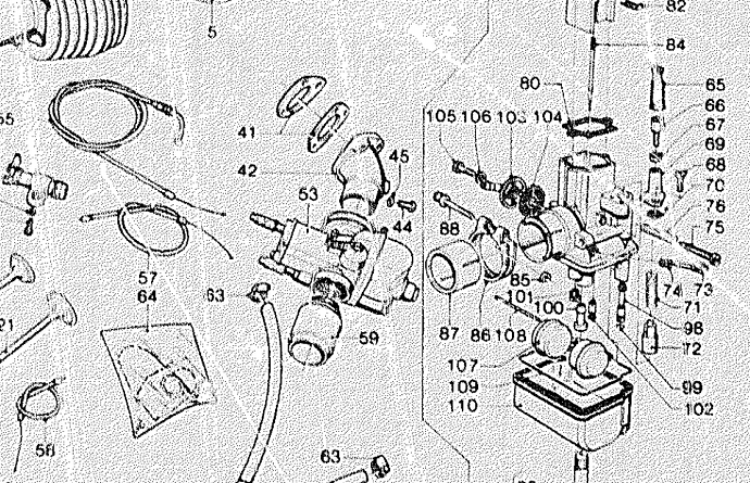

So, to be clear, you need Parts 1, 15, 16, 19 (x2). ???
You might also need the tubes that screw into the ends of the carbs. Part 59 in this from the parts list.

Also I need part number 59 the air funnel For the carburettors. Also, if you have them the four indicators for the bike plus a clutch lever. Regards, Graham
