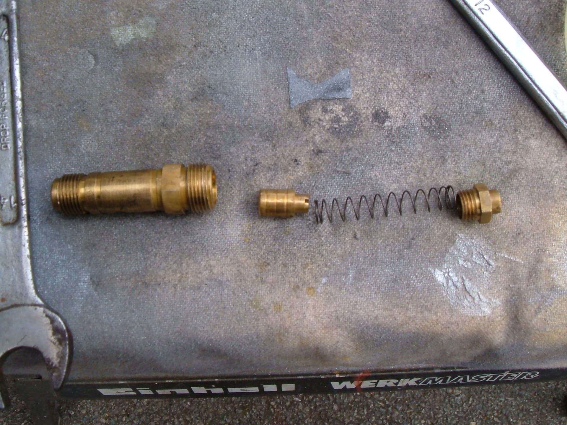

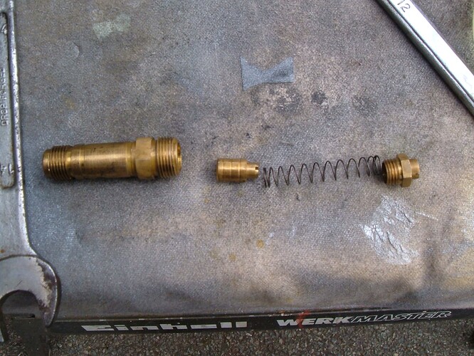

Check the accelerator pump inside the main jet tube. That gets filled with crud, there should be a small plastic ball inside that rattles. It’s the bit in the middle in this photo. I couldn’t get mine apart so just poked through the small holes to clean it up.
