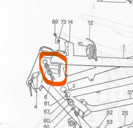

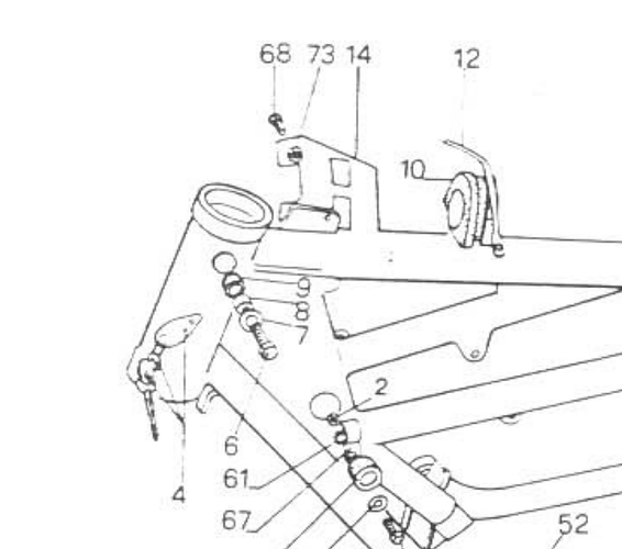

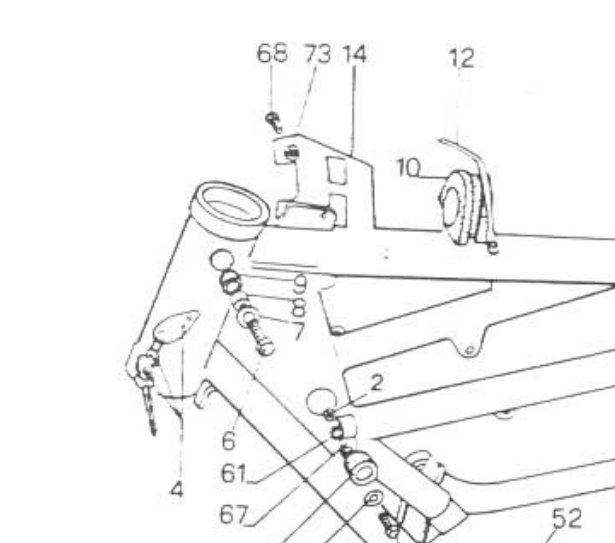

The part numbers are as follows
Screw M8 x 25 Part number 98074425 https://www.stein-dinse.com/en/item-itemId-1436797-srsltid-AfmBOopoCG4y__CSiTTTobVIpBFyR__YKDKoIan2xroiakfPl\_.mrmzBQ\_.C.html
Washer 8,4x17mm Part number 95001208 Moto Guzzi/Aprilia Washer 8,4x17mm - Le Mans, Mille GT, Spare Parts for Moto Guzzi, Ducati & Aprilia | Stein-Dinse
Spacer Part number 91180810 No longer available NML Spacer Spare Parts for Moto Guzzi, Ducati & Aprilia | Stein-Dinse
