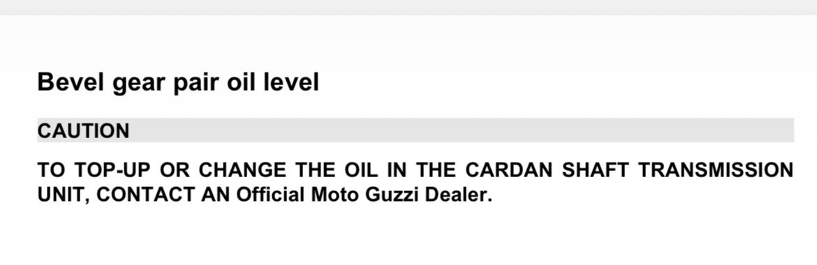

Yes the V100 is unit construction and yes the final drive is an alternative term for the bevel box.

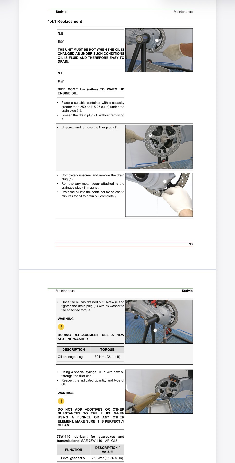

The above is taken from the Mandello owners manual, but can be done by yourself after removing the rear wheel. Buy a 65mm socket and a long handled torque wrench and you can access the filler cap through the spokes of the brake disc. In the Stelvio Service Manual they call this changing the transmission oil, and the picture for re-filling is below. I suggest you download a service manual from the Piaggio website to double check Having the tools to remove the rear wheel is going to also be helpful next time you want a new tyre!
