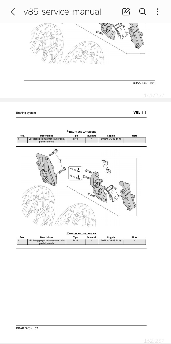

Does anyone know or know where to find the torque for the front caliper bolts on the 24 V85TT
Cheers

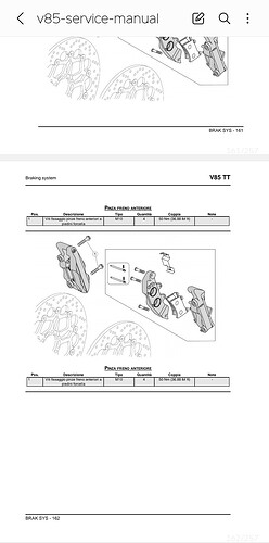

not a 2024 service manual but i doubt it has changed.
The whole manual is here
Thank you for that, very much appreciated :+1:
