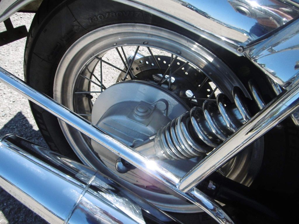

Apologies for my lack of knowledge but looking at two Cali’s. One is a 2001 1100 EV and has the spokes going to the outside of the rim so, I believe, it can have tubeless tyres fitted. The other, a 2008 cali Vintage, has the spokes all running in a line down the centre of the rim which, I assume, means they must be tubed. Is that correct that Moto Guzzi went back from a tubeless setup to tubed?
Yes it looks like Guzzi went back to tubed tyres. 2001 EV for me then ( nothing to do with the one in the photo ).
