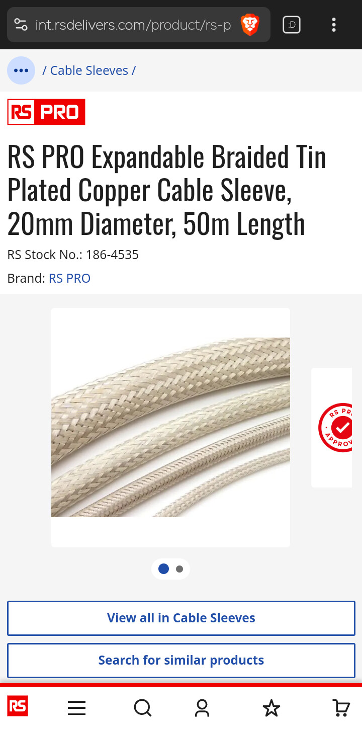

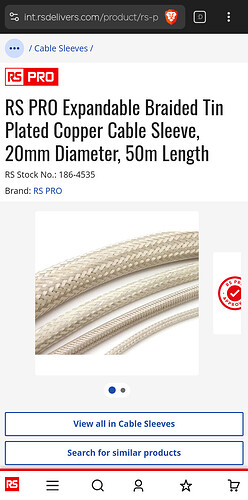

Is fitting the sensor sleeve something that can be done yourself?
If so, which sensor is it and where can I buy a sleeve.
The V twin booster plug, I got from Gutsibits, manufactured by Mistral, it does help a bit, and is easy to fit, it comes with a scan to your phone for fitting, also, there’s a you tube vid or two, which is helpful
Dont know if you can do it yourself, i may be wrong but i think it shields the fuel injection from picking up pulses from the ignition. Someone on here with more knowledge may know
you probably can DIY but I don’t know exactly which wire it is you need to sleeve
something like this would block interference, a smaller diameter would fit better
