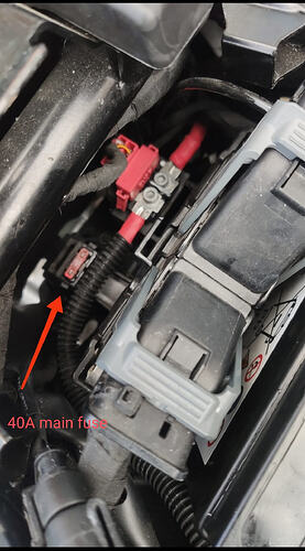

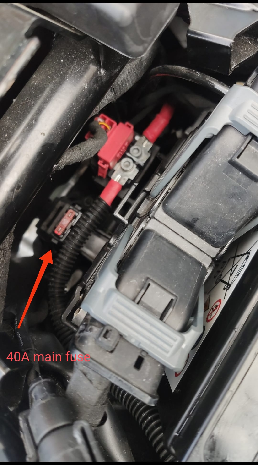

Problem solved ! 40A main fuse blown, thanks to everyone for your contributions and in particular Phil Skinner who was right on the money ! Bike is now charging fine with no parasitic draw while powered off as indicated by ammeter clamp and a charging voltage of 14V. Much appreciated :+1:

Hi Omegad, glad to hear you have solved the problem. It would be useful to others to know what caused that fuse to fail, (on my Stelvio 1200 it was a short within one of the spotlights) also it would help to know what items are on that 40amp fuse circuit. Cheers Phil
Hi Phil, that fact that the fuse hasn’t blown since I took the bike out for a test ride is encouraging so I am hoping the reason it failed was a bothched up jump start prior to me getting the bike. From what I can gather that main fuse is linked to almost all circuits on the bike, TFT instrument cluster, ECU, Regulator/rectifier, cooling fan, ABS module, fuel system include ride by wire throttle, ignition system and like you already mentioned the lighting circuit via secondary fuses. I’ll inform all on this thread if I have any further issues. Many thanks
Was there any corrosion evident on the old fuse? My reason for asking is the 1400’s had a problem of fuse and holder overheating due to building resistance and then heat build up. Victims took to changing battery 40 amp fuse block to a separate one; and the wiring if overly affected.
A benefit of this was “back to normal” charging voltage (~13.4 ^ 14.2). Just wondered if your motorcycle had maybe been sitting in slightly damp environment before you took ownership.
Of course, may have no bearing whatsoever, just mildly curious as I would suspect similar fuse blocks being sourced by Piaggio.
