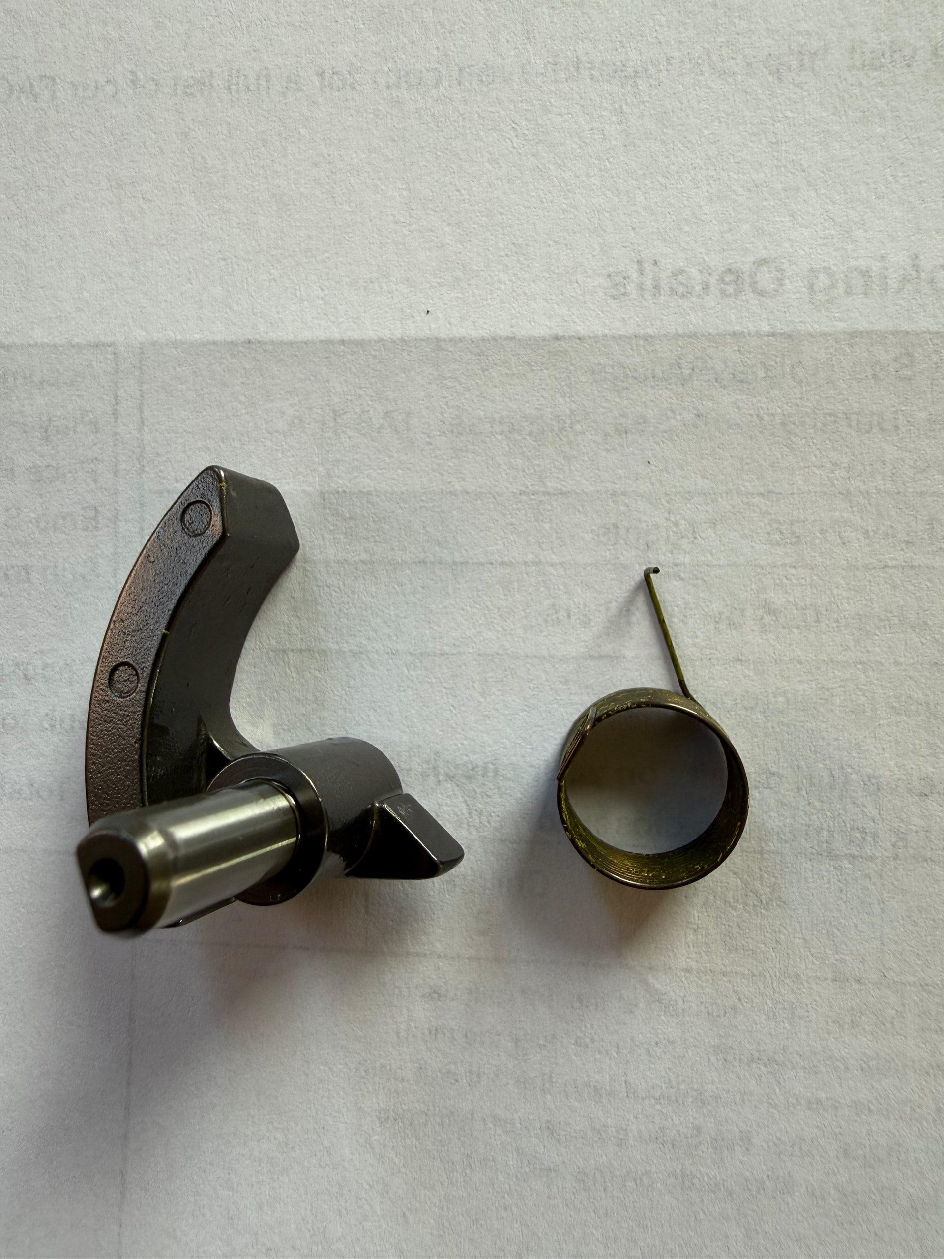

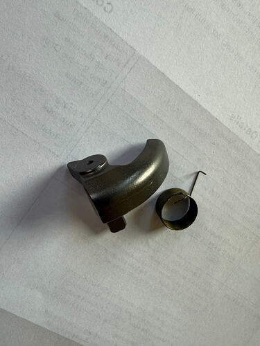

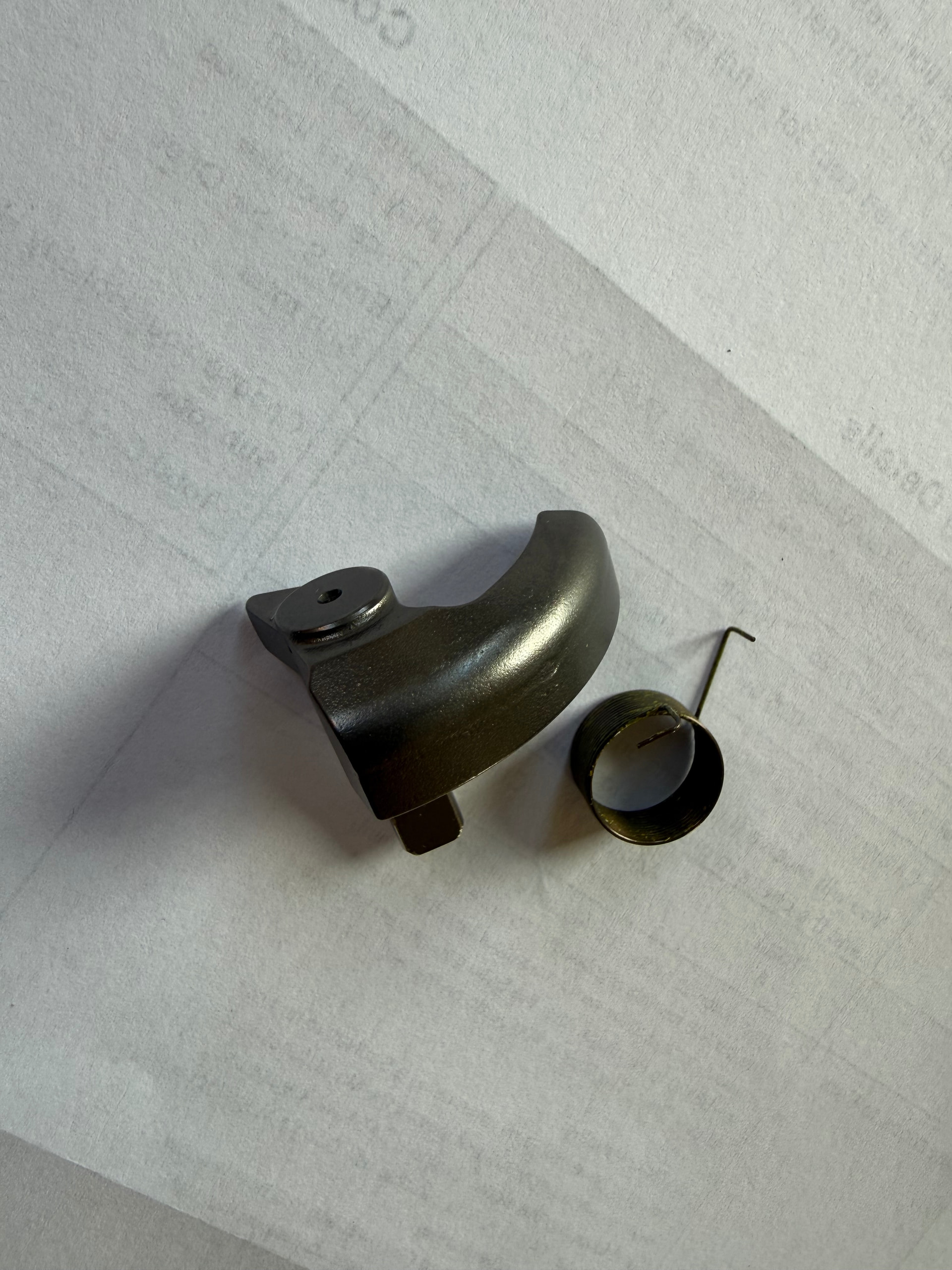

Had an off beat rattle on the right hand cylinder, there is a service bulletin advising to swap out decompression rocker for an updated part and if that doesn’t cure it then remove , there’s no replacements yet so it was removed………engine feels even more smoother

Don’t buy a Honda 1000 or 600 they’ve currently got oil consumption issues…I was asked for a video, but the mechanic had several videos already which I viewed and quickly identified as the same as mine , so they happily removed item, apparently will do no damage if left in, the dealership is MSC Nottingham, whom I’ve found to be very helpful and accommodating
