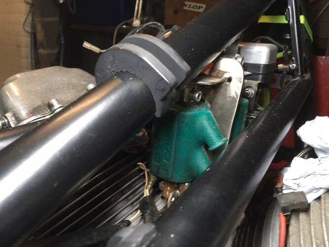

Thanks, however getting to the coils is nigh on impossible, they are tucked away under the steering head, how they got them in is a mystery and getting them out nearly impossible, as for testing them in situ also near impossible as they are stacked on above the other crammed up against another item which is also difficult to remove.

Might be worth moving them to the easier maintenance position (like a T3, LeMans or Spada) under the LH side panel. Much easier to work on or swap out. I have seen them behind the steering head on some big blocks and it does look very cramped and awkward.
Given your issue I’d bite the bullet and move them as part of the diagnostics.

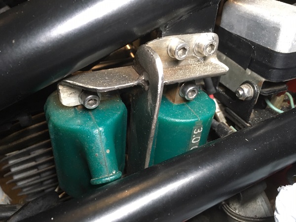

My coils are under the tank on a self made bracket, and both easily accessible with the tank off.
