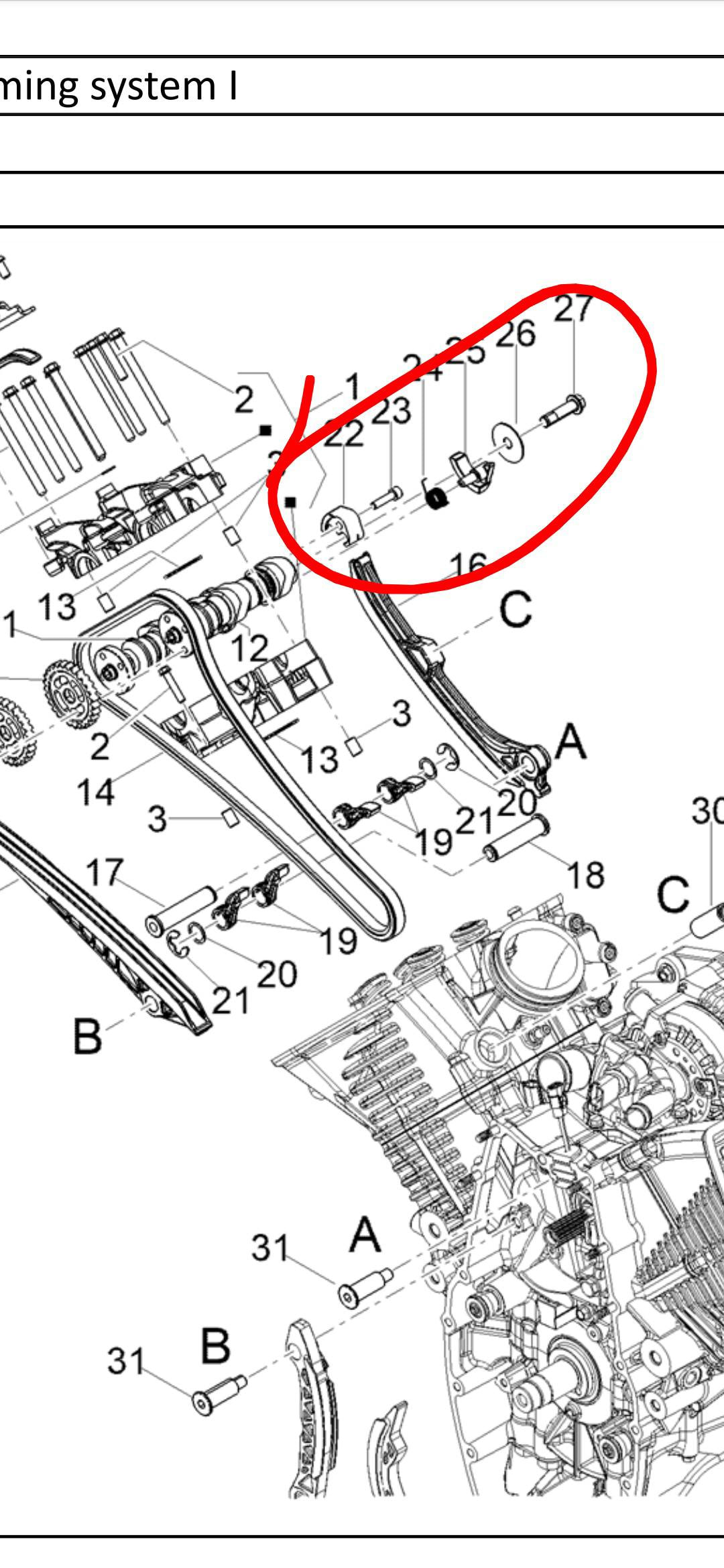

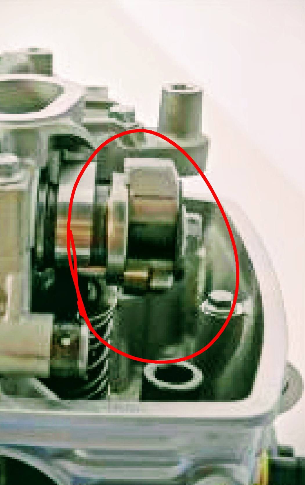

The V100’s engine is the only Guzzi engine i’m aware of that features an automatic decompression system. Probably necessitated by that 12.6 compression ratio and the big bore. To the uninitiated, a decompression system is a starting aid to make the starter and the
battery’s work easier. It achieves it’s goal via a small protrusion next to one of the exhaust camshaft lobes, that keeps an exhust valve slightly open during compression, so the piston has less pressure to work against. Once the engine starts counterweights are flung out and the protrusion moves out of the way.
This post was originally posted on Facebook by forum member noamlu *

A video of a guy rebuilding one was showing how it works.

My Stelvio has just been in for this issue and the right hand decompression lever was removed by the dealer under instruction of the factory, which has resolved it. No issues with starting since.
Several others have reported similar on Facebook and the issue appears isolated to the right hand cylinder. The system is present on the exhaust cam on both sides and the majority of the parts appear identical, so an interesting one!
Apparently the factory have issued a technical bulletin instructing the removal of the right hand cylinder decompression lever on all E5+ V100 engines as a matter of course during servicing.
