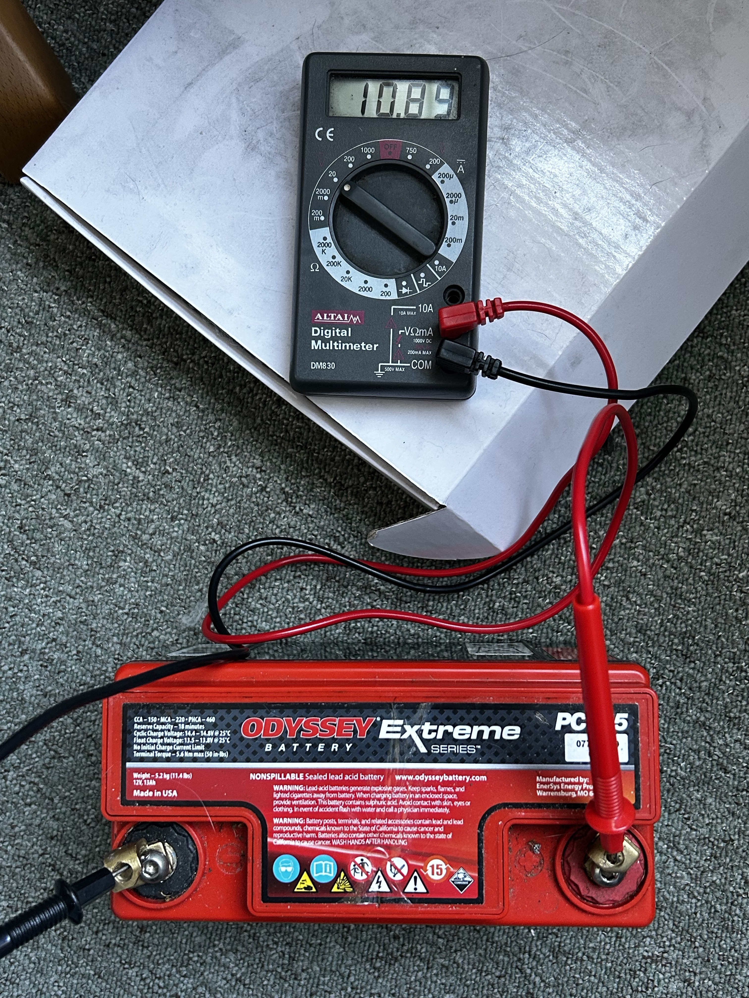

Andy, I have another very dead PC545 battery
Discharged voltage is 10.89 v !
I will try the Ctek charging, you suggest using 5 amps, but not the Ctek reconditioning cycle.
Please confirm my understanding is correct
Thanks
Oooh, that is low OCV. I think that may have lost a cell, and it might be beyond rescue. That’s what happened to the one I lost.
Still, worth a try. Yes, you have it correct. Charge on the ‘car’ ‘AGM’ setting but not the CTEK ‘recond’ setting. Let it sit for a few hours in the float mode. I don’t know what this does but Odyssey seem to recommend it. I suppose it makes sense to let the chemistry settle.
To condition, discharge through a light bulb 'til 10.00v and then immediately recharge on ‘car’‘AGM’.
Good luck.
