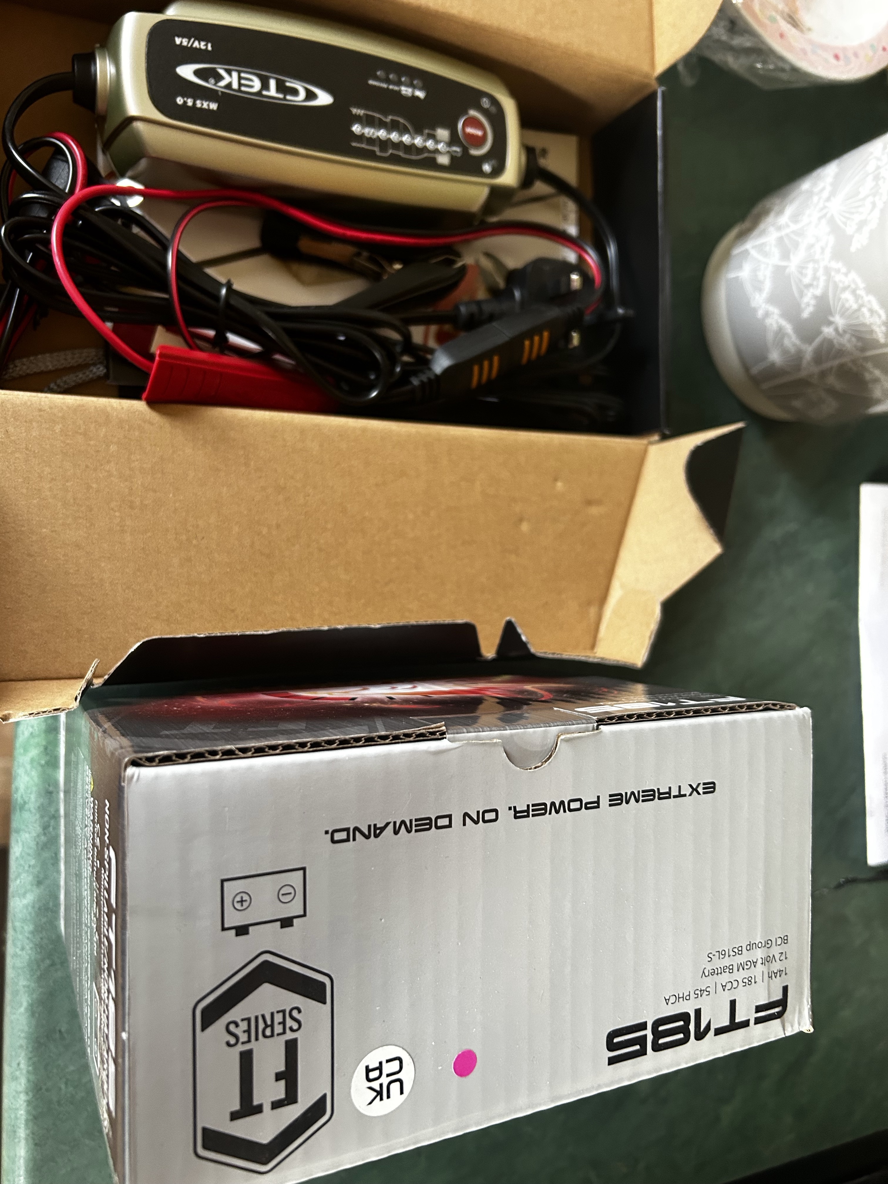

Andy, my Ctek charger has just arrived

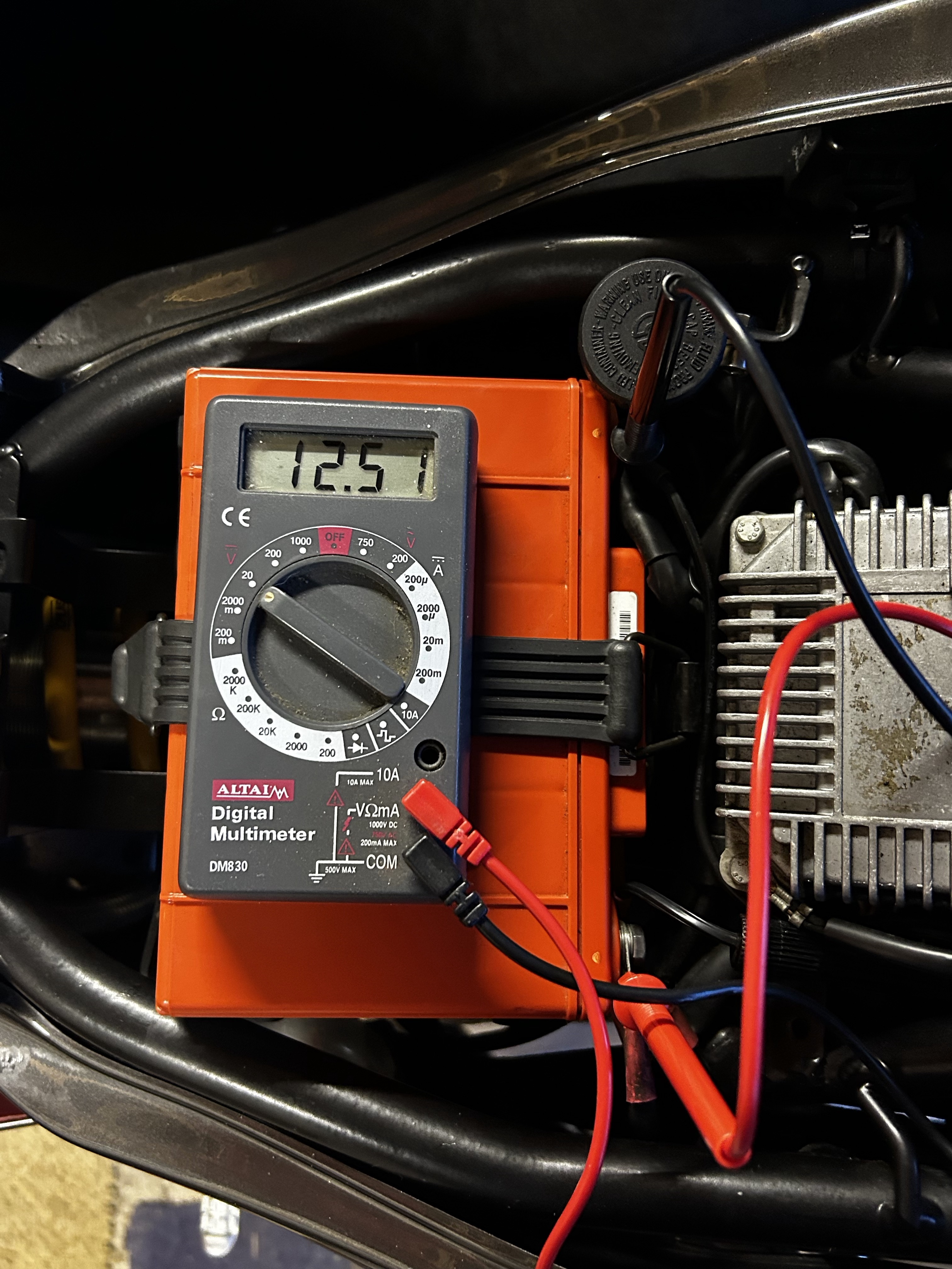

What might be interesting is to check the Open Circuit Voltage after disconnection from the Optimate. Unfortunately that’d need you to wait overnight for the voltage to settle. Then to connect the CTEK and see what the OCV is after it’s completed.
I guess with that many machines you can start on one battery immediately and let the other two settle to do this check on them. I’m guessing you’ll see OCV of something like 12.6v after Optimate and 12.9v after the CTEK. It’ll hopefully give you some confidence to see the actual difference.

FT185 & Cteck now arrived. I’ll let you know how I get on over the next couple of days.

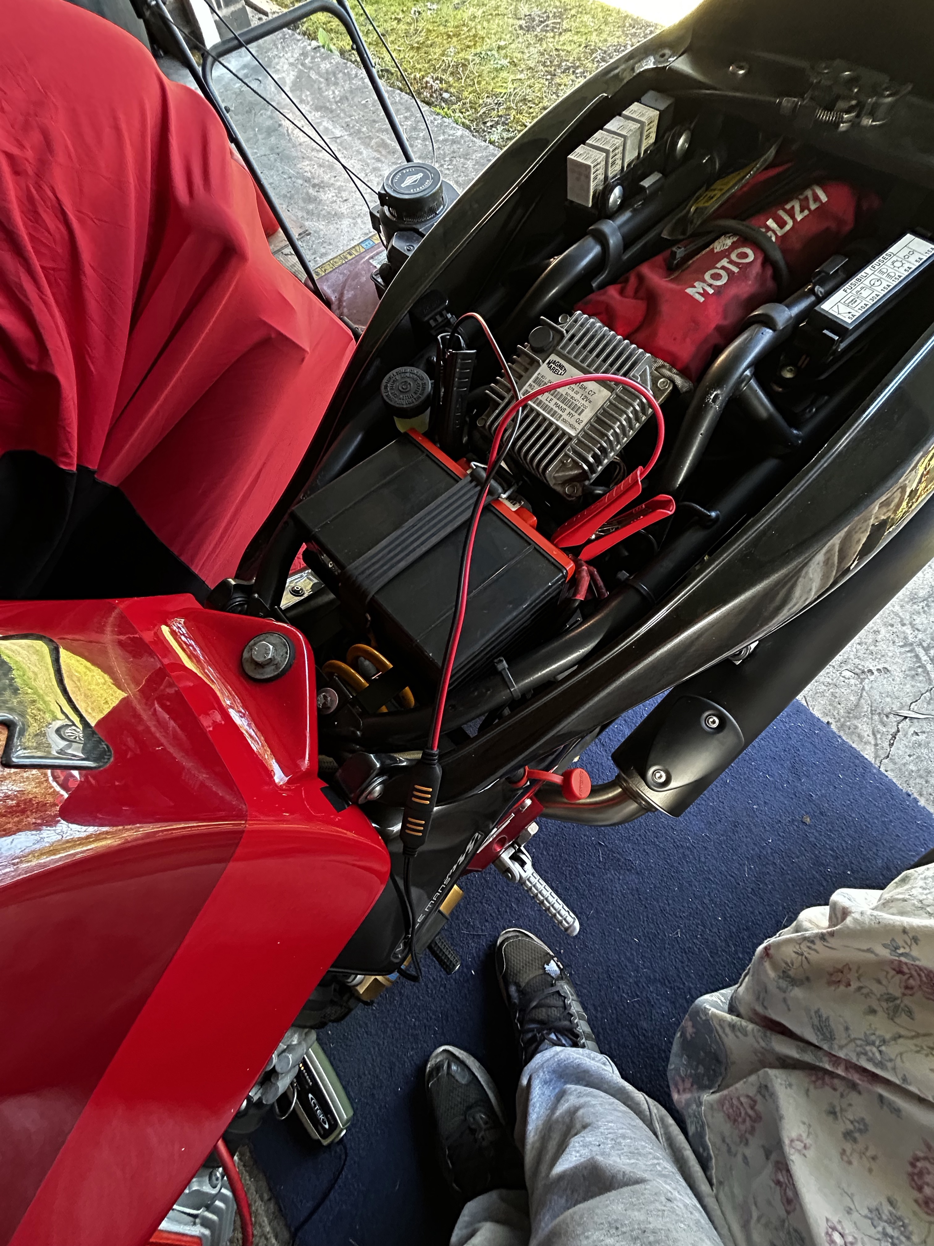

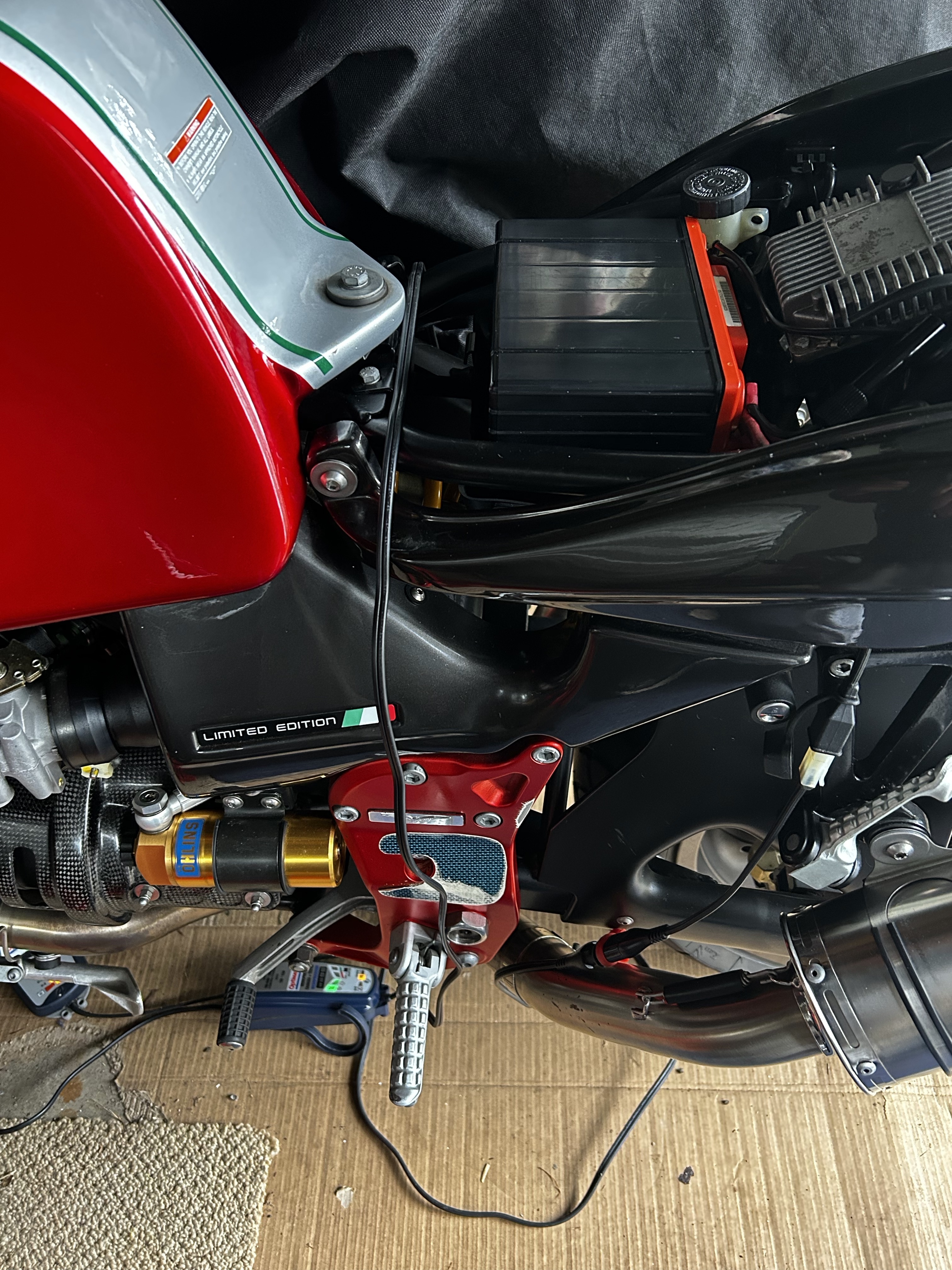

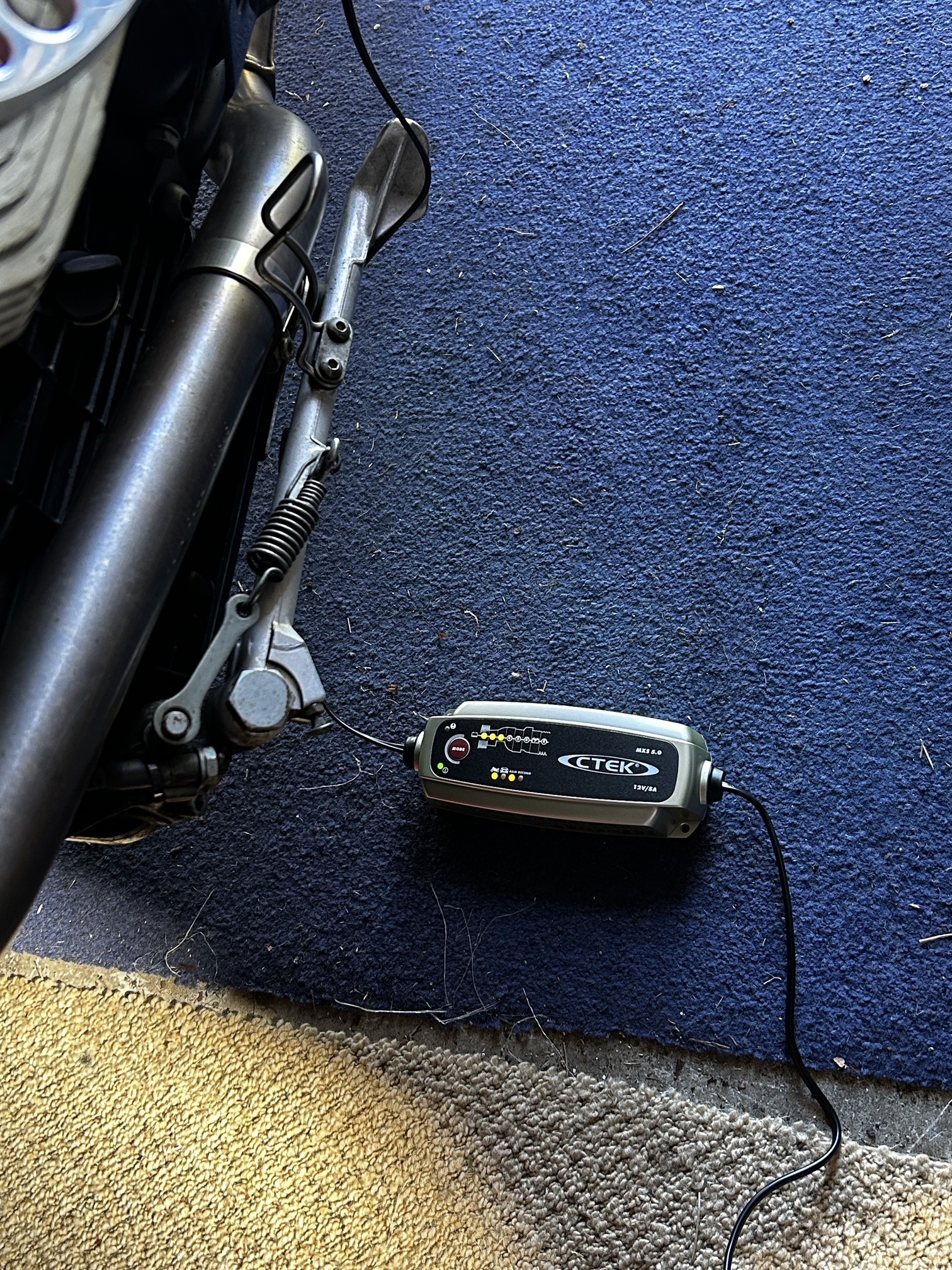

OK, first task for the acted. I’ve connected it to a supposedly fully charged PC545 on another of my Guzzi’s. It was connected to an Optimate last week & indicated fully charged. I note that the acted is on the bulk charging light, suggesting that the battery isn’t really fully charged as the Optimate suggests
The Ctek connectors are unique to Ctek and not compatible with the SAE dongles supplied by Optimate, so have to connect on the battery terminals using the croc clips
Ah yes. I don’t have Optimates but I’ve got a 10A SAE pigtail mounted on the Mandello for the airpump in case of roadside puncture. I made an adaptor up from the CTEK pigtail that came with the charger.
The CTEK pigtails are available from Halfords if you want to change, but given you’ve already got SAE on your fleet, the adaptor might be better idea.
Another PC545 battery that was charged on the Optimate last week. I put a meter across the unloaded battery - 12.51V. It’s now connected to the Ctek charging on AGM mode. When the Ctek is showing it’s fully charged I’ll measure the unloaded voltage again & advise
