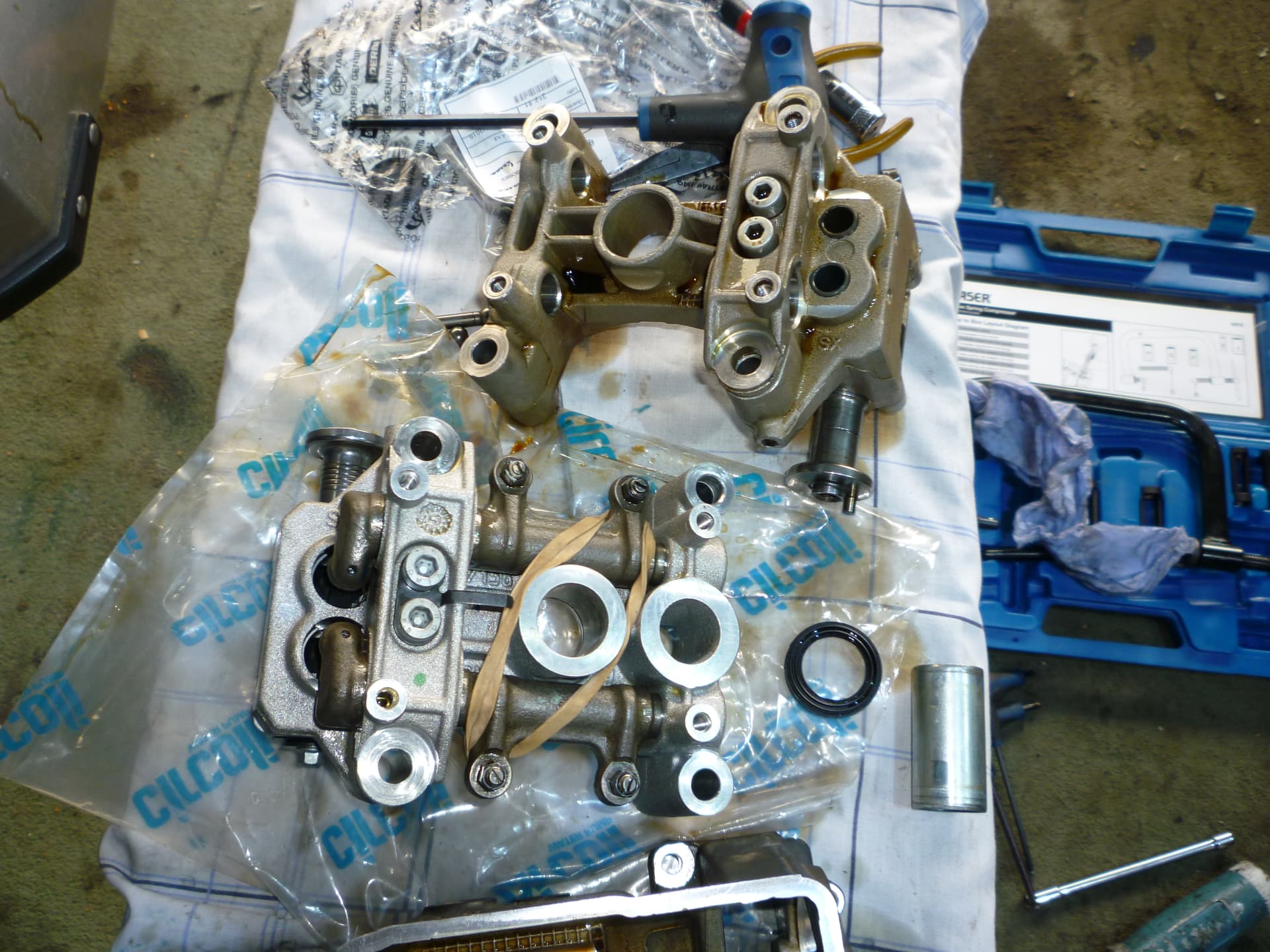

Hello Wayne, it is the cam followers that were the problem, my bike is a 2010 4V Stelvio and it had flat cam followers, these cause early wear on the camshaft. The later engines have roller cam followers that resolve this problem. I would assume that your bike if produced in 2015 would have the later roller cam followers.
I got my roller cam conversion kit free from the factory via Twiggers in Loughborough, I had to pay Twiggers to install them. I got the kit free of charge as I had a full dealer service record. The kit was about £1000 (but free to me) and the labour about £400. The bike runs well after the conversion.
Enjoy your bike!
You can check to see by removing one of the rocker covers
The old are smaller than the new, I ended up buying my kit and with help from a few dealers still managed to buy wrong kit (that was using frame and engine numbers and year of bike)
I don’t believe that any of the V1200 Sports were ever fitted with the roller tappets at the factory. Even if the year of registration was 2015, it doesn’t mean that it was manufactured then.
I had a protracted dialogue a few months ago with a non-Moto Guzzi dealer who had a 2015 Sport for sale. Afetr getting them to agree to remove one of the rocker box covers and take some photos, it turned out to have flat tappets and, was in fact manufactured in 2013.
If you want corroboration of this unfortunate situation speak to someone like Twiggers Motorcycles.

Thanks mate. I thought that none of the sports models had the upgraded engines fitted. Guess I’ll have to suck it up and repair the engine.
100% of the 1200:Sport bikes were built with flat tappet engines
Piaggio were free issuing the roller tappet kits if you could prove full Guzzi dealer service history, you had to pay the fitting labour cost (or DIY)
Not sure if Piaggio are still doing this, after all it’s more than 12 years since the last flat tappet engine was built
