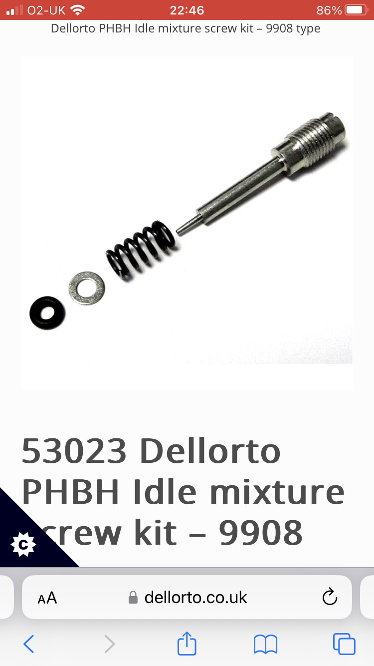

Yep Eurocarb sure is well useful. This is what it should look like… I’m not 100% convinced this is the ‘correct’ kit for a the V50, but definitely confirms what is needed. I do have a couple of rebuild kits and there are several spare o rings, so I guess I’ve got these, now to find a couple of suitable washers.

Over the course of Saturday pm and yesterday evening I successfully reassembled the LH Carb now with an o ring and washer on the tick-over screw, where none was previously present and replaced the old o ring below the washer on the air screw… yes with a bit more poking around it was there all the time. I’d previously fully stripped and cleaned the LH Carb, checked float level etc. On the RHS, did the same with tick-over screw, but in the depths of the air screw hole was a jammed oversize (Green) o ring and no washer… so this now corrected.
The O rings I used came via two Dellorto rebuild kits and I found the two smaller washers in the bits box and the larger (tick-over) washers were created by filing down two old BA brass washers… these are available from Eurocarb, but I needed them now and postage would probably be >> price of the parts.
