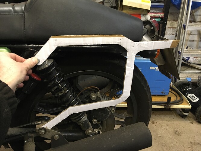

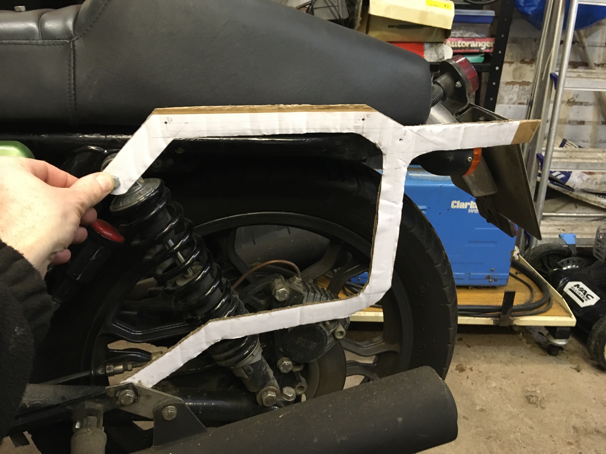

I’m just in the process of making some frames to attach the panniers from my loop to my slightly modified Spada.
I was going to weld some flat strip together, which is what the loop came with, but now it’s “made” in cardboard, it looks like it will lend itself better to a one-piece laser cut shape. I have downloaded some free CAD software and can hopefully create a DXF file to send to a local place to cut them.
Why not have a go yourself?

Good plan RR, but I think you may want to add a brace between bottom right and top left, or possibly along the line of the shock? Unless of course you use a heavy section of flat but that would not help with the bike’s overall weight.
Tube is stronger for the weight but harder to joint at the corners and to attach fixing to.
I look forward to the photos!
The lower and rear parts replicate the brackets on the loop, but adjusted to suit the fixings available on the Tonti frame. On the loop, the top section is part of the the rack, but I don’t have one on this bike.
I may add a piece at the front, but I don’t think it’s necessary for strength as both fixings are joined together by some Italian motorcycle!
The bottom is the footrest and top is shock mount, exactly as the loop. I’ll get a photo of those brackets but it’s basically an L-shape.
Ian
