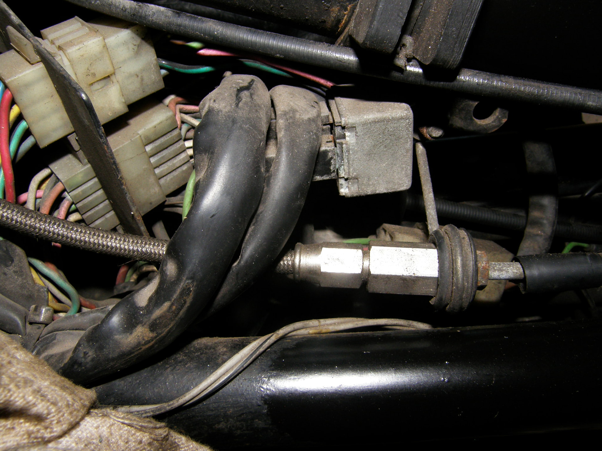

To connect to the rigid pipe, you will need a swivel type connecter, Check if you need the male or female option (probably female). This is the set up on my bike.

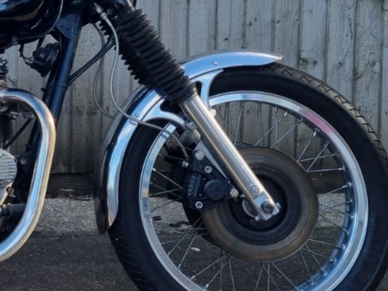

I find a neater way to connect the pipe to the caliper is with a banjo bolt and copper washers (apologies for the photo of my T140!)
Don’t apologise. Green with envy. :face_holding_back_tears:
BTW. I used a Goodrich kit for mine. The fixed pipe wasn’t problematic, but can be readily made up if needed. All standard parts.
Same for my later Cali 1100i.

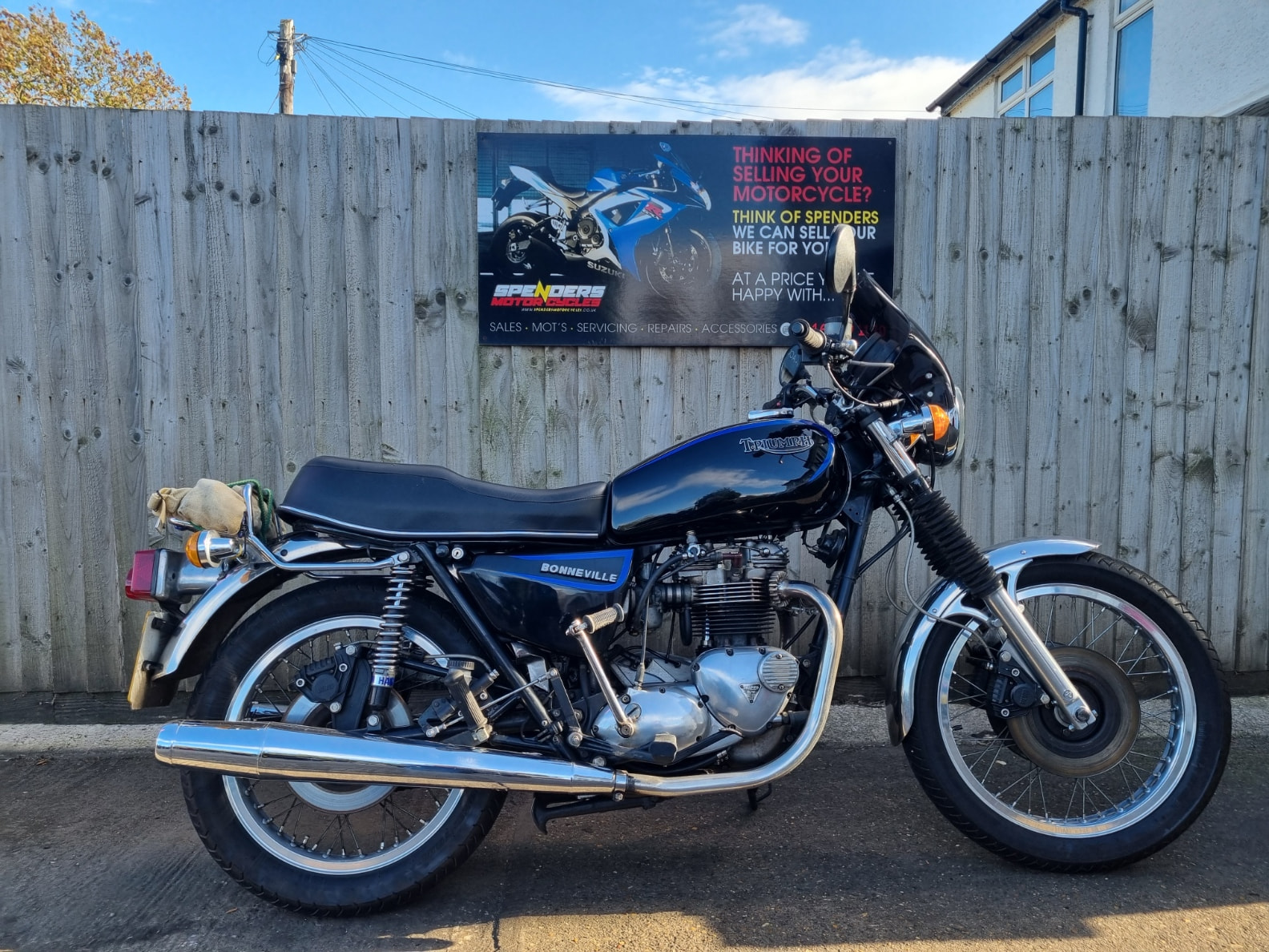

My T140 is one of those made down in Newton Abbott by Les Harris, after the Meriden Co-op closed down hence having Brembo calipers and Paioli front forks, plus a few other European parts on it.
