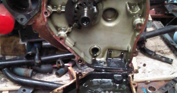

V50 monza gears
Just wondered if anyone has or knows where to get hold of replacement gears for a V50 monza
I think mine has had an issue where a shim may have decomposed and damaged gear 3. I know it is possible to get second hand gear boxes by mine has only done 10K and is like new other than this issue so would prefer to replace the damaged parts. Any comments welcome.

I had been developing an understanding and came up with the Mk111 as a direct replacement option. Knowing that I get would get the same primary drive simply by re-using my original primary drive gear (i) in the manual and main shaft idle gear (57 parts catalogue) which are both fine on my bike is encouraging assuming the splines are the same which by all accounts they should be. Second hand V50 111 boxes seem a little more common than Monza boxes though I am pursuing one at present. new bits are very expensive. One further development. When removing the gear clusters from the end casing I discovered the crimped nut on the end of the shaft behind the bearing had sheered off and was lying in the bearing housing. Can not understand how any of this has happened. Thanks for all the pointers

Can you point out which crimped nut did you mention?
