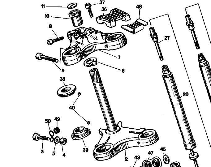

Thanks everyone - I tightened them just to the point where the play was gone, but during a shortish test ride, things felt great to begin with, but then gradually worsened, and sure enough the play is back. I had tightened the steering head fixing bolt and securing nut to what I thought felt right, but perhaps not tight enough? Do people have ballpark torque settings for those bolts? Or is this just a symptom that the bearings need replacing?
Looking at the parts book, firstly slacken off the 2 clamp bolts around the fork stanchions before making any adjustment so everything can move.
You adjust the bearings with the centre nut, number 10 and then the clamp bolt, number 8 should tighten around the nut to prevent it from coming undone. It does want to be tight, but remember it is only screwed into an alloy casting so don’t overdo it. Finally retighten the 2 stanchion pinch bolts.
I’m not sure about the purpose of the washer under the top yoke, number 6 in the book? I guess the tab locks into a recess in the bottom of the top yoke.

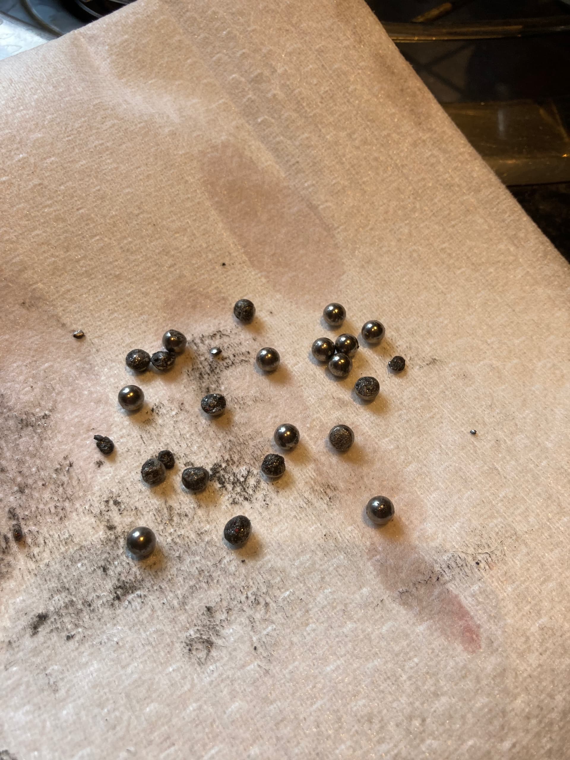

Ok, I’m really glad I got in there and decided to renew the bearings!
I’m going for the tapered rolller conversion at the bottom end, and sticking with balls for the top. Thanks for your help and wisdom!
Good decision! :+1:
Wow, they really are shot. What are the cups and cones like? Ball bearings are cheap.
