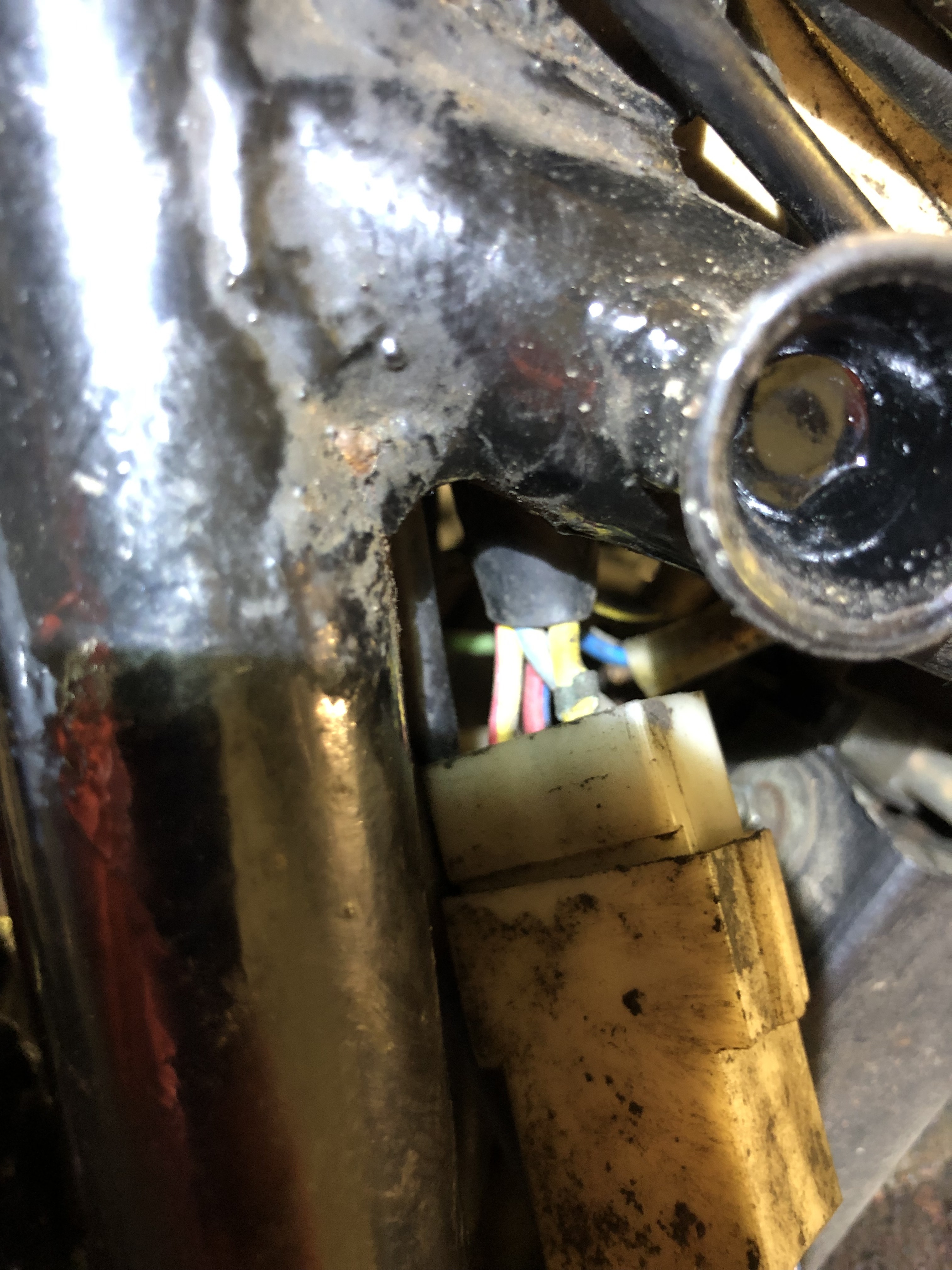

I started with an explore of the pick up wires, which were fine, but not the block connector at the top.. which had one odd and ?corroded/disconnected pin, now fixed. At which point bike ticking over like a clock (rare!) and running as a 250 single on either Pot.

The above pics show the ‘odd looking’ block connector. The Brass Spade didn’t match the others and was loose in the block… oxidation v. shiny suggested it was just to say ‘connected’… so maybe headed off a future problem…

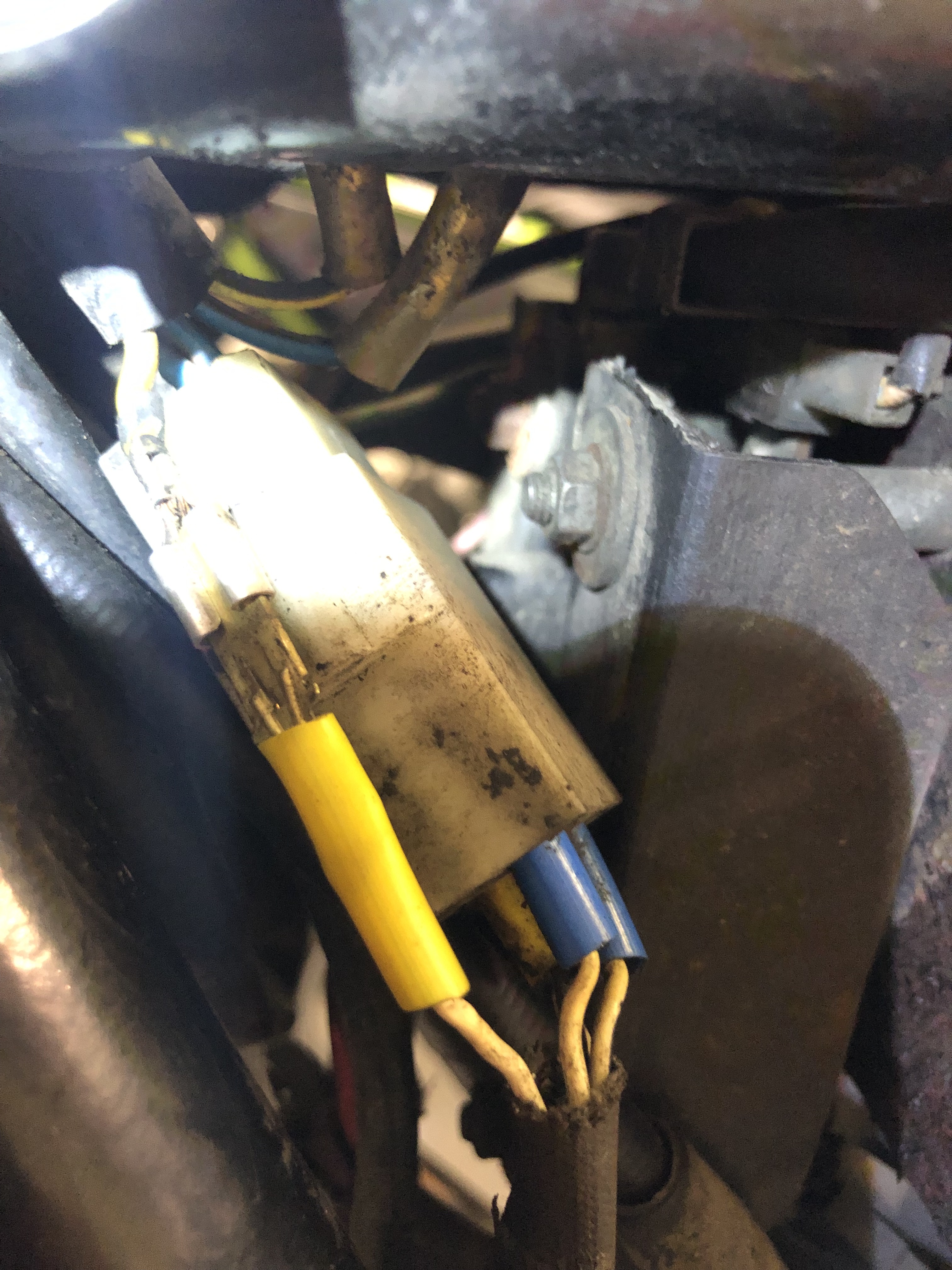

Did you put the yellow and blue sleeving on or was it like that already? If the latter, someone has been in there before… :astonished:
Now that is worth knowing, thanks.
It may explain the dodgy connector too:
I am also suspecting the Coils are not original… I don’t think an orange wire is shown on the wiring diagram and my Pals TL600 Ducati from 1981 has the same coils as mine c/w orange wires.
I did such bypass myself. It is 12- or 15-connector block with roughly same diameter wires, but two of them carry beefy +ve and beefy -ve, so +ve is first to corrode, always. Regarding coils, did your bike run properly before? have you heard it? Somebody could fit wrong coils, which have wrong resistances. All the data is in the manual. Worth to check.
