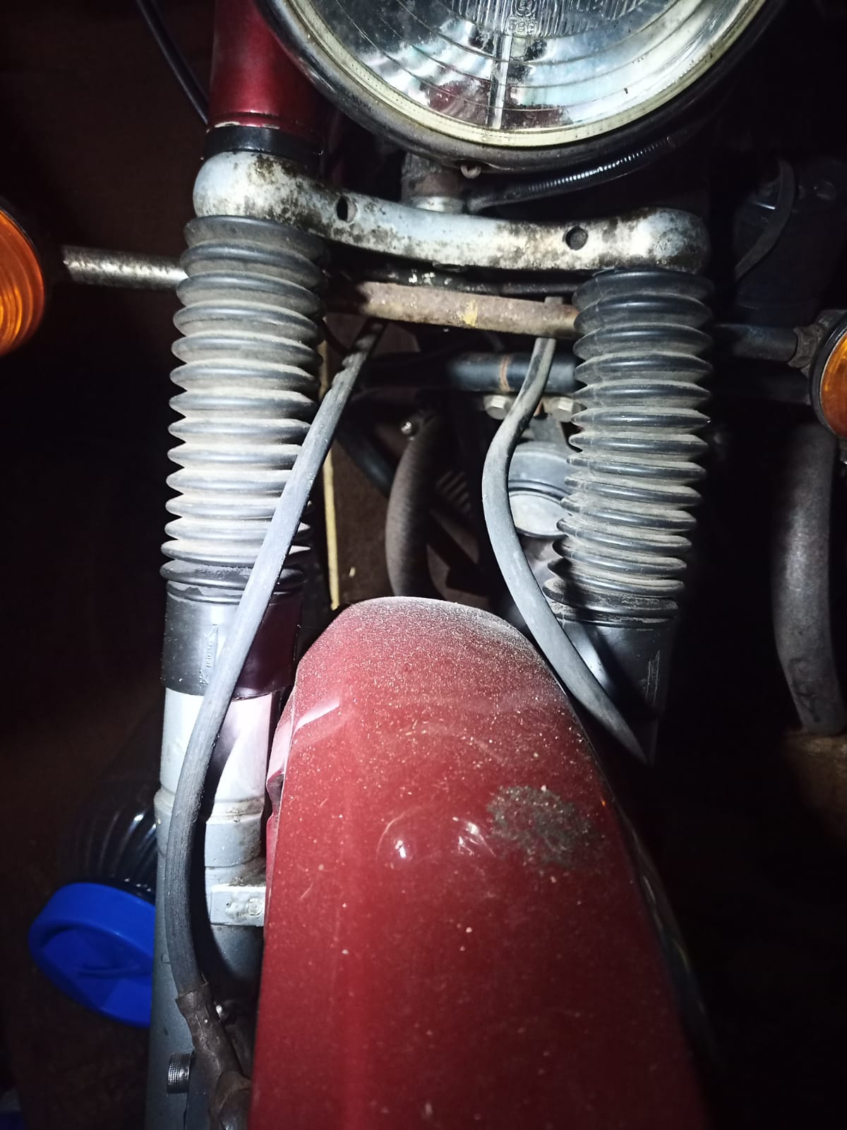

Hi. Im pretty sure my front brake hoses are routed incorrectly. They’re coming out the frame through the little triangular opening under the steering head and then under the bottom fork yoke. I can see that one of the hoses has caught in the steering stops.
Could anyone share a photo showing how the front hoses should be routed please?

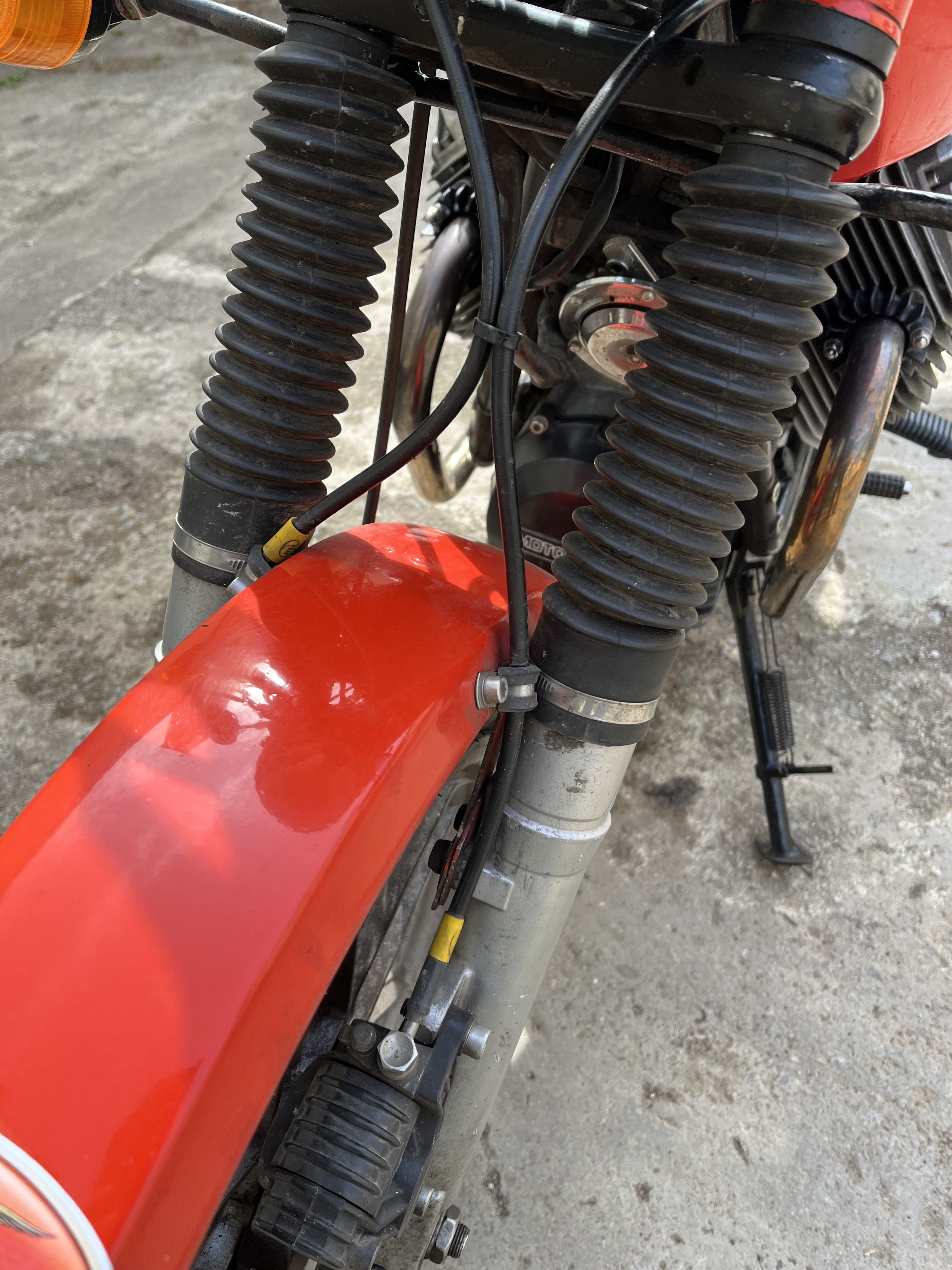

In my case both are under bottom yoke, but both seem to be routed between the tankand frame, on both sides.Anyway, bike in storage, but in my shed for 15+yrs, never had a problem.

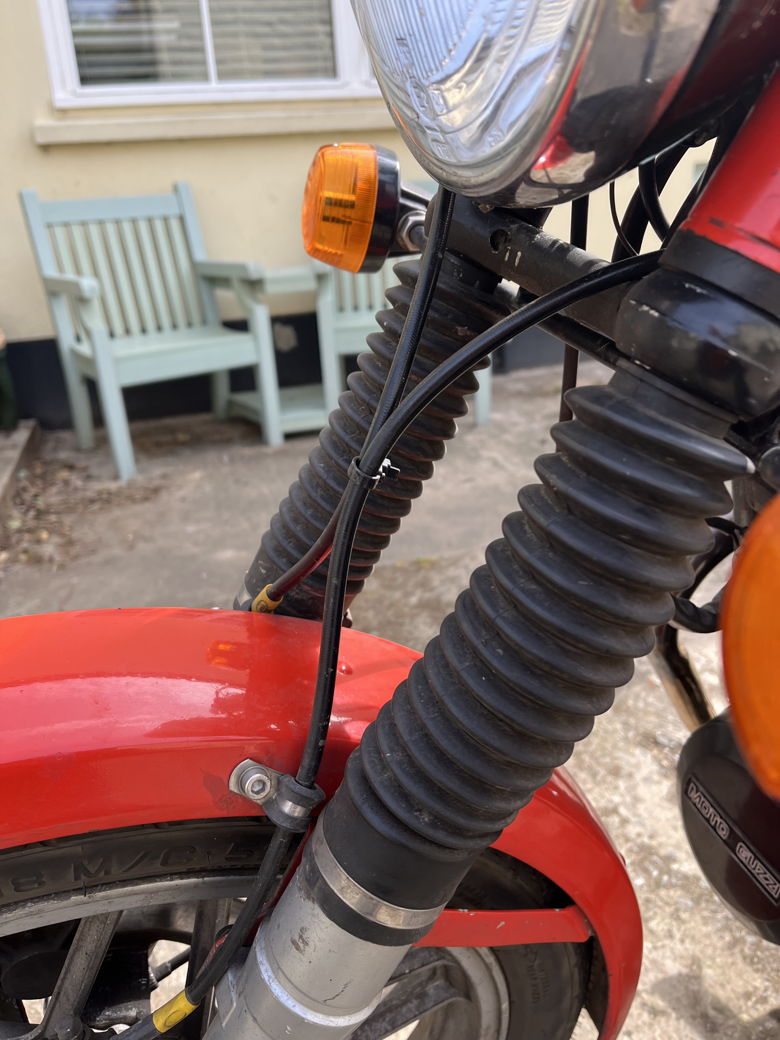

I have mine running over the top of the bottom yoke, the r/h hose to the handlebar-mounted master cylinder and the l/h hose under the tank , along the spine, and down to the splitter valve. This is a non-standard setup, as you will recognise.
