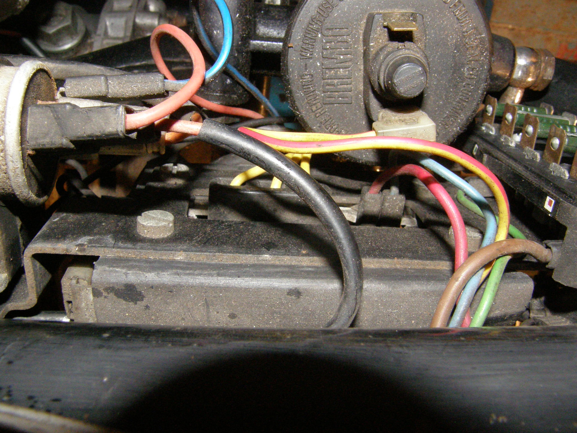

Im a bit confused with the wiring connections in to the front of my regulator.
Ive got the connector with the 3 yellow wires from the alternator but can’t work out the other connections, I think its a series of single wires rather than a multi wire connector.
Could someone with stock wiring take a photo of their for me please?
Thanks
V50 II wiring diagram
Are you sure you mean the regulator? The three yellow wires from the aternator go to the rectifier first. This is assuming it still has the original separate rectifier and regulator and it hasn’t been replaced with a modern combined unit.
Have a read of this article as it explains the system.
This is the wiring to rectifier on my SP1000 with the same charging system.
Sorry, yes. Its the rectifier. I have that wiring diagram but wasn’t sure how the connector positions related to the physical component. They are single wires so its possible to connect them wrong. That photo is helpful though. Thanks
