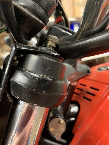

Have attached a pic of my problem which is how do introduce new oil into the forks, I find it difficult to believe I have to remove the speedo cluster and and the light assembly ? their must be another way

UP DATE
This pic says it all
Only the big nut at the top of the stanchion needs to be fully released then depress the suspension which will force the whole internal unit to rise and allow you to fill with oil after first replacing the drain plug :unamused:
