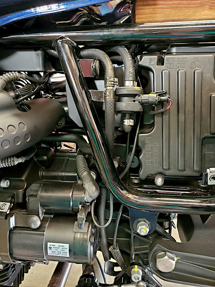

I disabled the EVAP, never happened again. :grinning_face:
Cut and block the hose with the solenoid valve behind front of left side panel. Cut below the valve and leave in situ, I stuffed a M8 bolt up it to block the hose (leave enough length of hose to do it!).
There’s another similar sized hose that does the actual tank venting and goes to the EVAP canister, to get ‘normal’ tank venting to the open air, I just cut a slot in it (sort of half cut through then) just to relieve pressure. I never bothered removing the EVAP canister itself, but I can understand how just leaving it there could get on other people’s nerves.
HTH :grinning_face:
Not my photo but from advrider.com, note hose at front is just cut and left open (tank vent). In this case the lower valve spigot connector has a pipe cap over it.
