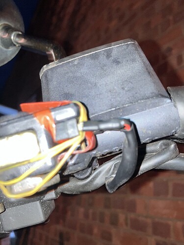

The front brake is a pain in the ass as well - mine failed mot last week because of this item, there’s a micro switch in the brembo lever that operates the circuit - this works on a 5 mm dia X 5 long piece of plastic that pushes on the switch to close it as the lever is released - this then closes the switch and turns the light off … this switch and plastic pusher assembly is held in with 2 off 9 BA screws + nuts - they are like watch makers size ! - mine fell on the gravel floor and became lost for ever - a model supplier has come to the rescue for the nuts and I made an insert from a small piece of 5 mm dia steel bar I have, filing it to the required length - and it must be 5 mm to work - again, sourced nuts via ebay - if I cant get this to work, this hydraulic switch will be purchased and connected in the front RHS circuit by the master cylinder and reservoir …
Brembo charge £ 36 for a service kit - this hydraulic switch and a drop of DOT 4 fluid is a no brainer solution for the front … The hardest bit was fathoming out the problem - but “Mario” probably on a Friday, had wired the brake light circuit to the tail lamp bulb element on one bulb and got it right on the other… I did the normal bit and checked the pins on the bulb for incorrect insertion and it was fine … swopping over the connections sorted it - I know this was from new as the brake light glass has never been off - and they use a self taper to hold it on - its awful design - the threads dont grip on retightening and the light glass drops off and breaks on the first run out … glued it together and drilled a 5 mm hole through the centre and now using a nut and bolt M5 to sort it - the glass can be bought for £ 35 when in stock …

Waiting for nuts … elastic band and tape for now
