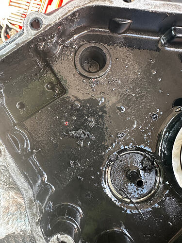

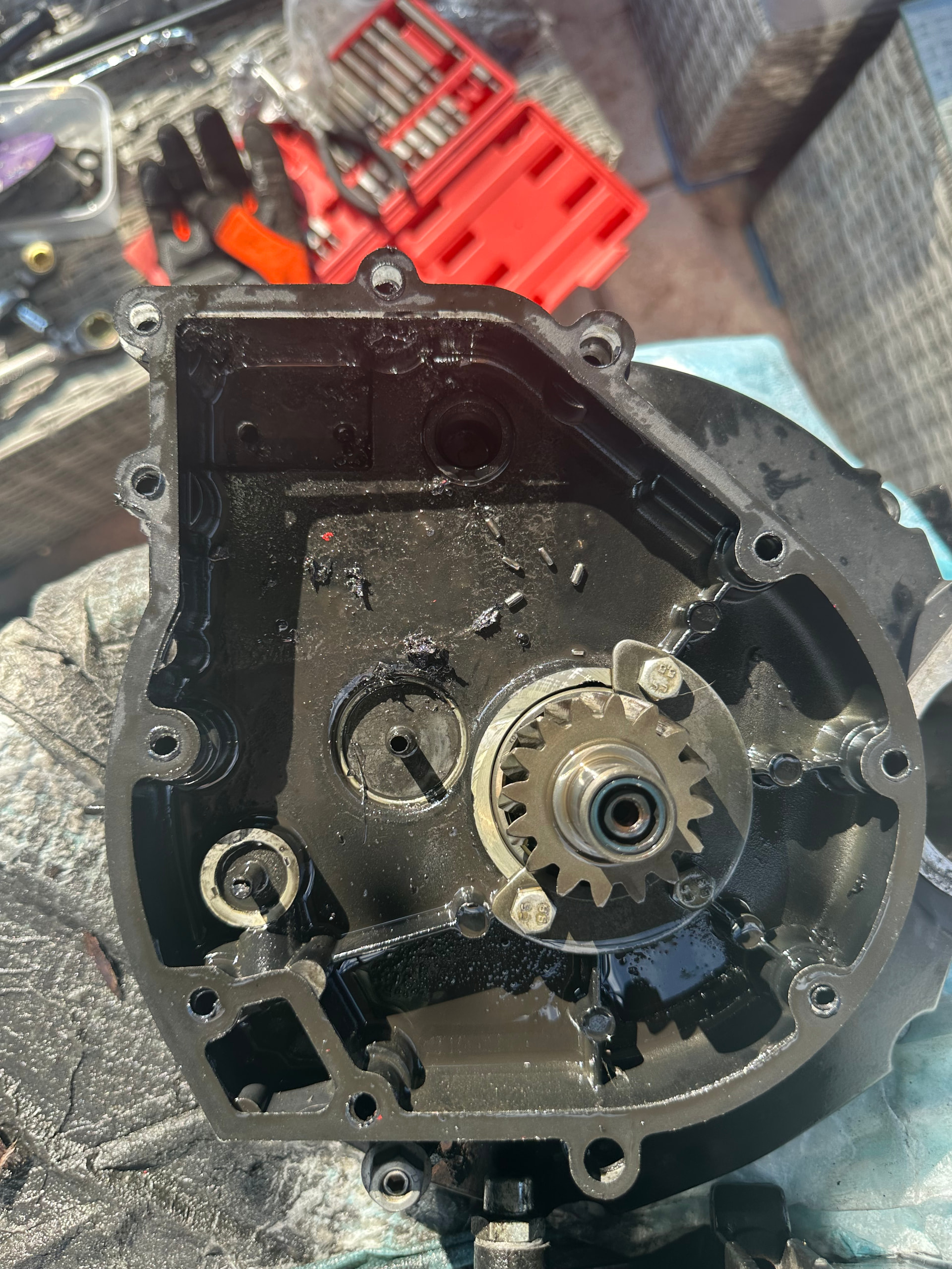

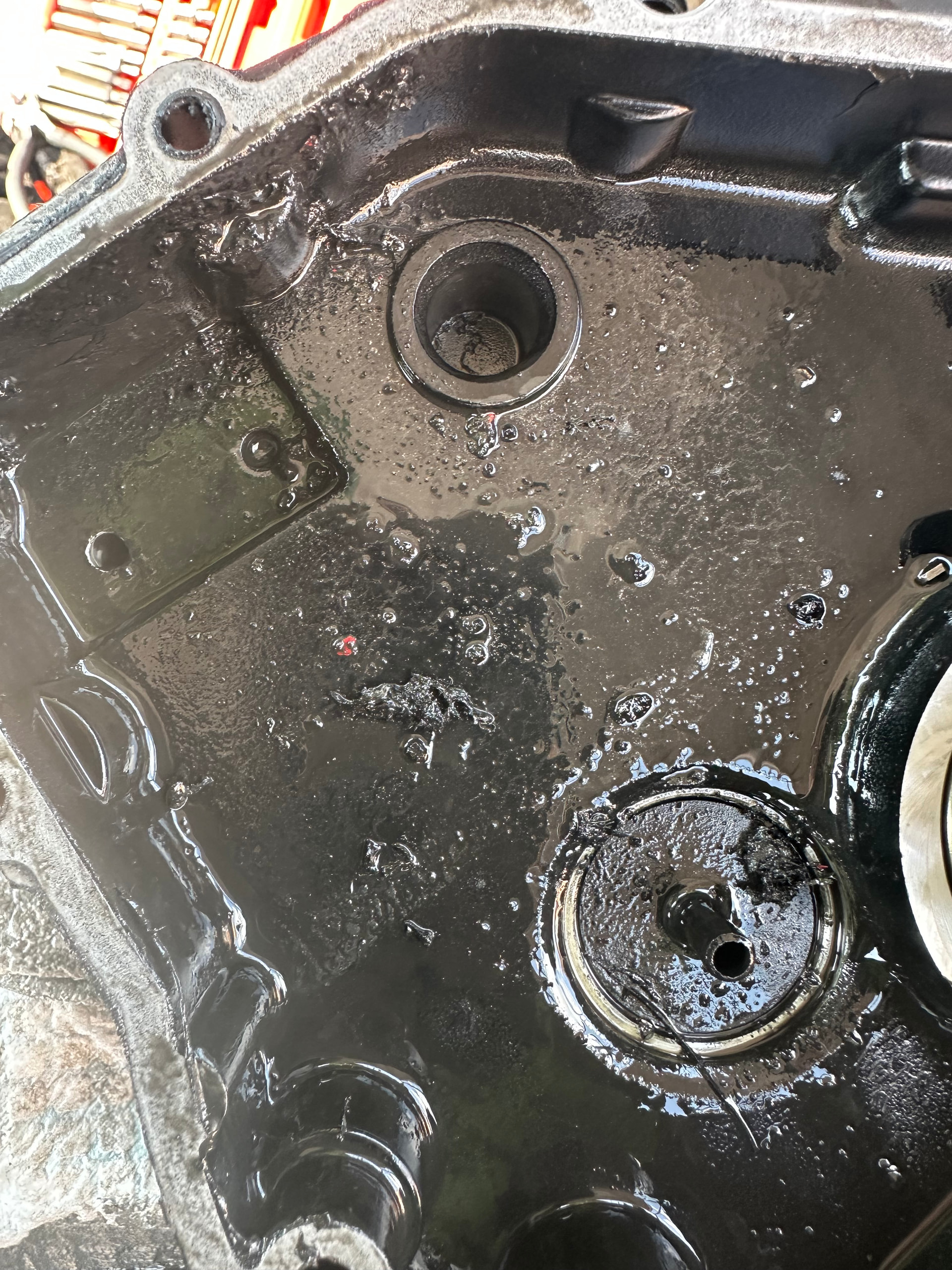

The box has done less than 6000 miles but has decided to eat one of it’s needle roller bearings. I have the gearbox out of the bike but looking at the amount of filings and needles I have found on the input side I have gone no further with the strip down. Also input shaft is notchy and making clicking sounds when turned by hand.

This is what I found when I took the gearbox out
Ooooh, that’s not good. Hopefully the dealer will attend to it.

Thank you everyone for the input. The dealer has now taken the gearbox into their workshop for repair. Not sure that I trust them but I have to give them the chance to sort it out. When I dropped off the gearbox the “mechanic” kept saying that the problems described (grinding noise from the transmission stiff gearchange, impossible to get neutral with the engine running and a machine gun like noise in 5th gear) sounded like clutch drag not a gearbox issue which really fills me with confidence in light of the fact that he had seen the photos of the damage.

There was a certain batch where Guzzi got the machining clearance wrong eventually making gear selection impossible. There’s nothing you can do about it other than fit a good gearbox. You should be able to find out with the engine and frame number I would imagine they did a recall in the US as they’re red hot on warranty claims unlike the UK. If you search Mark Eldridge Moto Guzzi Classics he knows which year was affected, although it sounds like it’s not your problem anymore.
I wouldn’t mind betting that when the dealer dropped the oil out of that gearbox there were some of those rollers on the drain plug magnet, in which case they would have known it wasn’t a clutch issue.
