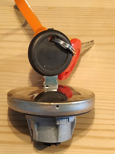

As to venting of the fuel tank, the only thing I have been able to find is a small hole in the rim of the fuel filler cap. Have a look at :
I can both blow air through it, and suck air through it. Are you able to do the same ?
I haven’t found any thing else that seems to offer a vent to the fuel tank.
