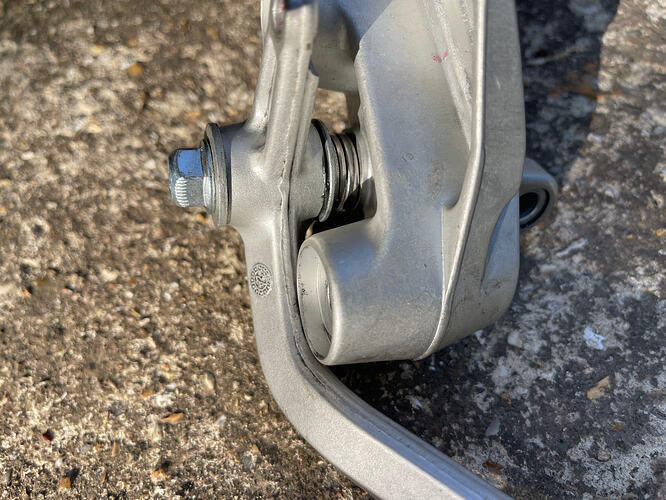

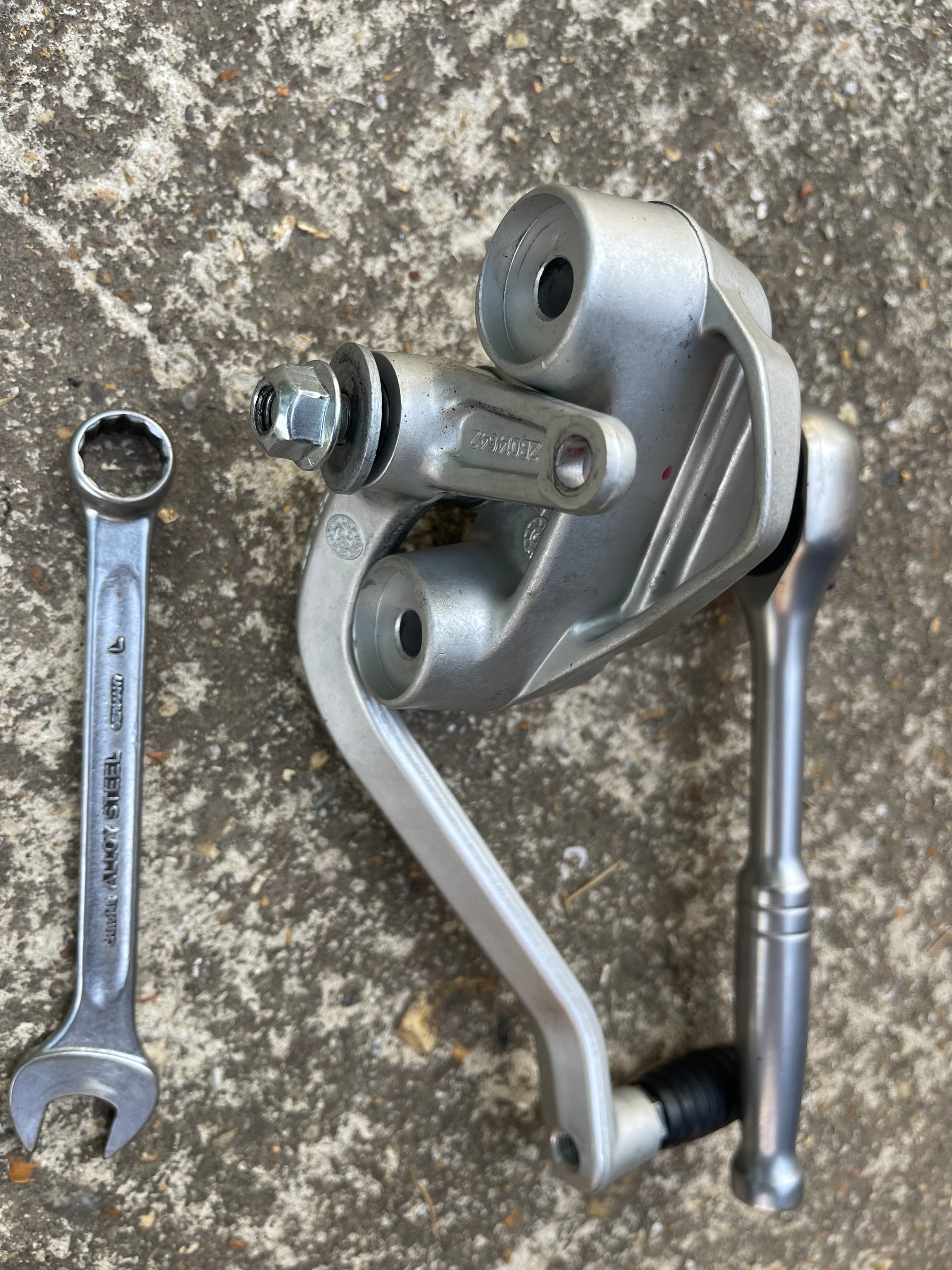

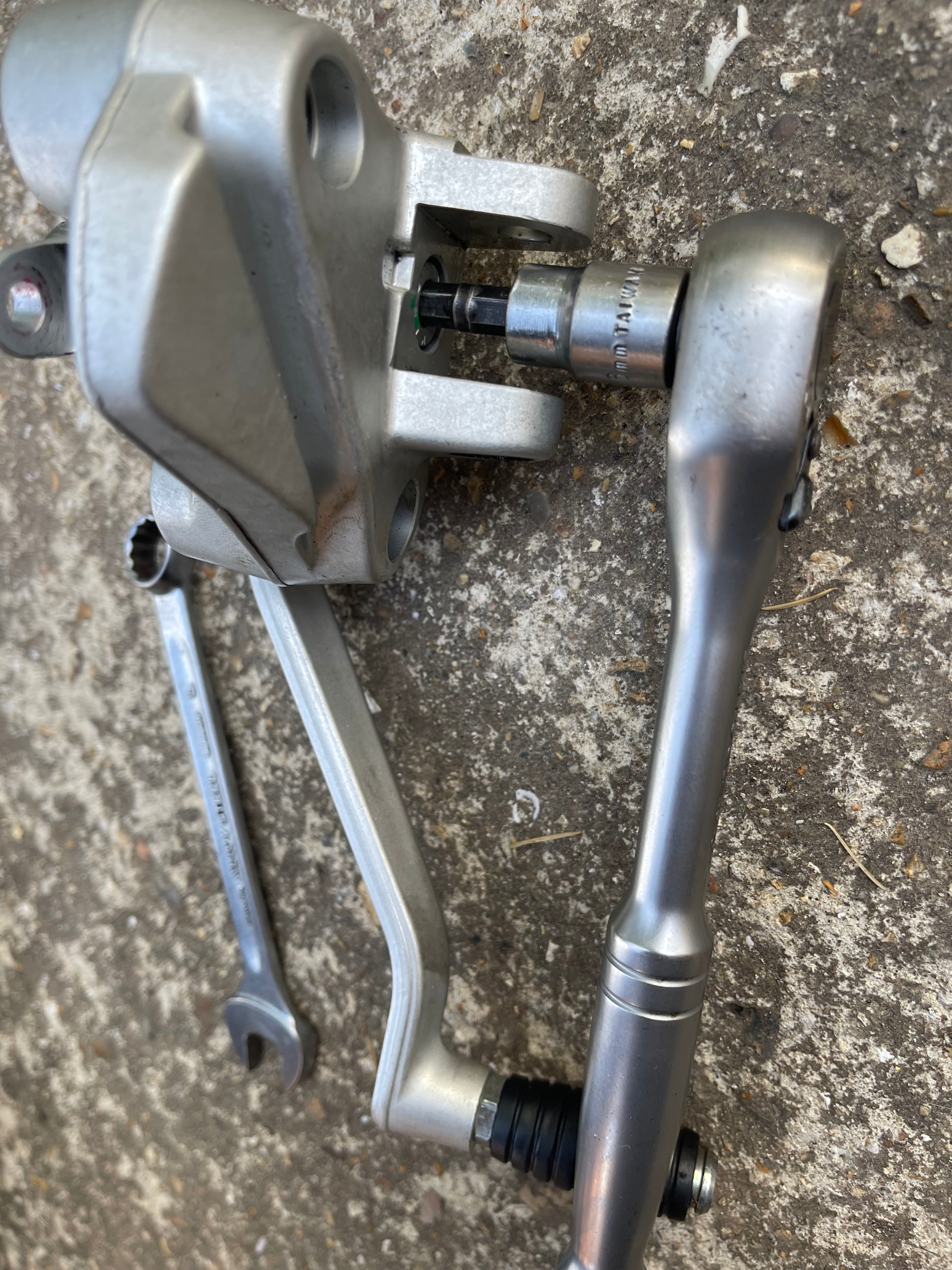

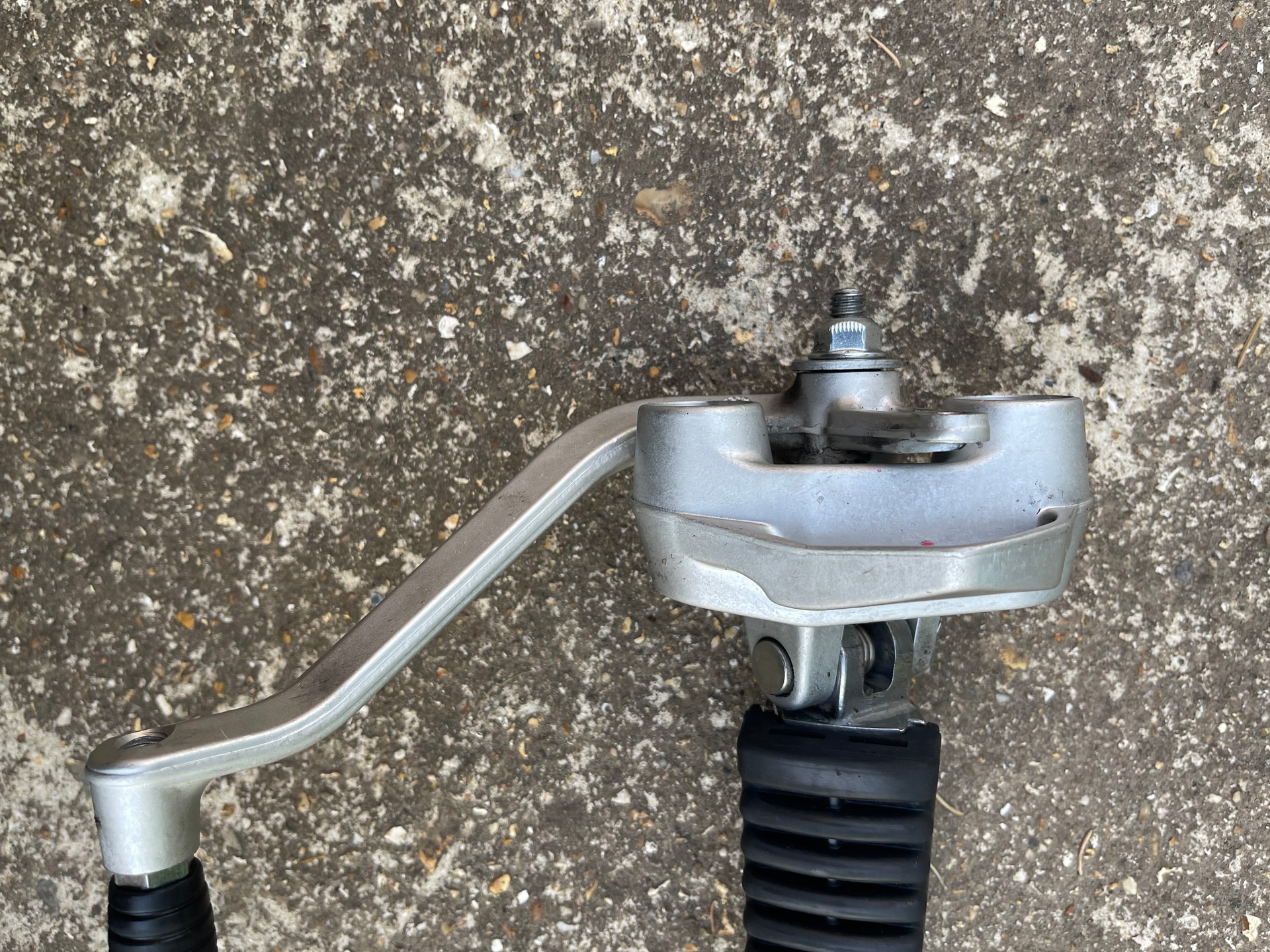

Viewed from above I could see that the short rod link locations were about 8mm out of line. I needed to shim the pedal lever to bring things more inline. This entailed removing the cotter pin to remove the pedal to reveal an 8mm hex socket bolt. The 13mm nut on the other end of this bolt was visible on the inner side of the bike frame and had about 8mm free thread exposed. I removed this entire bolt plus the two other bolts and nuts that fastened the alloy pedal housing to the frame. The whole assembly lifted off the frame (note the two long plastic spacer locators).
My intention was to move the brake pedal towards the frame, thus correcting the misalignment. I fitted stainless washers to achieve this (total thickness 7.24mm), whilst still leaving enough thread on the bolt to grip the self-locking nut.
On reassembly, the pivot points were now almost exactly in line. Voila. The gearshift works perfectly, dead accurate, no vagueness, no missed shifts up or down.

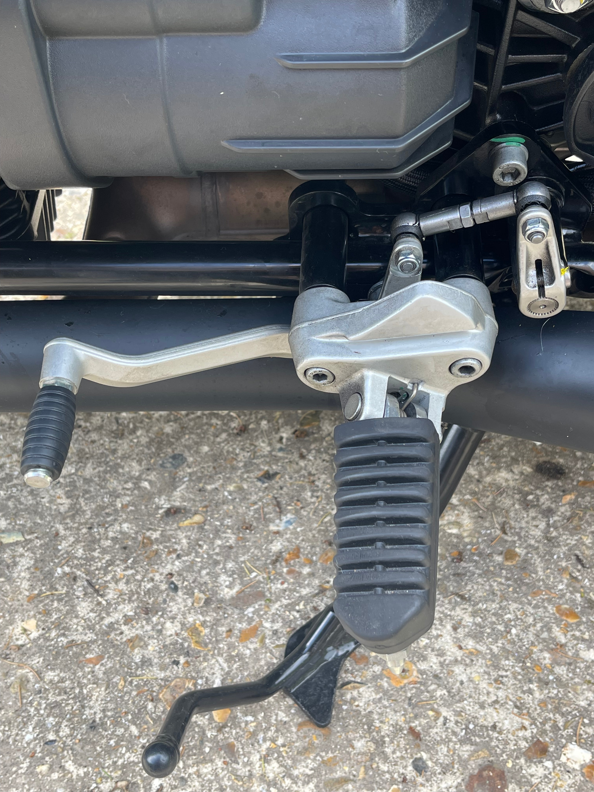

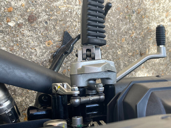

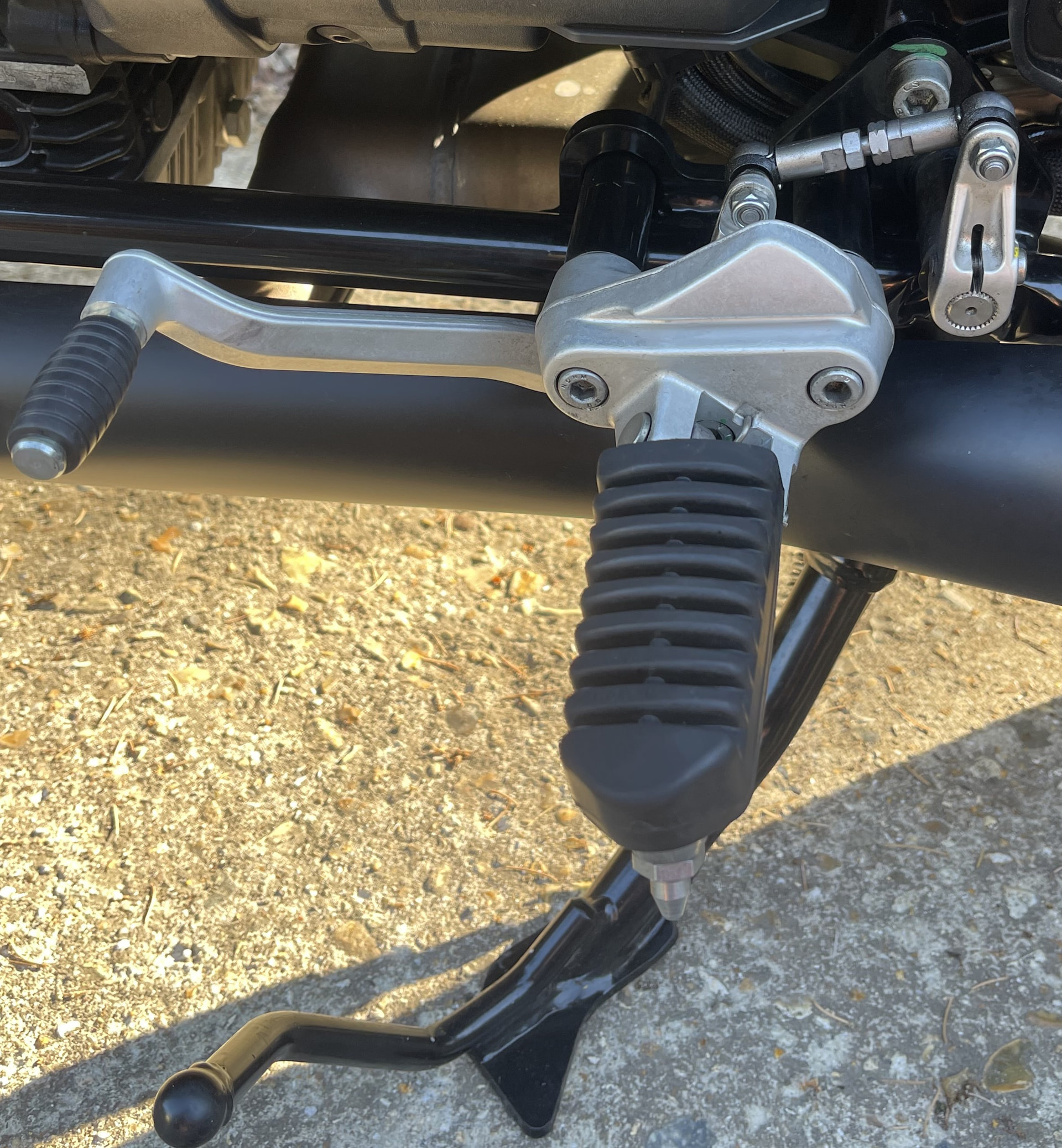

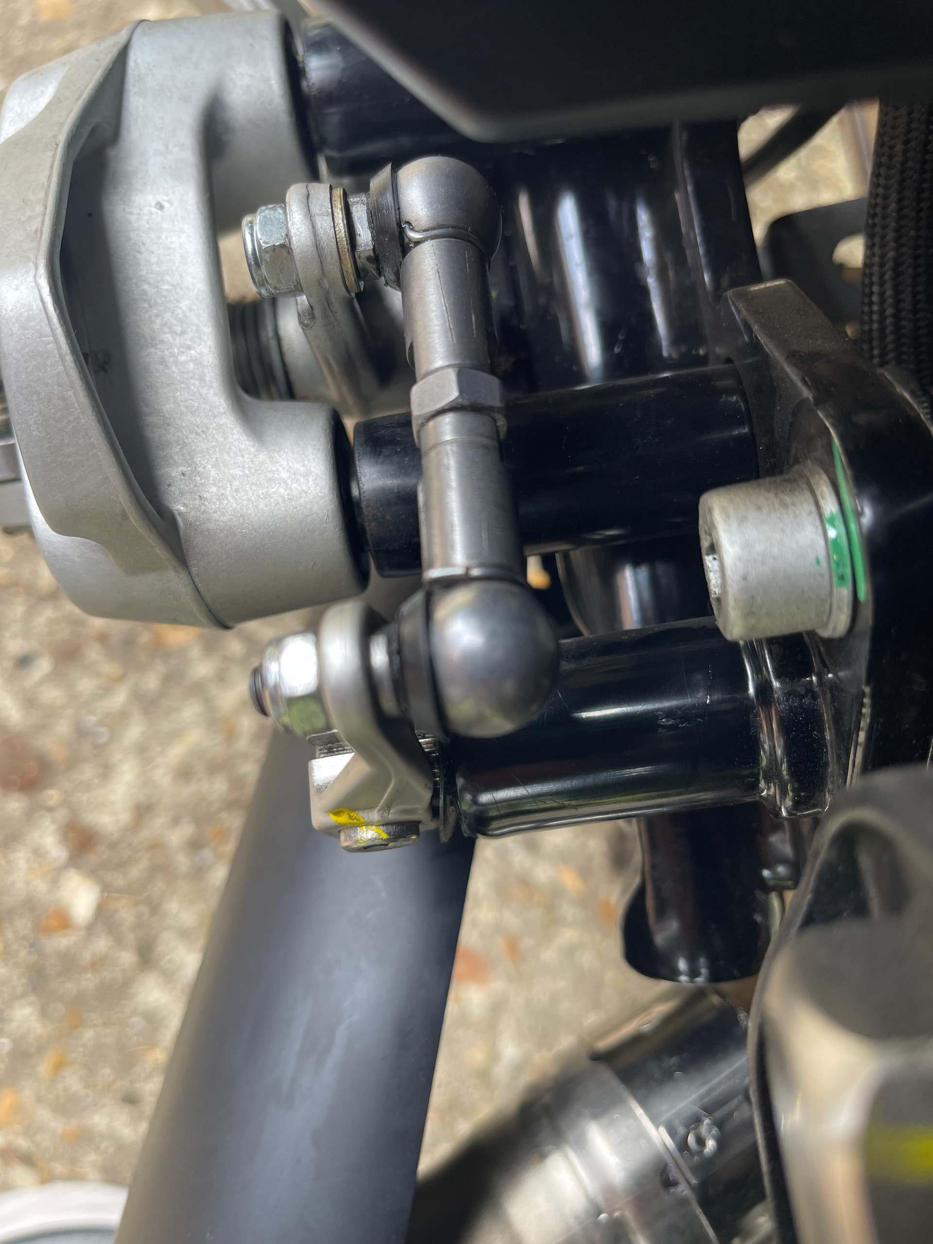

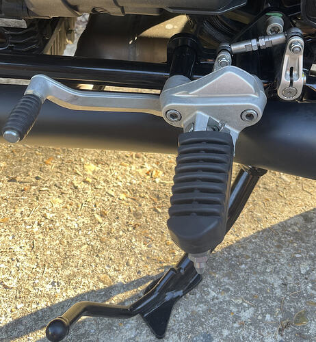

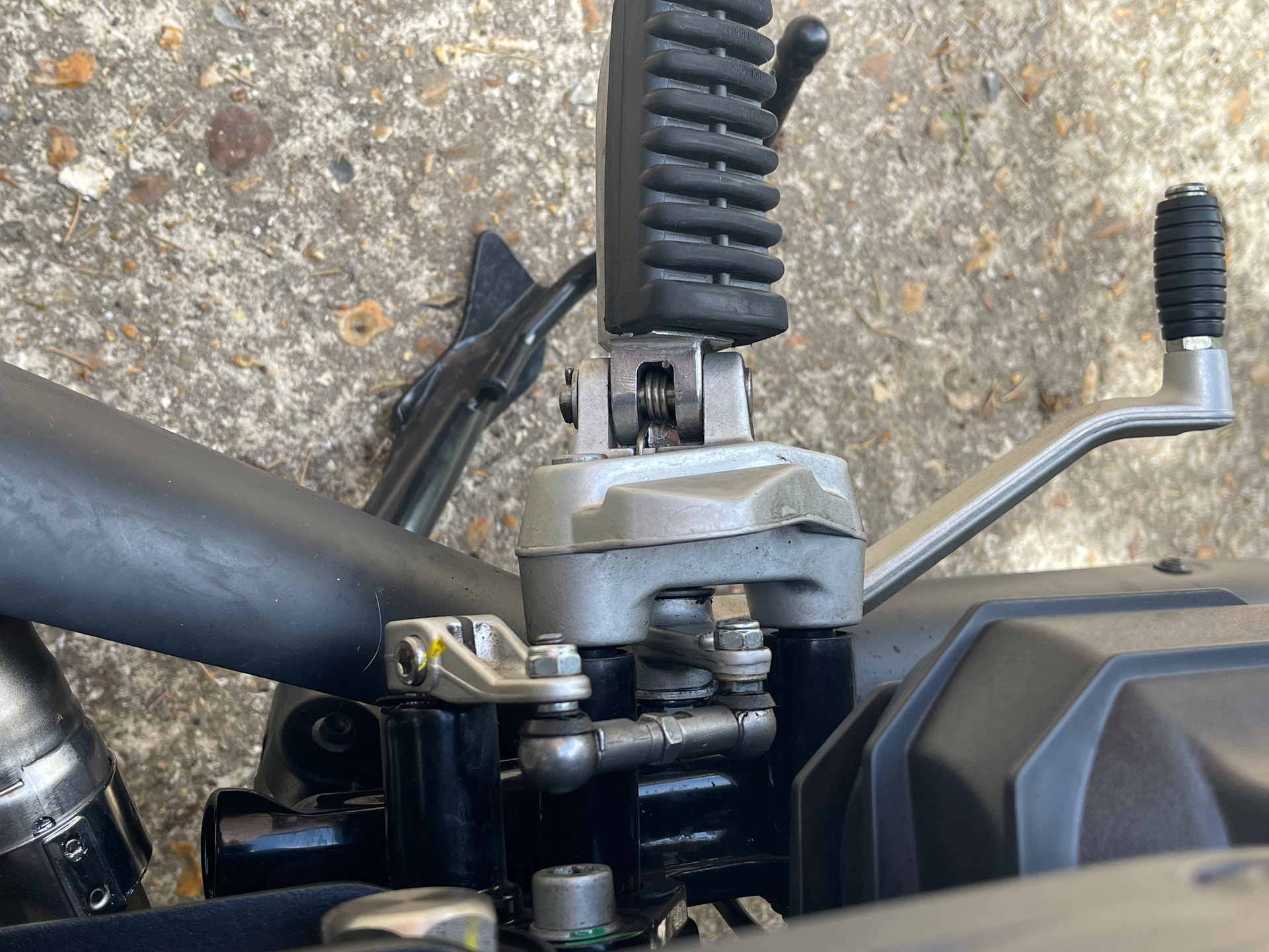

This view shows the improved alignment of the short rod
Th above shows the small washer packing out the front ball joint
Side view, showing the single locknut and higher gearlever position

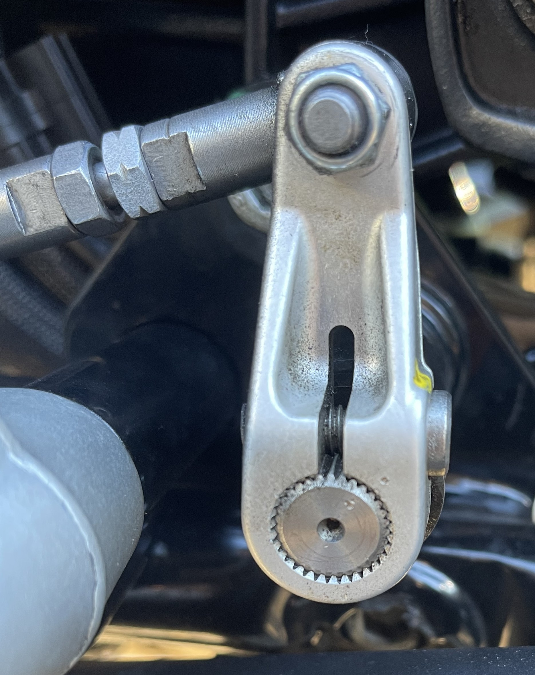

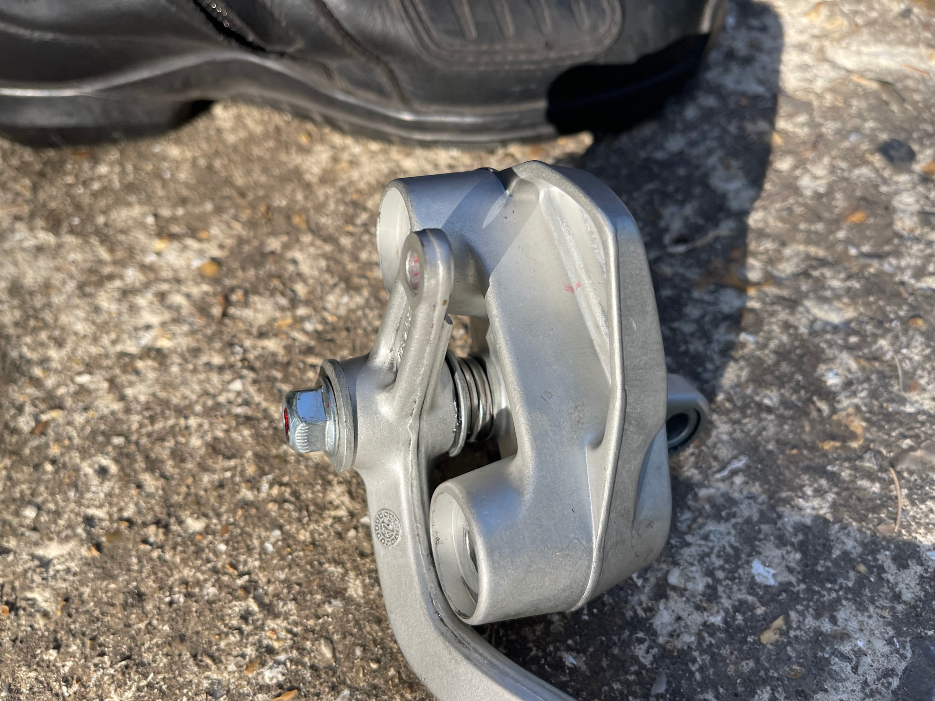

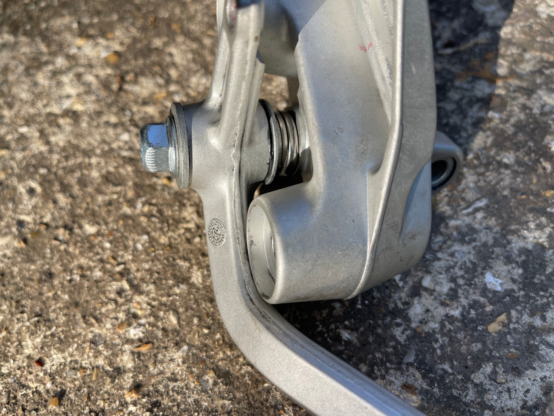

I have made a further improvement by removing the bolt that secures the transfer arm (on the right in the above photo) and indexing it clockwise by one spline. This has enabled me to fit the two original locknuts to the link rod (left & right hand threads), and reduces the chances of the zigzag misalignment, since the rod can be set a bit longer. I’ll post another photo soon, although the difference is subtle.
I wrote a polite letter to factory asking them to revisit this gear linkage arrangement and told them what I had done and why. They acknowledged receiving my letter but have made no other response to date.
Note: centre pop marks show the arm indexed clockwise by one spline
Gear lever in better position for upshifts

What / where are these parts? I have never seen long plastic spacer locators on the brackets.
Sorry for my late reply.
The long conical black plastic spacers are loosely trapped between the complete left pedal housing and the bike frame. You need to remove all three allen screws from the pedal assembly and, as you ease the assembly away from the frame, the black plastic spacers can be found hanging loosely on the back side of the screws.
I was wangling all this stuff from the bike on my own, although I could have done with an extra hand. It was a fiddle holding it all together for reassembly and I did not have the motivation to understand what the function of the spacers was. I just reassembled it how I found it.
