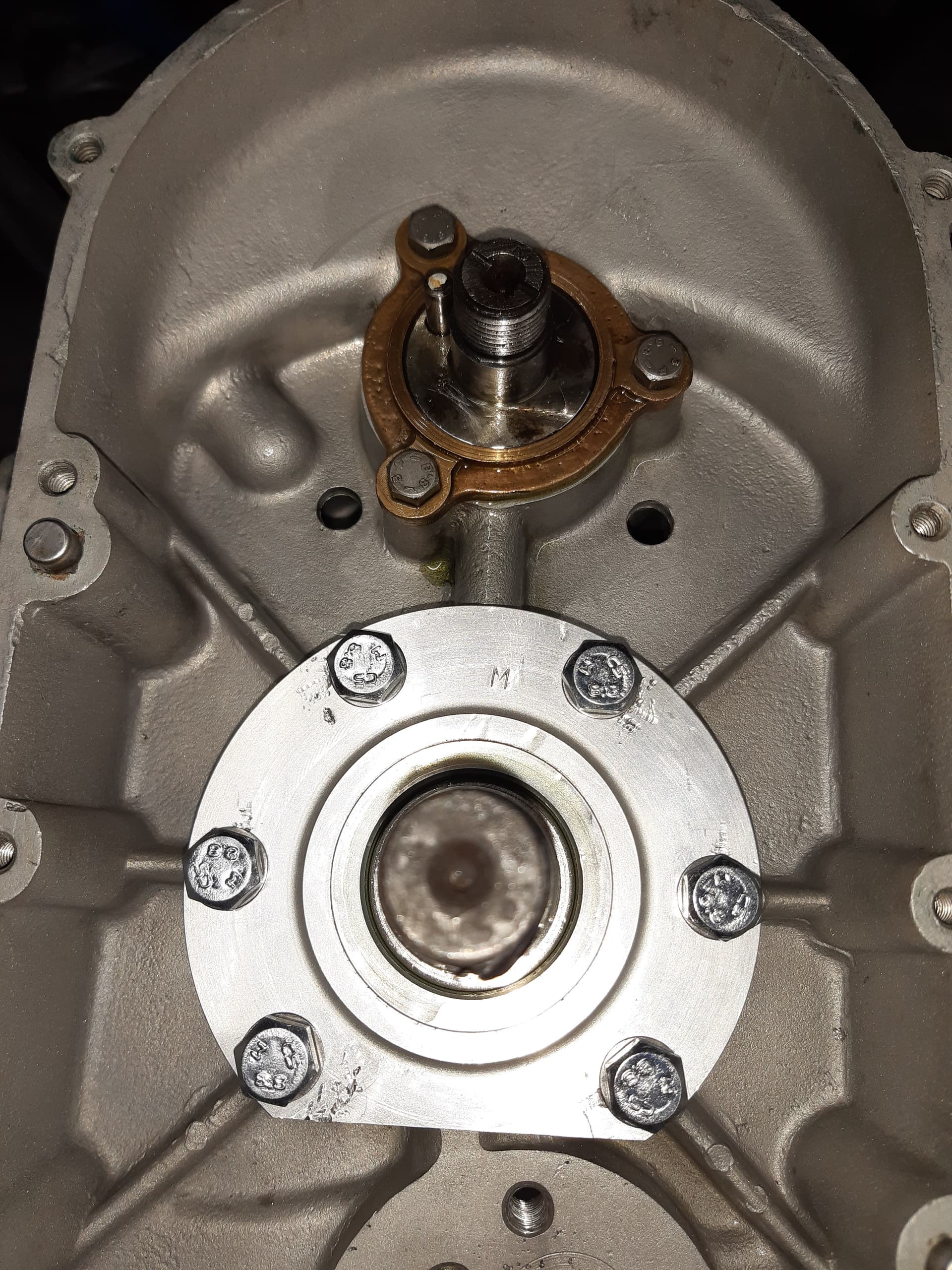

V700 camshaft end float ?
Hi all im busy restoring a v7 700 but struggling to find much information about camshaft end float specifications.
On stripping the motor i found a couple of shims behind the camshaft at the flywheel end but as this is blocked off by the camshaft end plug which is a pressed part i cant imagine it would provide a decent surface to provide thrust.
Ive replaced the camshaft thrust plate under camshaft gear with one thats within tolerance, the rear face of the camshaft gear were tge pin goes has wear around the part that runs on the thrust plate but looking at the helical cut gears and the way the motor runs clockwise it would pull the camshaft forwards . Any help much appreciated or am i worrying too much.
Cheers
