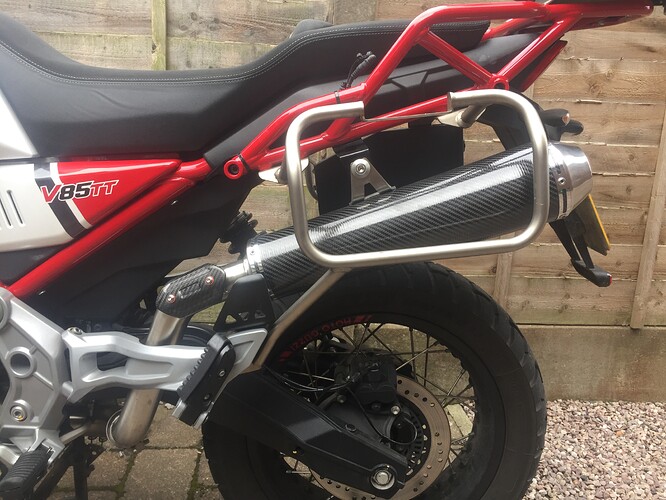

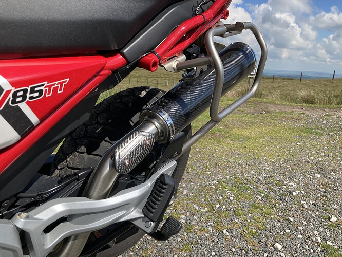

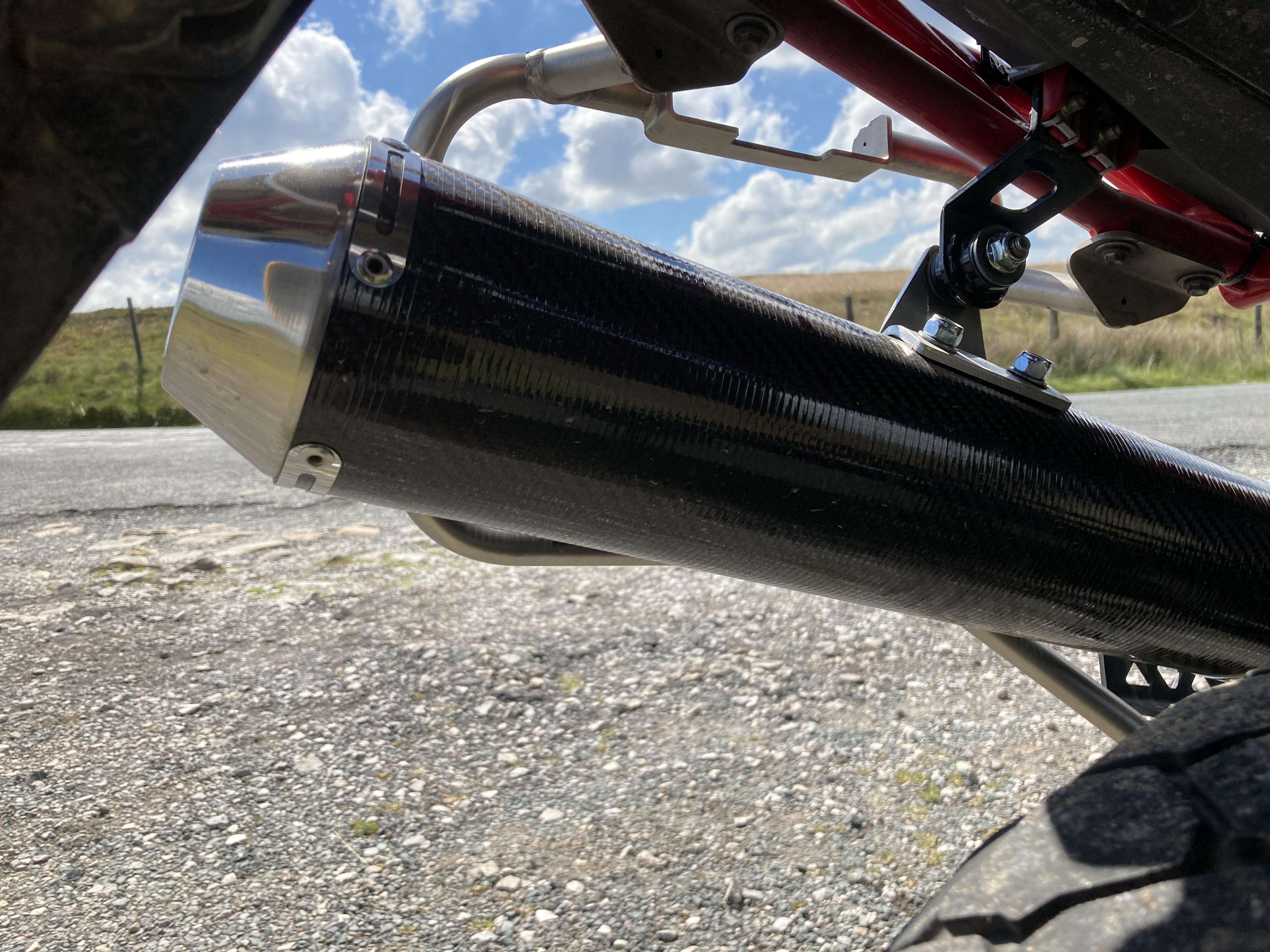

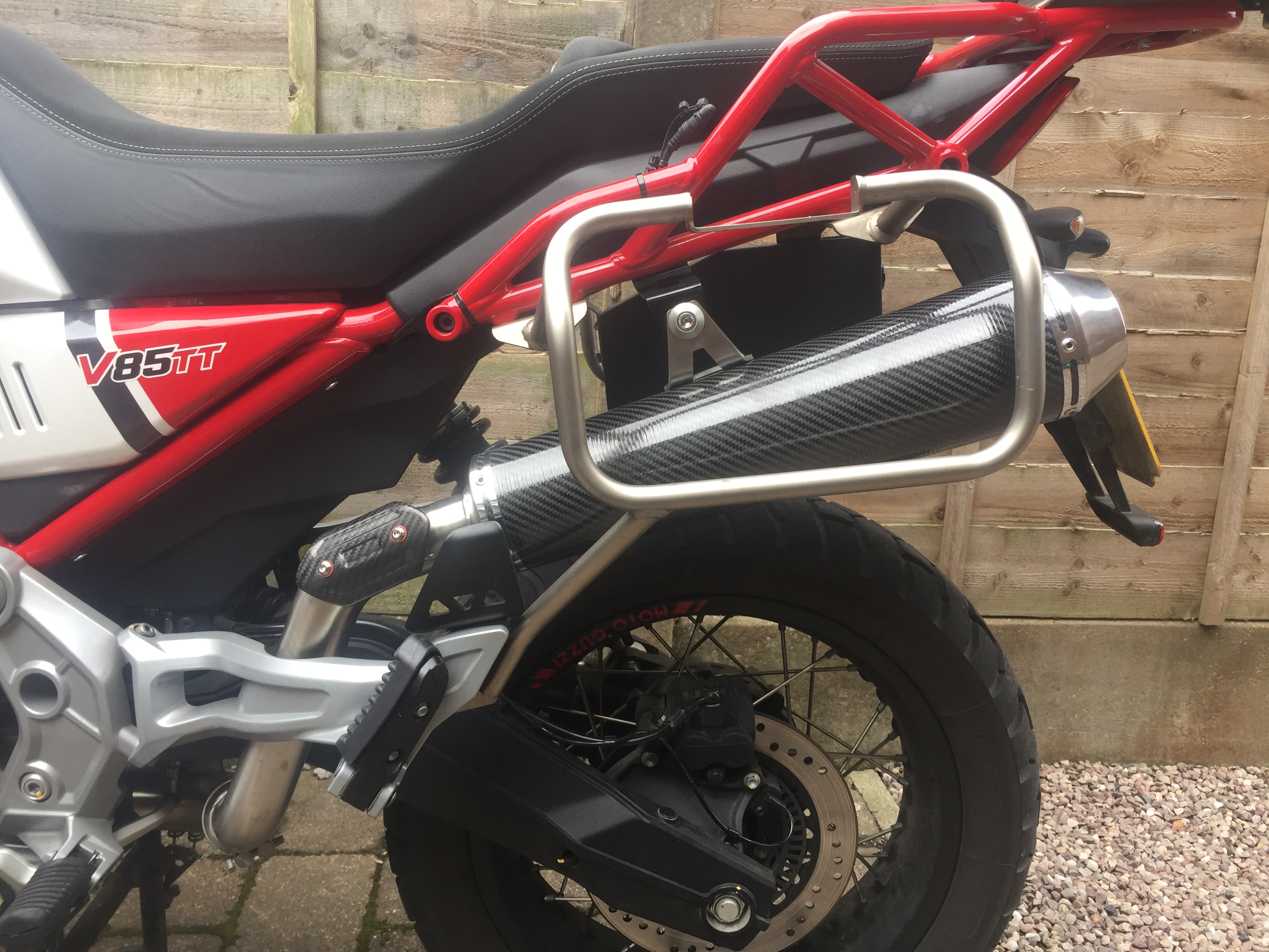

Hi, I’ve got a Mistral Carbon conical silencer that I no longer use. I got it in 2020 to fit my 2019 but it should be ok on later models. I had it on for a couple of years before removing it but it’s in superb condition and beautiful bit of kit.
It’s finished in genuine carbon fibre but I don’t think Mistral do it in that finish anymore. Look up their stainless conical silencer and it’s same as that but finished in black carbon fibre. I’ve some pics somewhere if interested but they’ll be back to when I first fitted it. I’m away from Wednesday (on the bike until mid June so can’t do anything after that. If interested I can post them and dig the unit out of the garage for some currents ones. You’ll need a graphite seal to ensure a close fit to the Catalyst. I paid a lot for this as it was a bit of a special by mistral. Ummm, £400 posted.
A few pics from 2020
