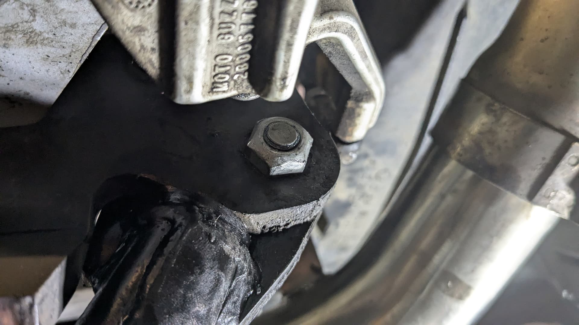

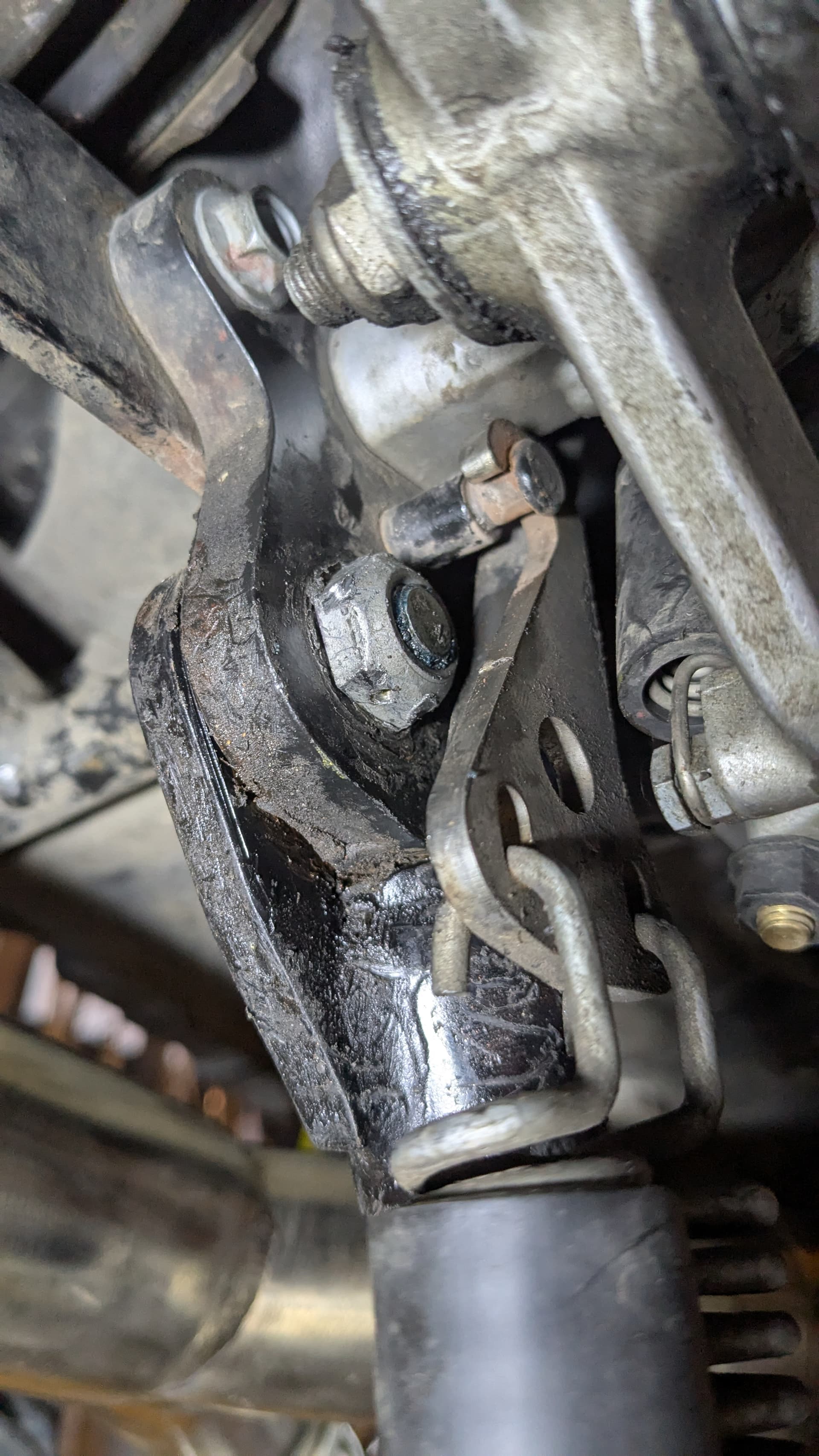

When i checked my centre stand bolts one side was loose and i could see that the bolts were not engaged in the last 2mm of the “stover nut” (where the self locking part is!). Lots of other v85tt owners on the ADV rider site have found the same problem with loose stand bolts and have been discussing solutions. On mine the nuts were 9 & 9.3mm deep, but the exposed bolt end is 7.6-8.0mm.
So i ground the nuts thinner: down to 7.6mm. When i did them up I could now really feel the self locking part of the nuts working
Although the nuts are slim i got them up to 40Nm (30 lbft) using a spring balance on a combination spanner. The factory figure is 50Nm (37 lbft) but as they are now lubricated by loctite 243 the 50Nm would probably be overkill so i am accepting the lower figure.

Sorry its not clean! But as you can see
proper engagement with the self locking nut
