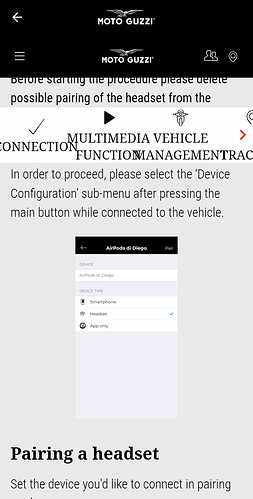

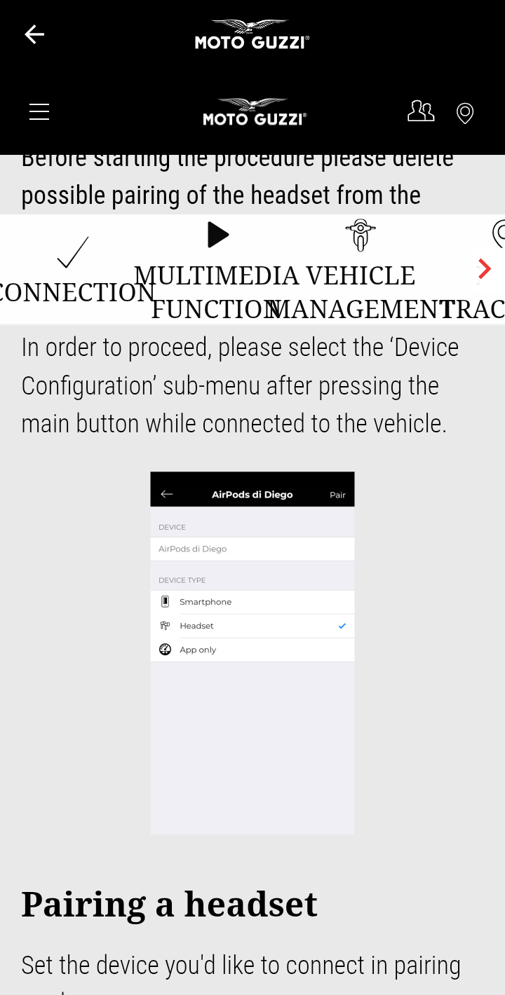

Thanks for all the replies. I took the plunge and ordered a new MIA unit, it arrived today and works a treat. As Squarepants said, the plan was to get the on screen directions without having my phone or a nav unit visible and cluttering up the dash area. Just need to find the right pairing method to add my Sena headset to the Guzzi app now - tried and failed this afternoon, but after delving into the Sena manual it seems there are about 5 different ways to pair it with different bluetooth devices. So that’s a job for tomorrow morning :smiley:
you need to pair it using the app on your phone with the bike switched on and the phone connected with both the phone icon and the data icon ahowing on the screen. then go to the menu in the app to add your headset. you can access the user manual via the app settings too
It was more a Sena issue than the Guzzi app, got there in the end. Using the 3rd of 5 pairing methods on the Sena, it worked.
