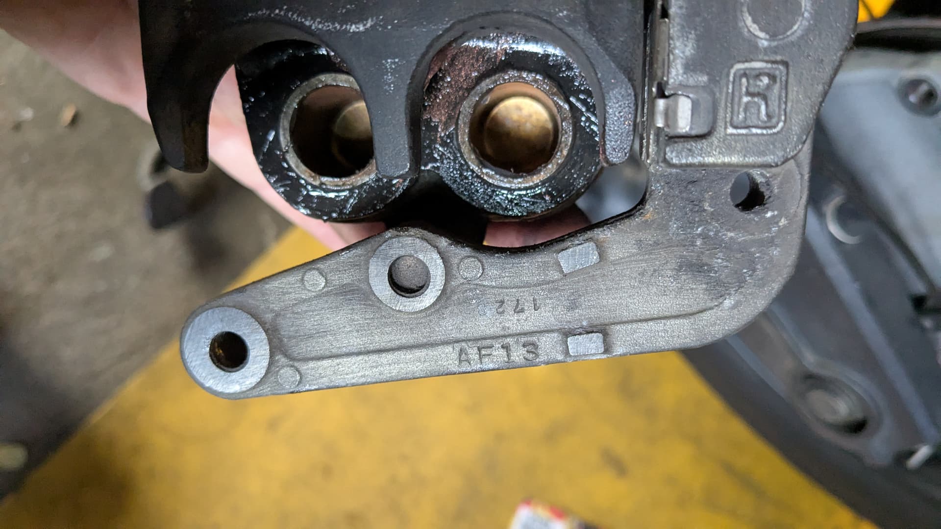

Just checked mine while changing the pads, its a twin piston caliper the pistons are 22.0mm diameter on a vernier caliper.
There is no manufacturers mark that i recognise - see pictures
Also note that the ‘caliper support bracket’ is very very close to the underside of the outside brake pad (on my bike there was a witness mark on the old pad where they rub) this makes it harder than usual to force the pads in against the anti-slop springs.
Not brembo, but Heng Tong, I believe. Can’t see any 22mm rebuild kits from them but almost any 22mm repair kit will do - the seals are not very special or complex . Take the old ones out to measure the thickness to get more information before you order.
Istr that they’re similar to a Suzuki or Yamaha design -i have a note of the caliper pin parts and caliper pin bellows seals somewhere.
