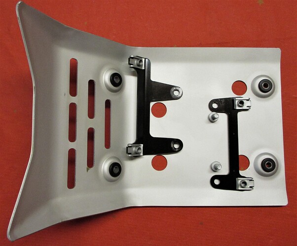

V85TT owners, it’s worth checking your sump guard bolts. While cleaning the bike after a 220 mile ride I noticed that the front of the sump guard was loose. The front two M8 x 16 bolts that secure the black steel bracket to the sump were missing. The remaining two bolts that hold the rear bracket to the sump were barely tight, I could undo them with my fingers. An American owner has also had this problem. Loctite 243 will be applied to these bolts when I have some replacements.
Page 204 in the service manual shows the assembly and torque figures of 20NM for these bolts. I can only assume they weren’t properly tightened at the factory. It hasn’t had its first service yet, this will be carried out on the 13th August.

At least it is held on with 4 bolts! My Stelvio bash plate has fractured from a bolt hole to the edge both sides, so I have removed it to repair, I have been advised that the solution is to add a pair od brackets to bolt it at the back edge, but I think it will stay in my Guzzi broken parts museum…
Funny that, I noticed my bash plate is only held on with the two rear bolts so is flapping about. In for first service tomorrow at SP Exeter so will ask them to fit the bolts.

The loose bolt issue is well known (see the FB Group), but - like most other issues - affects only a few bikes. In comparison, most fixings on mine were so tight that I actually rounded one off!
Especially to undo any of the side bashplate ones, do warm the downpipes up thoroughly before attempting to take them out. Yes, you burn your fingers, but at least you don’t round the screws off. (All mine are now re-fitted with Copper-Ease - no Loctite in sight anywhere! And they’ve happily stayed in place for a few thousand miles…)
In my opinion this was a PDI issue, and some dealers are at fault.
But Guzzi have made it part of the big Recall, so if your bike is affected by that anyway then the problem will be taken care of automatically.
