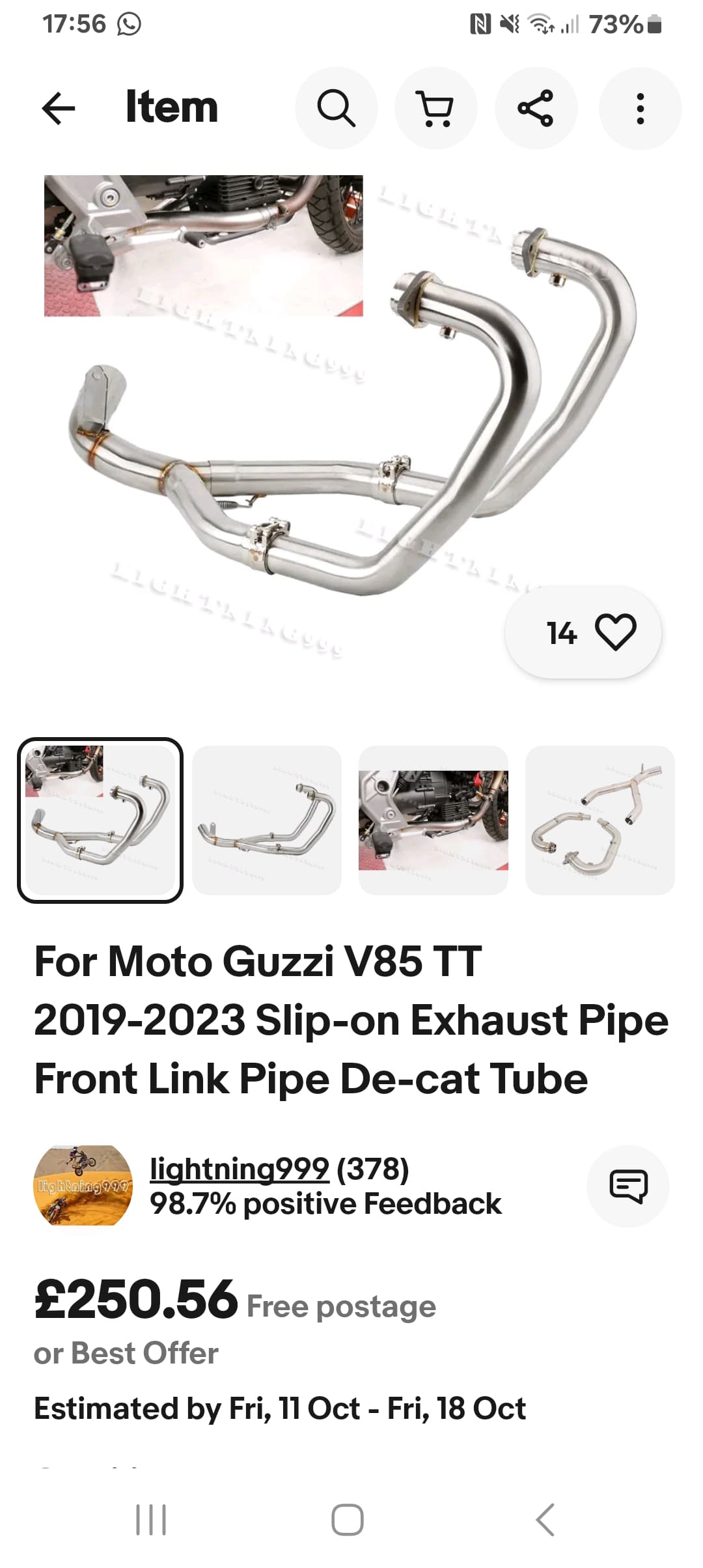

Hi @Temp5848MB. Having just returned from a ride on my 2023 E5 V85tt which is new to me, on a very nice hot and sunny day, I have decided to decat my bike. Much against my principles but due to cost I have decided to go with one sourcedfrom China. I like the look of the one you fitted partly due to the repositioned lamda sensor probes. Would you be able to tell me where they were ordered from, and whether you encountered any problems fitting them, as none of the ones I can find have the sensor probes positioned like your photos show.
Hi i am thinking about selling my decat and storm end can. The pipes fit easily but the mount underneath has no bushing unlike the standard cat. This is easily overcome by making a spacer out off a piece of pipe or nut. I fitted 2 extra clamps on it as i believe they hold the pipes better.It did run a lot cooler with this set up.

This is the one i fitted.
