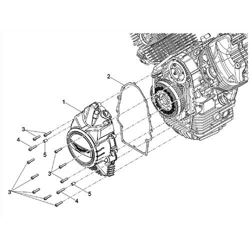

Hi is there any oil behind the alternator cover on the v9 850 only asking as I know it’s got a gasket fitted didn’t want to remove it only to get covered in oil
There’s very little info on line about it hope someone here could help

Looking at this photo, it does suggest there is only one cover on the front of the engine, unlike the older small blocks that had an inner cover over the cam chain and a plastic outer cover over the alternator. So I would say yes there is oil behind the cover
As for battery voltage, I would expect to see around 13.8V when measured across the battery using an old school analogue meter
