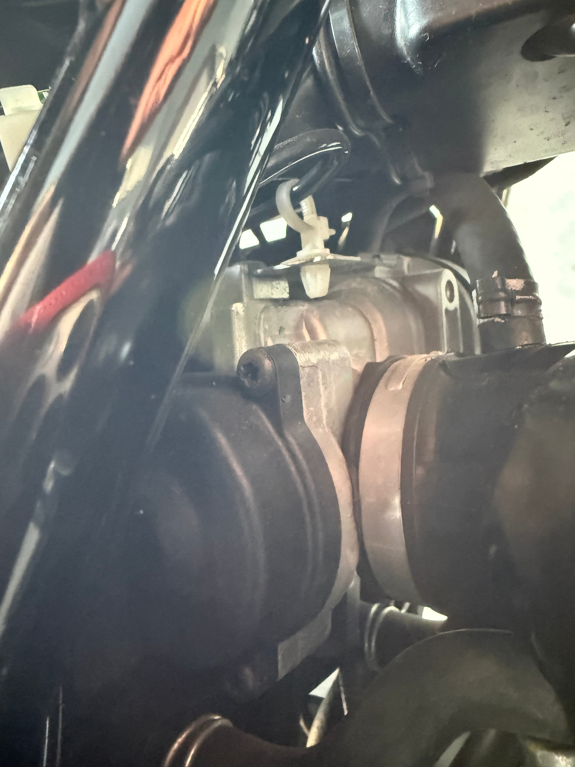

The (TPS) is on the throttle body. It’s easy enough to change if yours is completely gone and you need to get the bike going.
Will need calibrated though as is often the case on cars and bikes.
If/when it stops communicating with the ECU it can stop/stall the bike or stiop it starting by shutting the intake butterfly valve.
Check the wiring first if the bike has been sitting a while
The Roamer uses a traditional mechanical throttle wire as opposed to later fly-by wire which makes things less challenging and more simple
Remove seat and the Roamers side panels and you will see it

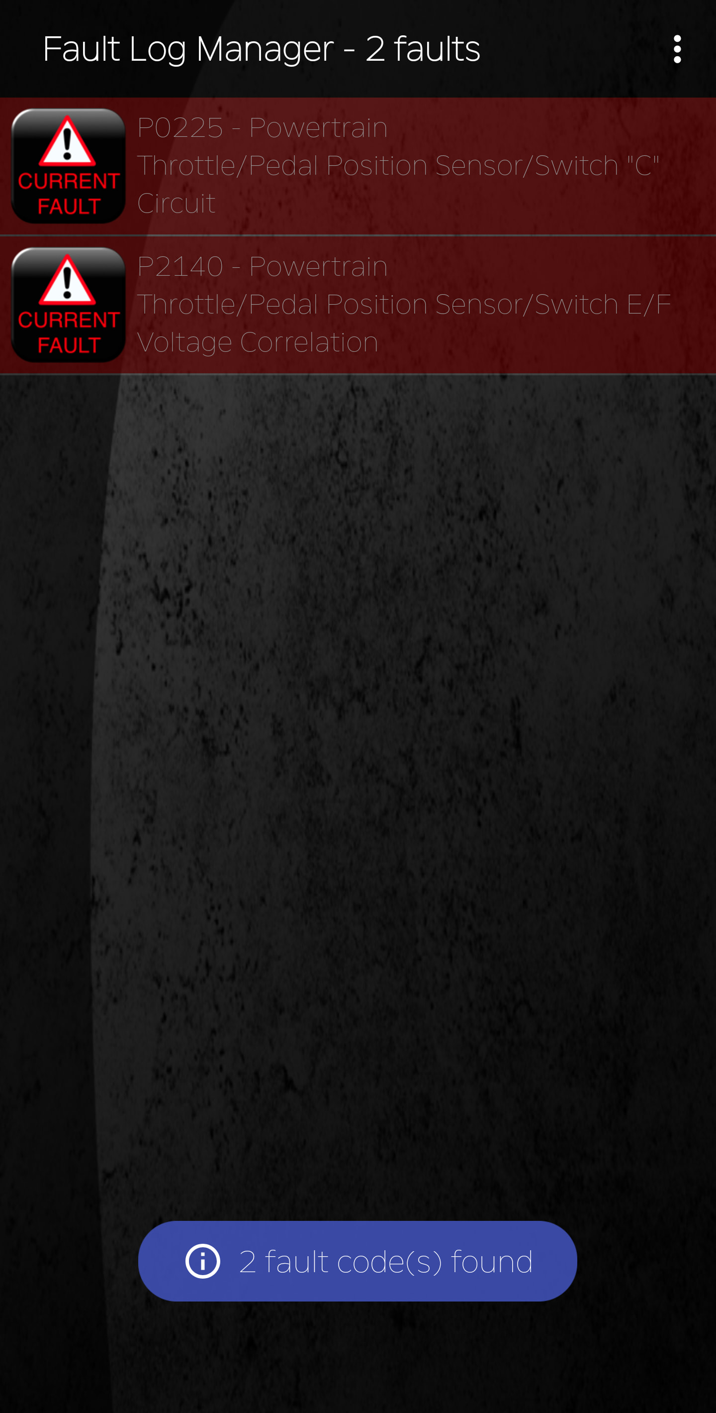

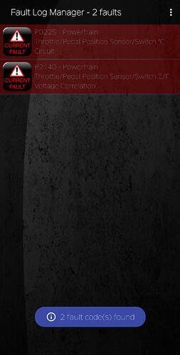

I did this today after changing the throttle grip on v85, not sure if it was this that did the magic needed but all good now (apart from left grip now doesnt warm up).
these were the faults that came up previously.
