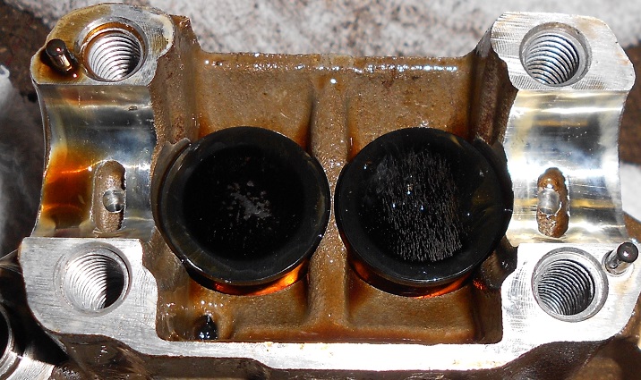

My Tappets were just starting to show signs of the DLC Coating failing, at 28,000 miles.
Had 19,000 on it when I got it, I used Penrite 10 Tenths Racing Oil, has a high ZDDP (Zinc) content, which is supposed to delay the failure.
Who knows, glad I caught it in time.

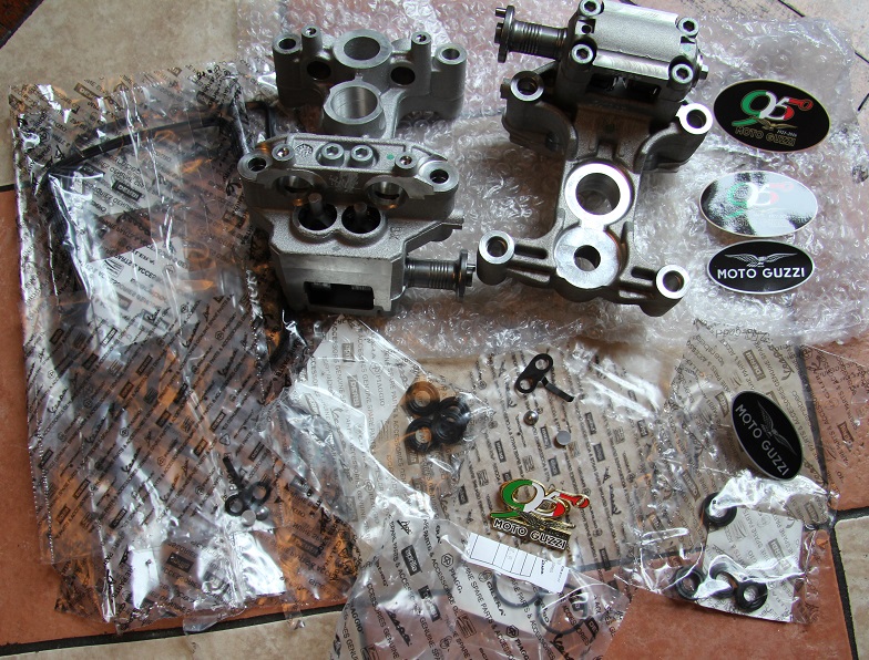

I bought the Roller Kit from Agostinis, I was on a Fly/Rent Bike trip with some friends, Sep 2016.
Cost around €750, fitted it myself.

If you are happy doing mechanical stuff then the job isn’t too bad, the left hand side is easiest to do. The right hand side the cam tensioner is located at base of barrel and requires airbox removing [use to be my worst job - air box].
The kit is comprehensive and mine had 3 thicknesses of head gasket included.

Forgot to mention that I whipped of the left hand head to check the cam and followers as its the easiest side and then ordered the bits to do the job - did re-use the head gasket - tut tut

Sorry for slow reply, I did ride for a while longer, whilst I was waiting for the kit to arrive - just a bit more paranoid
Oh and usual adjust valve clearances check, cam wheel lined up without any issue
