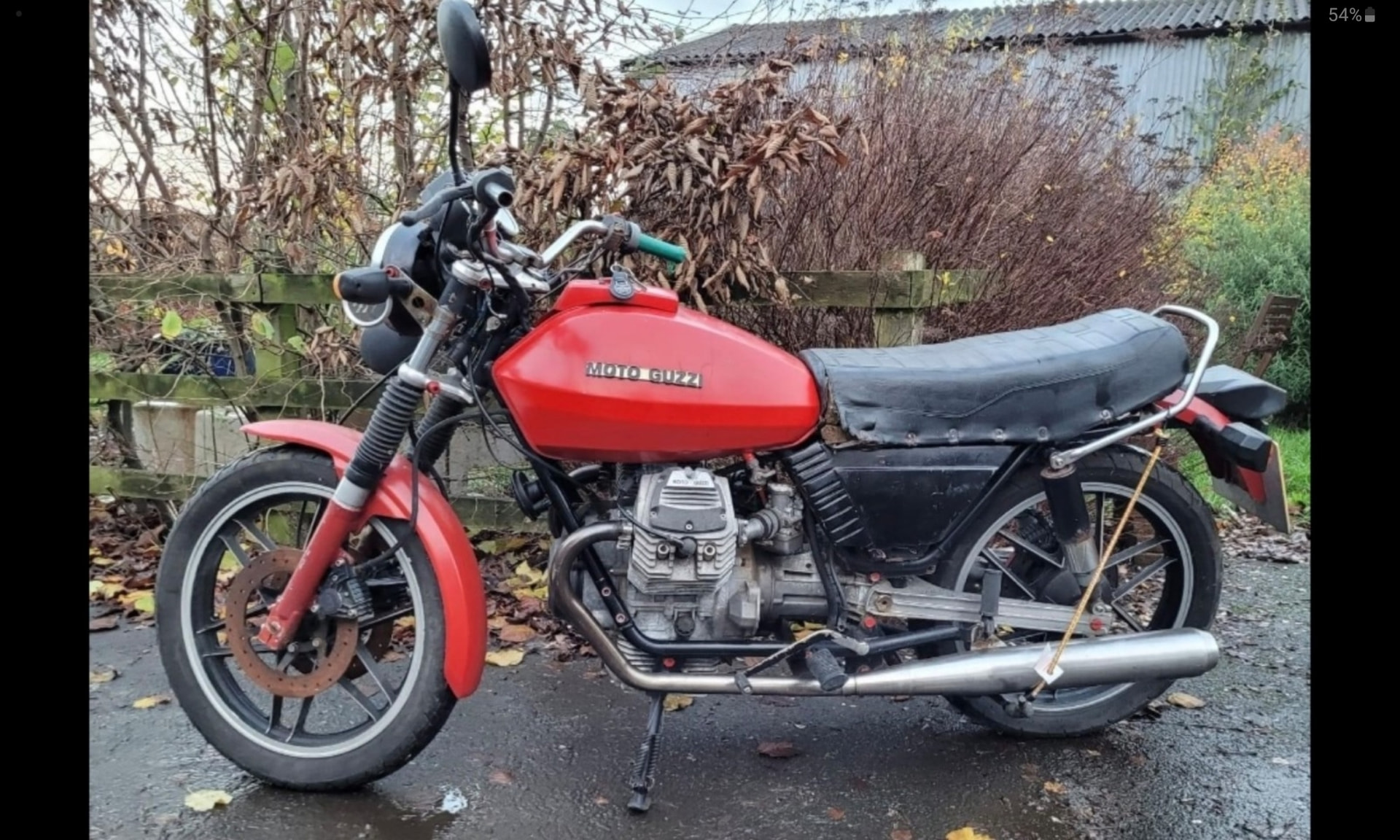

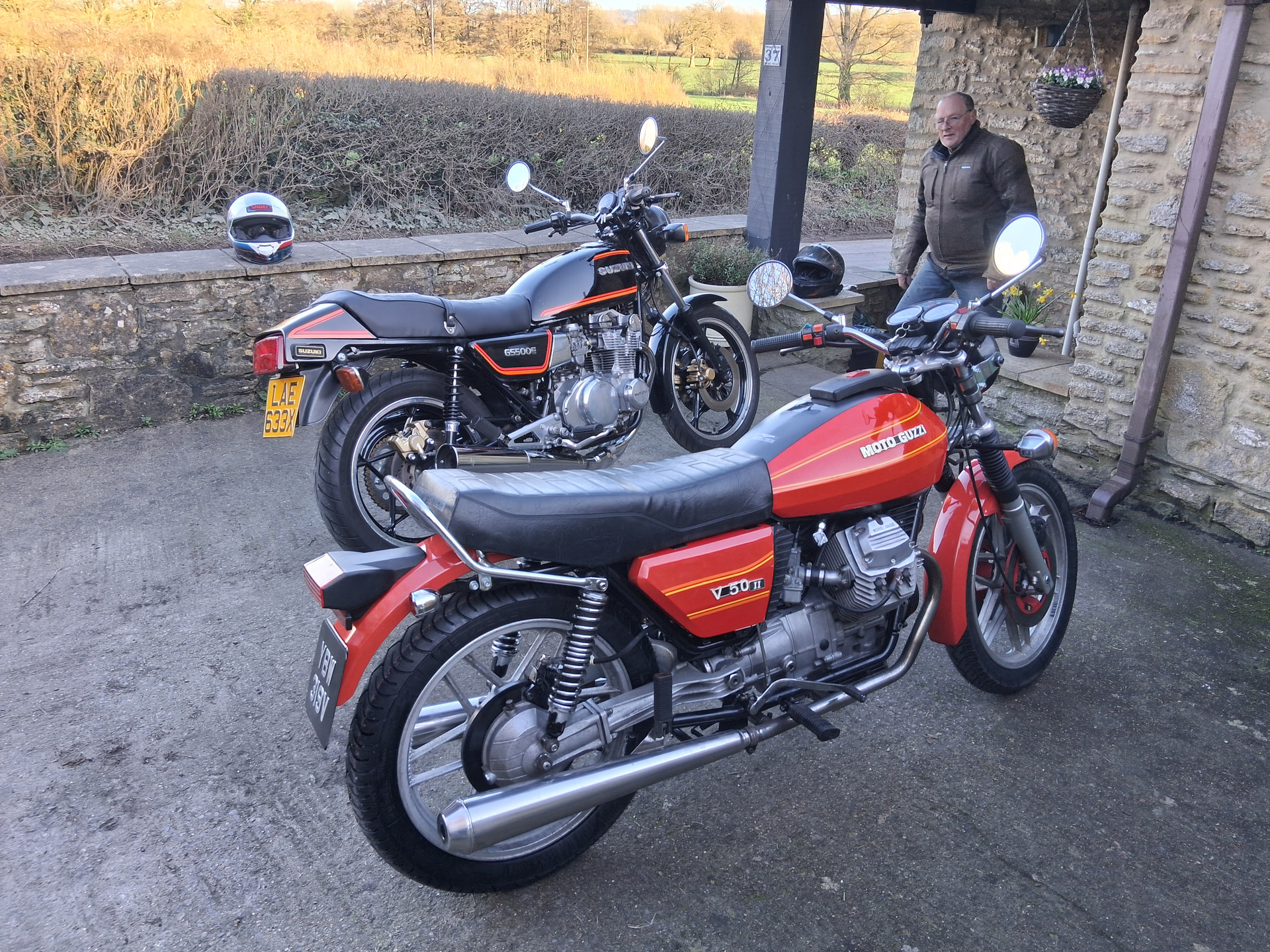

Thanks mate. This is how it was.
Today, I fitted oilite bushes to my V50 frame for the gear and brake pedals. As expected, they closed up a touch when pressed in so I ran a reamer through them and it hit on the gearbox before getting right through so I had to drop the lower frame rails. All done now and pedals fitted. They now have a nice smooth action with no slop at all. Lovely.
I then realised, it now has all the necessary bits to move under its own power so I rode it a whole 5 metres!
Only the tail lights and indicators left to sort and we’re ready to hit the road. I can’t wait. Im so much more excited by this project than my last Suzuki project (rare four cylinder 1982 GS500E)

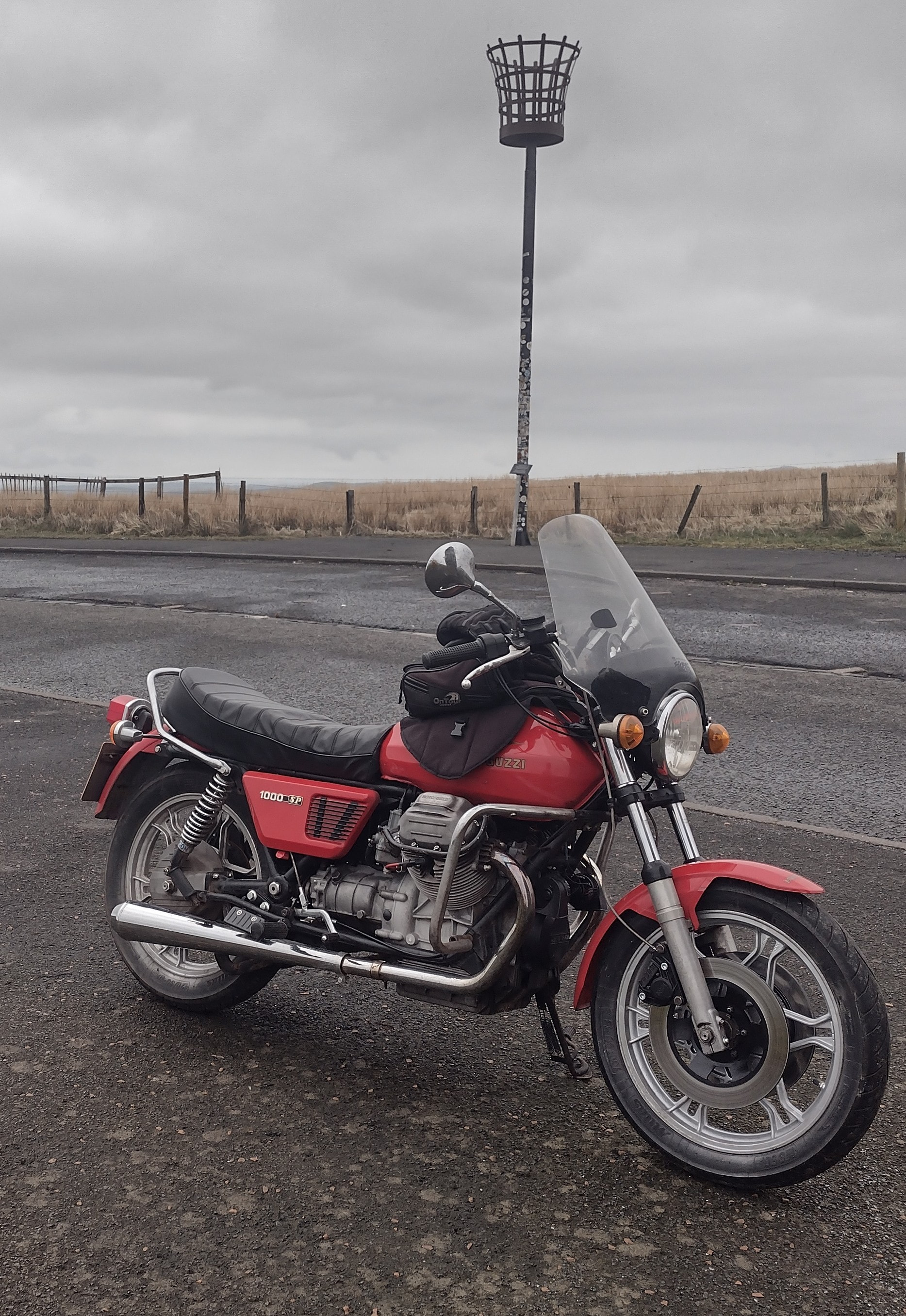

I rode it! First time one this bike and my first time on any Guzzi. What a lovely thing. It’s surprisingly grunty for a little 500 and makes a beautiful noise. I was surprised how smooth it is as well, even at higher revs. My dad came along for the ride on the old GS500.
I assume a bit of a whine from the transmission is normal?

Yes a bit of whine is normal, sometimes just in one or two years.if in all gears keep an eye on bevel box oil.
yes the whine is normal, before I did the decat on the v85 the whine was a bit annoying, now I can’t hear it much because the exhaust isn’t as quiet so it doesn’t bother me.

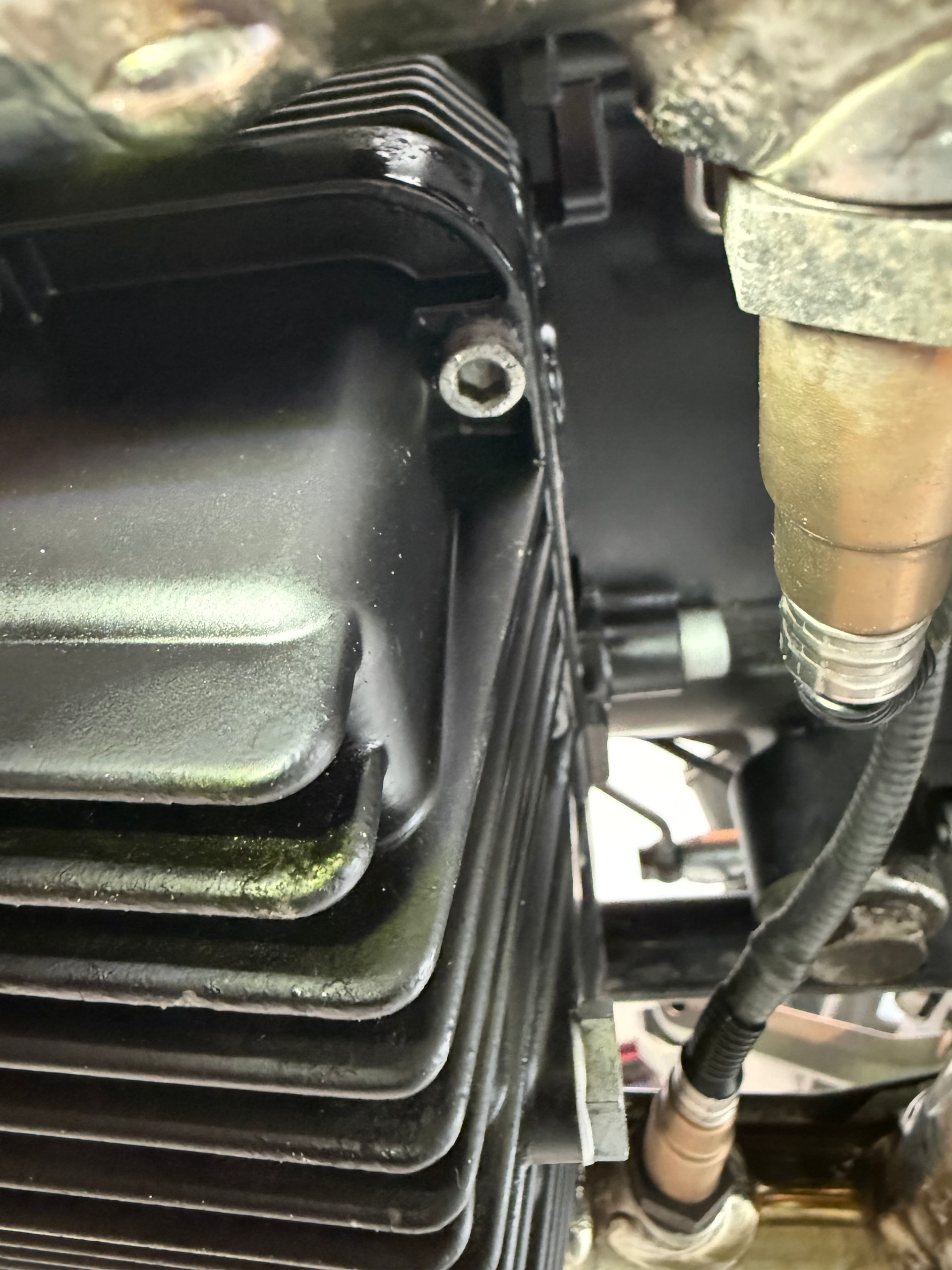

Was doing the gearbox oil on the V9 when I noticed a slight oil seepage on the corner of the engine sump where it mates onto the block.
Put an Allen key on the securing bolts to find that the corner bolt could be unwound by hand :flushed_face:. The other bolts were checked and the two either side needed quarter turns to secure them. Went round them all and the rest were ok.
Luigi must have forget to torque those three down. Cleaned up that area with gunk and after 30 miles re-checked and now totally bone dry.
On the subject of oils - I always do engine oils and filter every 2k miles, gearbox every 4K and rear bevel ever 4K.
The reason I do this regime is
  1. keeps everything in top condition/extends component life.
  2. internal seals such as engine and gearbox main seals can be affected/prematurely fail with contaminated/aged oil/higher mileage oils being left in….sometimes for years on some bikes.
It’s pennies in terms of cost on guzzi’s to do this regime and if you have basic tools( inc a 24mm crowsfeet socket for the tranny drain plug) and can weld a spanner then it’s satisfying to know it’s been done right when you do it yourself :ok_hand:
Perhaps a good idea to carefully check your sump bolts every few thousand miles or if you see any evidence of seepage as it’s an easy job :ok_hand:
