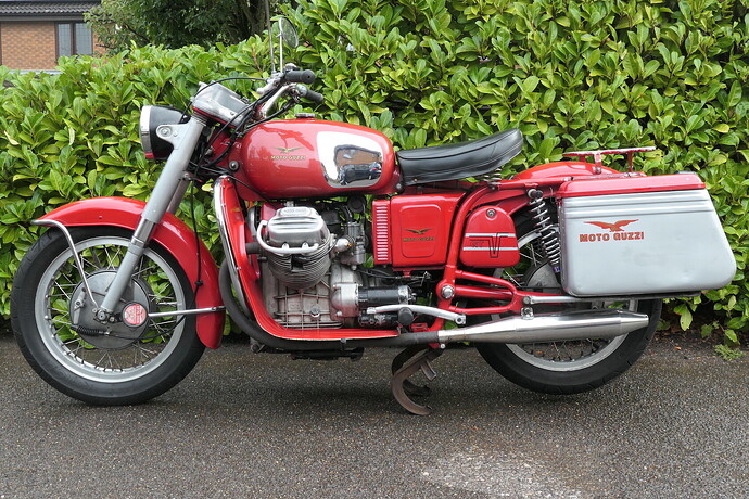

Hi all, I’m a new member living in the Stansted Airport area. I’m new to Guzzis but old (very) when it comes to Velocettes. Anyway, I recently became the proud(-ish) owner of what In think may be a V7 700. When i bought, I was informed that it was a 1973 model originally used somewhere in Europe and brought into the UK in 1995. However, the VIN number is VS69EV, would this mean it could be a 1969 model? Its in full working order, except the odometer. It rides very well and seems to perform nicely to someone who has no idea what to expect from one of these. It has what I understand is called a “loop” frame. Anybody who knows what this well patinated machine actually is is cordially invited to let me know :confused:
When the Covid situation is under some control it would be good to attend a few meetings or gatherings and make contact with fellow members. I would also like to hear from any members who have had experience or even owns one of these (see photos below, possibly) and would care to offer any advice or let me know what a pile of old poo/marvellous rare and historical vehicle (delete as appropriate) I have lurking in the garage.

That bike was on another forum.
It would need someone with a bit of knowledge to look at it properly, but with my limited experience I can see it has a few mismatched bits e.g.
Early-type sidepanels which leave the air cleaner exposed.
GT stickers would only have been used on 850GT only, positioned on sidepanels rather than toolboxes.
Not necessarily a problem as plenty of people mix-and-match bits.

It turns out my bike is, as recently confirmed by Piaggio is a V7 700 manufactured in 1973 for the Italian police in Rome. The original colour, as confirmed by the inside of the battery covers and other bits, is similar to an RAF blue. It was first registered in the UK in November 1995 and apart from the rather poor paint job appears to be largely original apart from removal of the police equipment it would have been kitted out with. It starts, runs and rides OK, or at least it seems that way to me although there is rather more vibration that I had expected. Its nothing like as bad as the British vertical twins I’ve experienced and isn’t uncomfortable at any speed up to normal motorway speeds.
