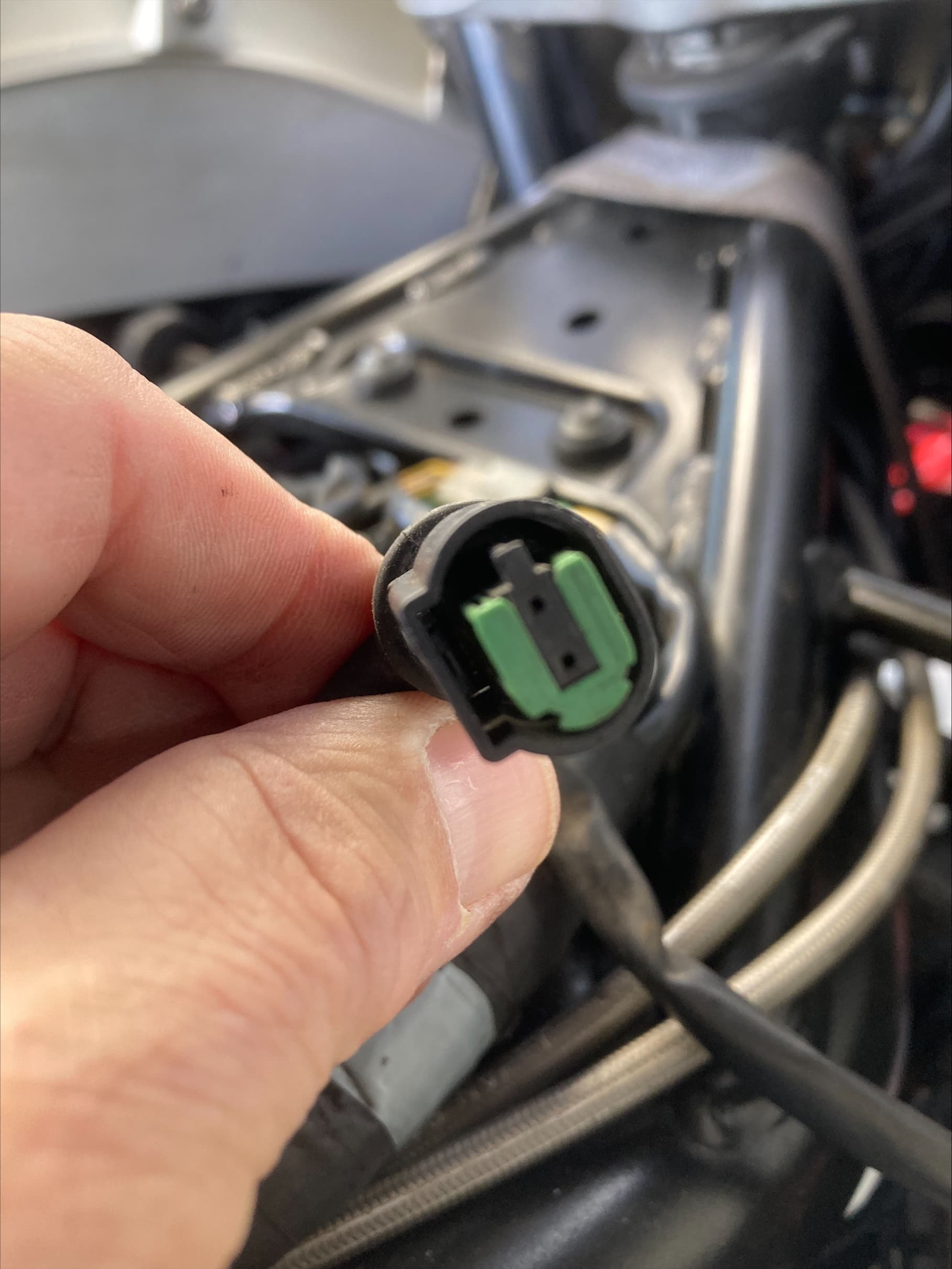

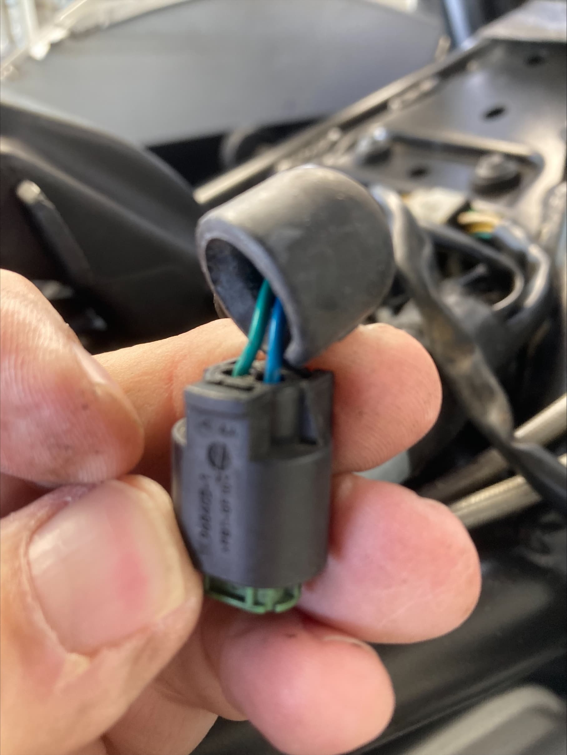

Where does this go please?
Sorry about all the questions guys. I have looked in the manual and can’t see where this goes, does anyone have any idea please?
What bike do you have?
Hi Westie, I assume you are talking about the Norge. That connector is for the TomTom GPS unit. Unfortunately it fits the TomTom Rider 400, which is obsolete and longer supported by TomTom. I cut the connector off and fitted a Superseal connector. I then fitted the other half of the connector to the TomTom fly lead for the later TomTom 550 which is still supported. Hope this helps, Phil

Yes it is 2014 Norge. Thanks for the help, I was just about to take the air filter back out to see where it came from, you guys saved me a whole load of work. Thanks.
