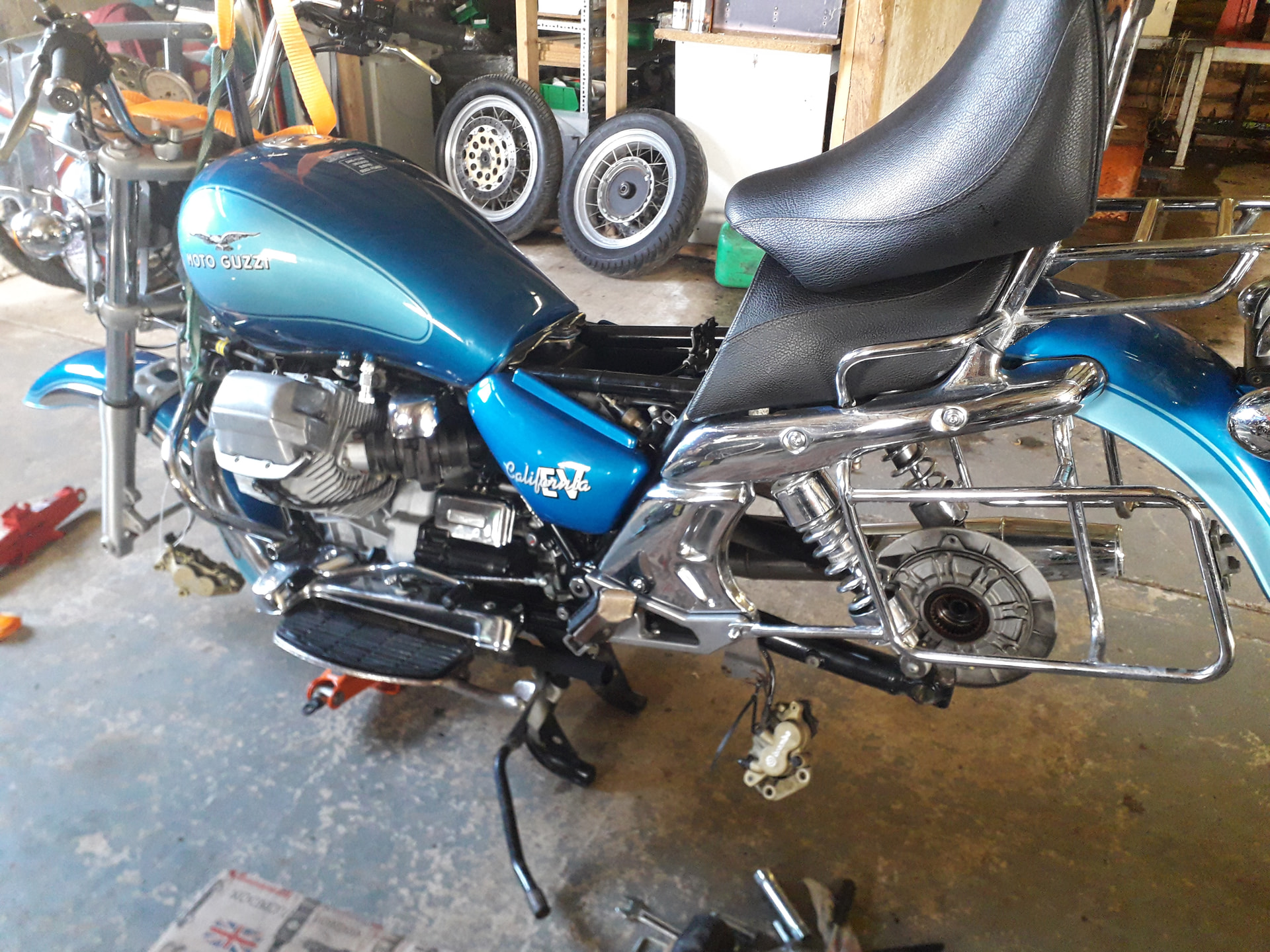

Whilst it's in the air what should I service/check
So I am new to guzzi’s. I have acquired a 2001 California EV 1100 with 5k miles on it. It’s been sat since 2013! I am changing all the fluids/ tyres etc. will be draining and cleaning the tank.
Do any of you good folks have any suggestions about things I should check/ service whilst she is up on the jacks with the wheels off? With such little miles it’s it worth stripping down and servicing the shaft drive? Any suggestions would be much appreciated.

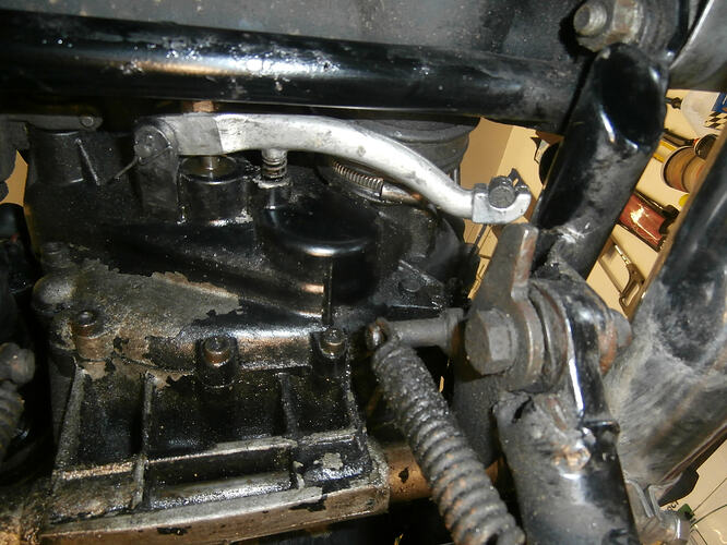

Oooh. I know one. The clutch pivot is prone to crudding up, so that could do with a clean and then (so rumour has it) an internal “mud flap” cuts down on future crudability. Some fine PO cut a section of big tyre inner tube up for mine. Cable tied into place.
Hope this helps.

The clutch arm pivot is a good call. You might want to put a new O ring on the mushroom activator whilst you are in there.This is what it all looks like. Also grease up the shaft and bevel box splines.

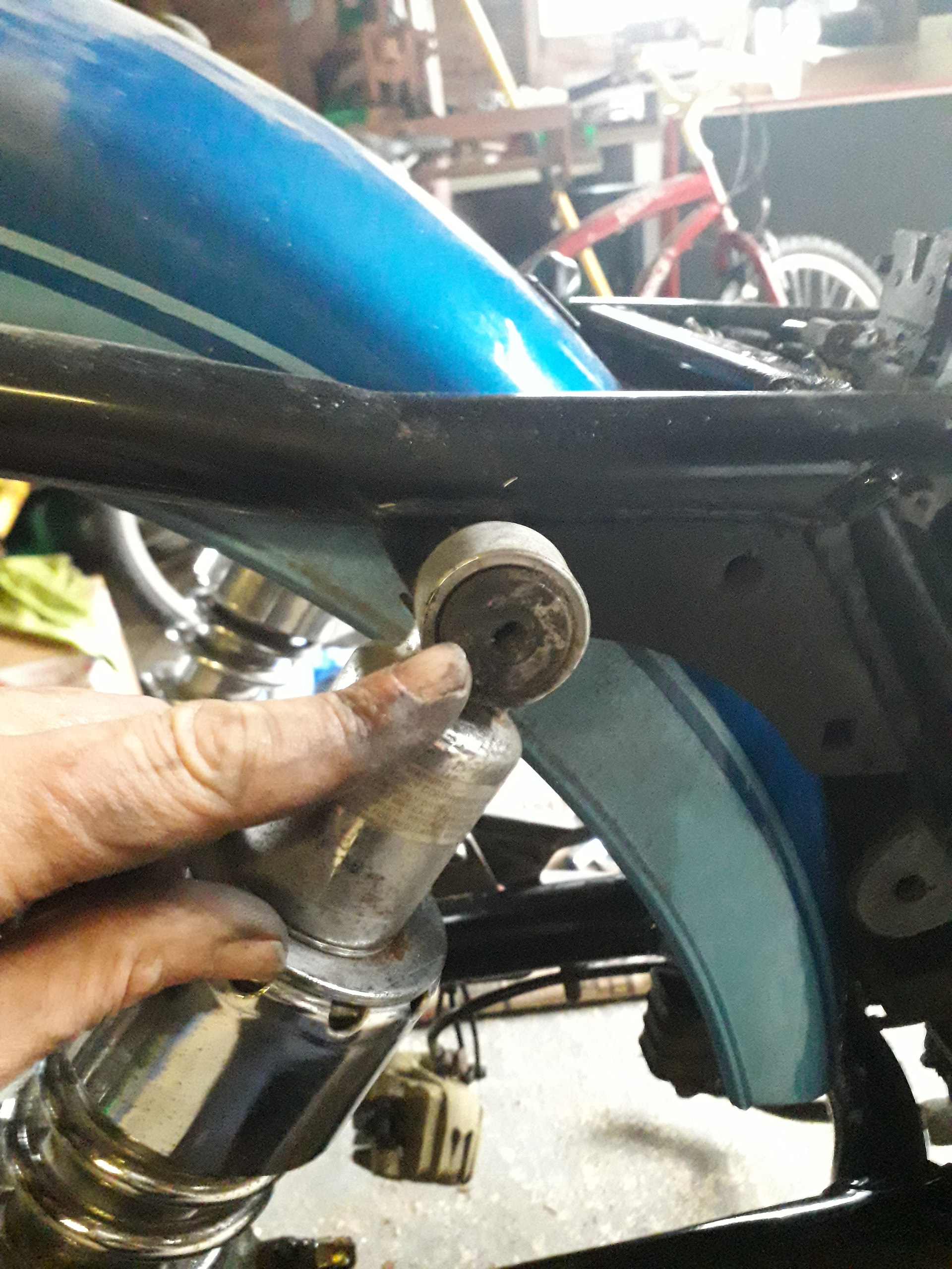

It’s lucky I have decided to take the swing arm off. If I hadn’t I wouldn’t have noticed that someone had left both the top shock retaining bolts off!
Lucky that you spotted that one. Are you sure you didn’t removed the bolts when removing the pannier frames? My Cali 3 is an earlier model, the rear rack and pannier frames use the shock bolts as part of the mounting.
I’m sure, it’s a mystery!

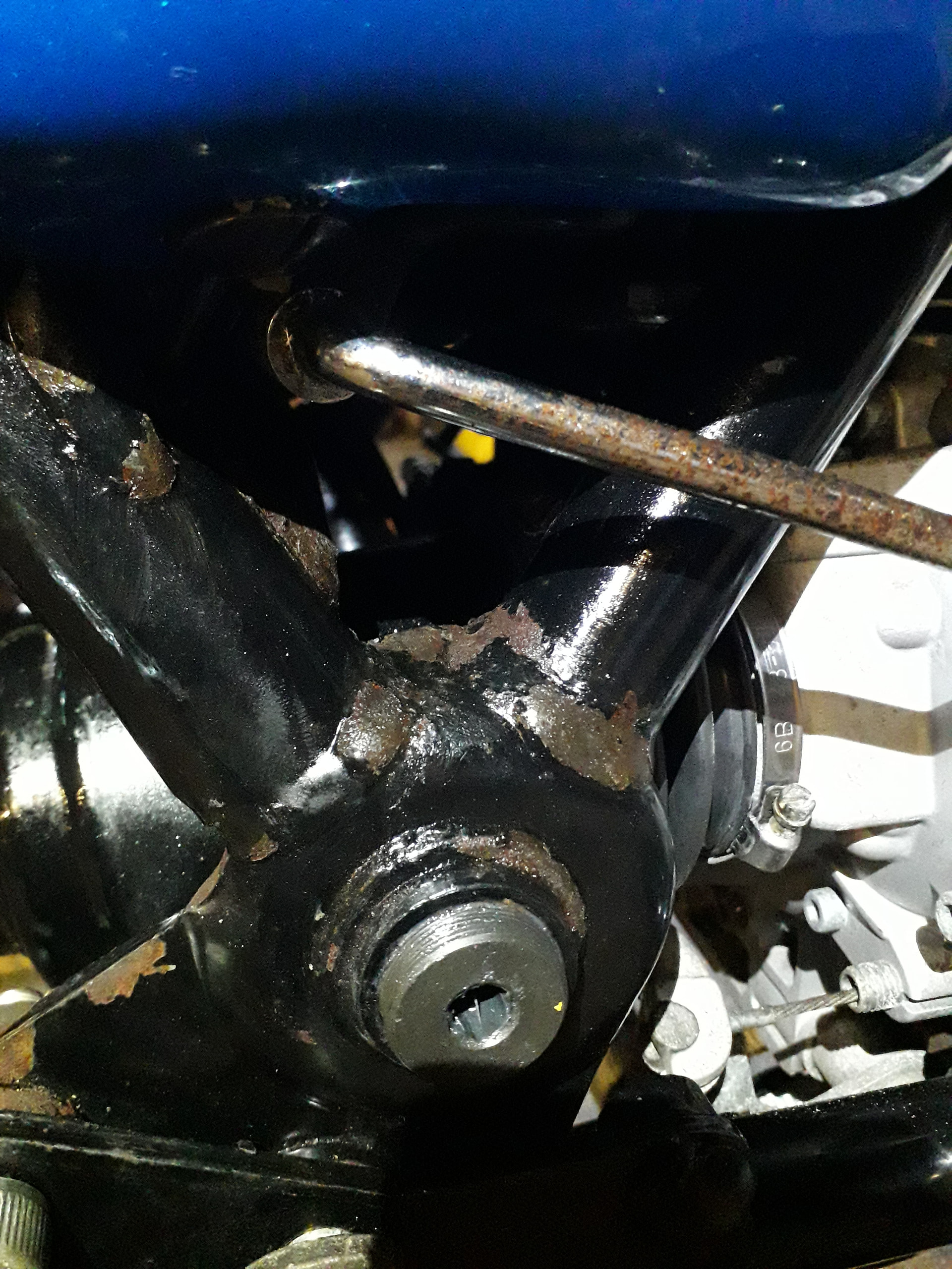

So the threads are protruding 6mm on the right and 5 on the left. So yes, as you say Jeff not exactly equal. When I put it back together should I make them even or put them back as I found them?
Also, pretty much all the frame joints have lost their paint and have surface
rust. I am not wildly fussy but may well strip it right down in the future and get the frame re painted. So for now would it be reasonable to just clean up as best as possible and apply some acf50/ acp? Or, paint??
As Don says, the swingarm should be central in the frame, so equal ‘turns in’ from when the thread engages, be damned careful, they’re really fine thread and easy to cross thread or damage inadvertently.
As for the frame weld corrosion, personally I’d wire brush what I could, then use Hammerite smooth until you’re in a position to get it repainted fully.
Hammerite can be applied straight to bare metal and has rust inhibitors in the mix, not perfect for permanent jobs, but adequate for getting by. Brush-paints nicely as well :+1:
