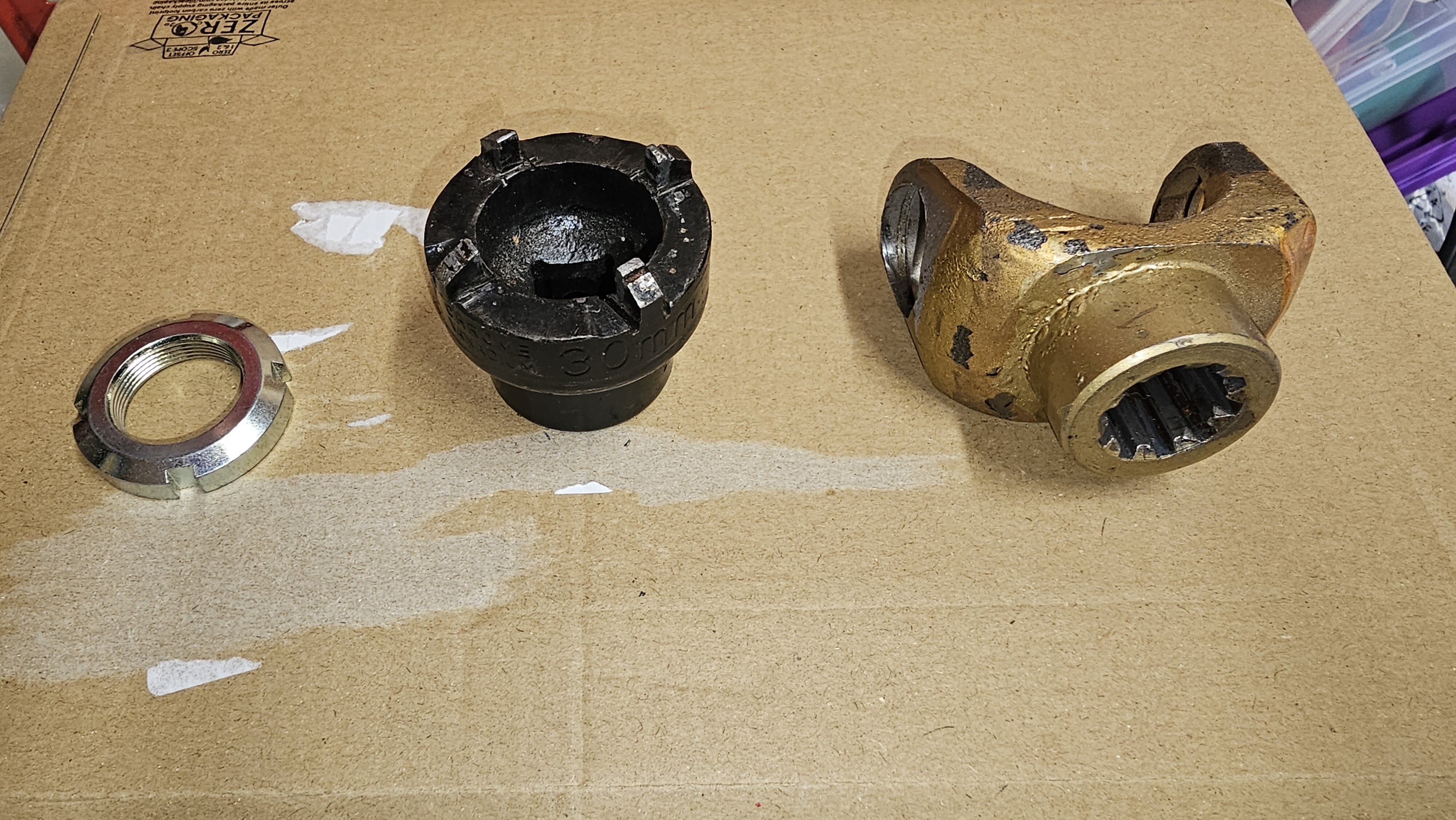

Thanks MrP.Where the gearbox meets the engine at the bell housing, I’ve a leak of gearbox oil at 6 o’clock. I’ll get a scope in there if I can to have a look around. Having read the section in the Haynes manual a couple of times, I’m suspecting the two input shaft O rings behind the input boss. Not worked on this before so it’s all new to me.
There is an oil seal there which you should change.
You will need a peg spanner. I think Gutsibits sell them but they are like a box spanner. I made my own from a 30mm socket. Here is a picture along with the boss nut that you have to remove. I sprag the boss to stop it moving. You can hold the ouput shaft with a spline or a modded uj but be aware that there is a shock absorber in the gearbox which makes it a bit spongy. Better is an old clutch plate center with a handle. I had one but I upgraded to deep splines and it was no use with them.
Btw. This seal is the same dimensions as the output shaft but some seals are “handed” ie the rotation is in opposite directions. Worth checking you get the right ones.
Thank you very much for taking the time and effort in replying with a photo. Yes they show spraging the boss in the manual. I’ll start looking around for what you suggest. Thanks again.
I didn’t know that and probably wouldn’t have thought about it with it in my hand. Many thanks again as that could be a hugely frustrating mistake to make.

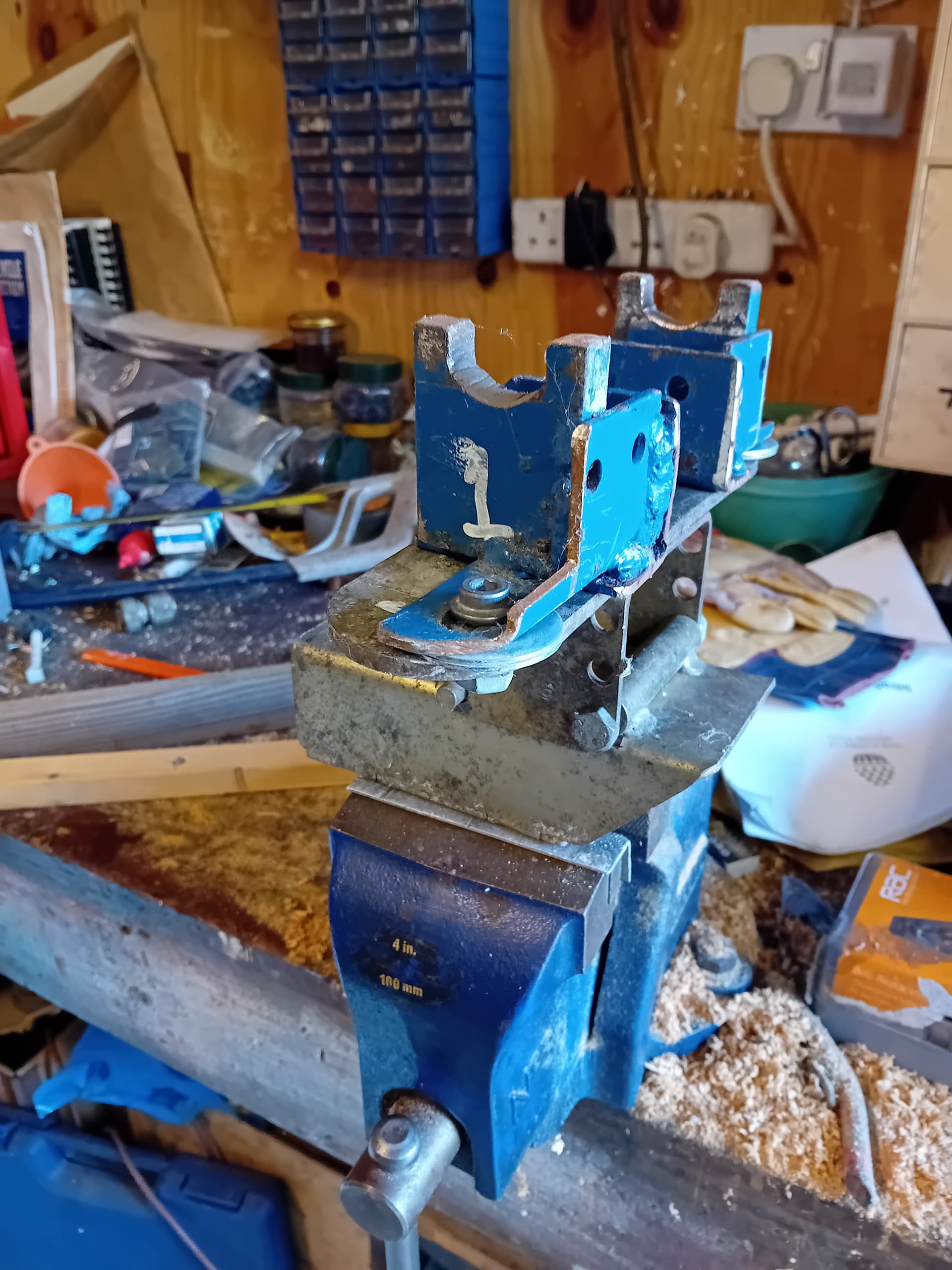

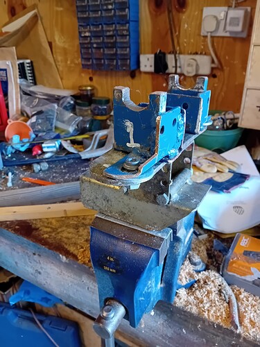

Like the others I too have a lift , I also have a pallet which I cut in half down its length that I use beside the lift to stand on when moving the bike on and off ! It can be stowed outside when not in use !
If you mean the wheel mounts and side stand setup i never got that to work on any of my guzzis, including the V9.
The relationship between the wheels, sidestand and jack never jived.
The Big Breva got lifted with the foot pegs and supported under the sump (that set up is one of the standard options)
V9 is gearbox mounts and sump
For the Cali I built a frame that picked up on the engine mounts at the front and gearbox at the back.
That might fit your 850 and I saw it the other day. What i can’t remember is if I’ve butchered it to make something else.
I’ll have a look in the morning, and if it’s complete you’re welcome to it … watch this space

Sorry - frame was chopped up to lift the V9
This, in a different position picked up the front of the Cali
