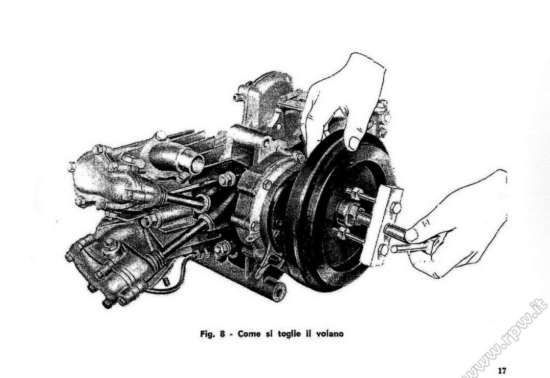

  1. Being that you have worked on both the Pedale and AE models, is there a difference between the two from the perspective of the flywheel mount or puller design? Were/are you able to use the same puller for both? If it’s the same, then I’ll probably just purchase it from Stucchi. From what I can see in the manual, it looks like the puller is supposed to thread both onto the main shaft and into the two holes in the flywheel. Both of these threads seem to be off unusual sizes, and might have some variability (based upon the thread you shared).

Well, I finally received the M7 1.0 bolts I needed for my puller, and attempted to remove the flywheel. Unfortunately, the threads in the flywheel seem to have been abused, and one of the bolts just pulls out from the flywheel with relatively little tension on the puller. Has anyone encountered this before? Is there a recommended methodology for a repair? I could likely re-tap to M8, or could possibly put an insert in (Helicoil, Timesert, etc.), but there is limited depth available.
Any thoughts would be appreciated.
Cheers,
Shaun
Looking at the picture in the manual, the flywheel removal is a straight pull off the taper. so I don’t see any issues with retapping the flywheel thread to a larger size . I assume you can’t get a nut on the back of the bolt to pull against?
Hi Shawn, I agree with Don, drill and tap the current holes to M8. I also think you can drill the holes completely through the flywheel which will make threading easier and result in less risk of damaging the threads when putting load on them during flywheel removal. Keep us informed on progress. The flywheel and nut are well and truly rusted together so I foresee some fun and games trying to remove them. Good luck, Phil

I don’t think there is enough room to get a nut behind the flywheel, but will see if I can manage it before I drill out the holes. Beyond that, drilling and tapping should be fairly straightforward.
The large nut retaining the flywheel came off pretty easily with an impact, so that was fine.
