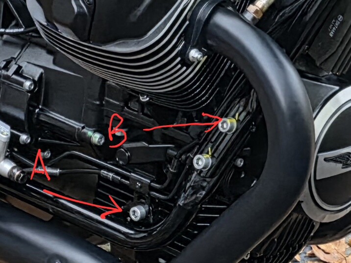

Hello, I’ll apologise up front for posing such a basic question. I have looked in the owner’s manual and searched online but haven’t found the answer yet. I have a 2025 V7 Sport and would like to fit a set of engine bars. Please refer to attached photograph. The bars are an SW Motech item and look to mount to points A & B.
Questions:
1/ what is the purpose of bolt A? Looking at the mounting instructions, it appears to be a long rod that emerges on the opposite side of the engine. There is a supplied replacement rod in the engine bars fitting hardware. I obviously don’t want to remove it willy nilly and have something nasty and unexpected happen.
2/ what are the torque wrench settings for A & B?
Thanks in advance for any assistance you can give.

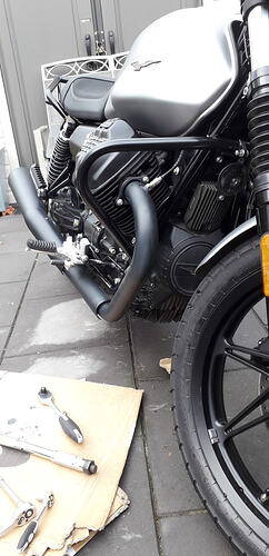

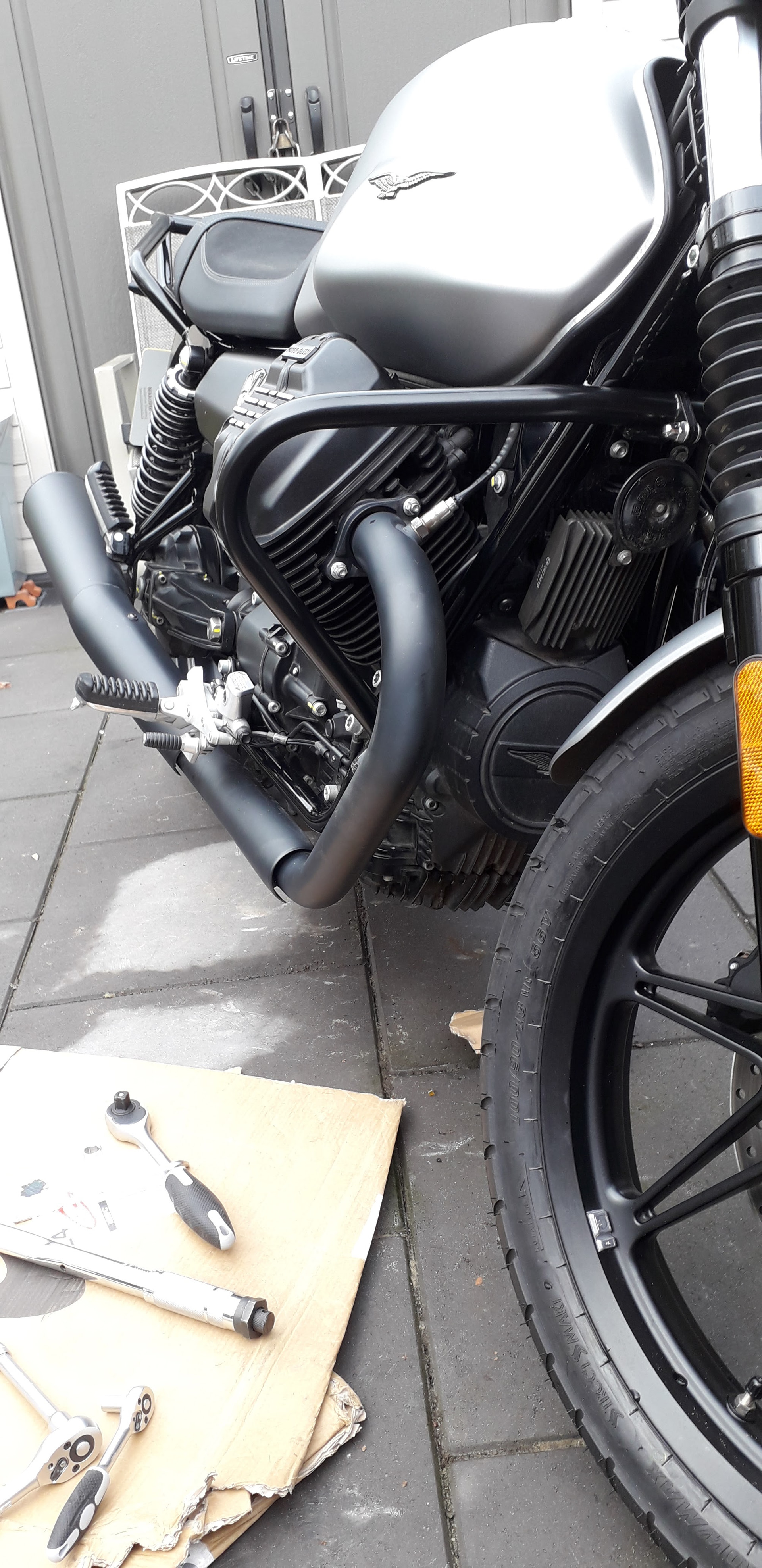

I fitted Moto Guzzi bars to my 2022 V7, which came with fitting instructions inc torque settings as far as I can remember.
I just looked at the instructions and took my time…not as daunting as I initially thought :slightly_smiling_face:
just found a pic :+1:
Just had a look at the SW Motech engine bars…they look the bees knees and will be a fantastic addition to your V7 Sport. Hopefully the instructions should give the torque values….from what I remember should be M10 bolt 58 Nm. M8 bolt 30 Nm. Happy fitting :wrench::nut_and_bolt::wrench:
50nm is the torque number you want. I’ve fitted these exact same bars and they look great, are easy to fit and are lightweight.
