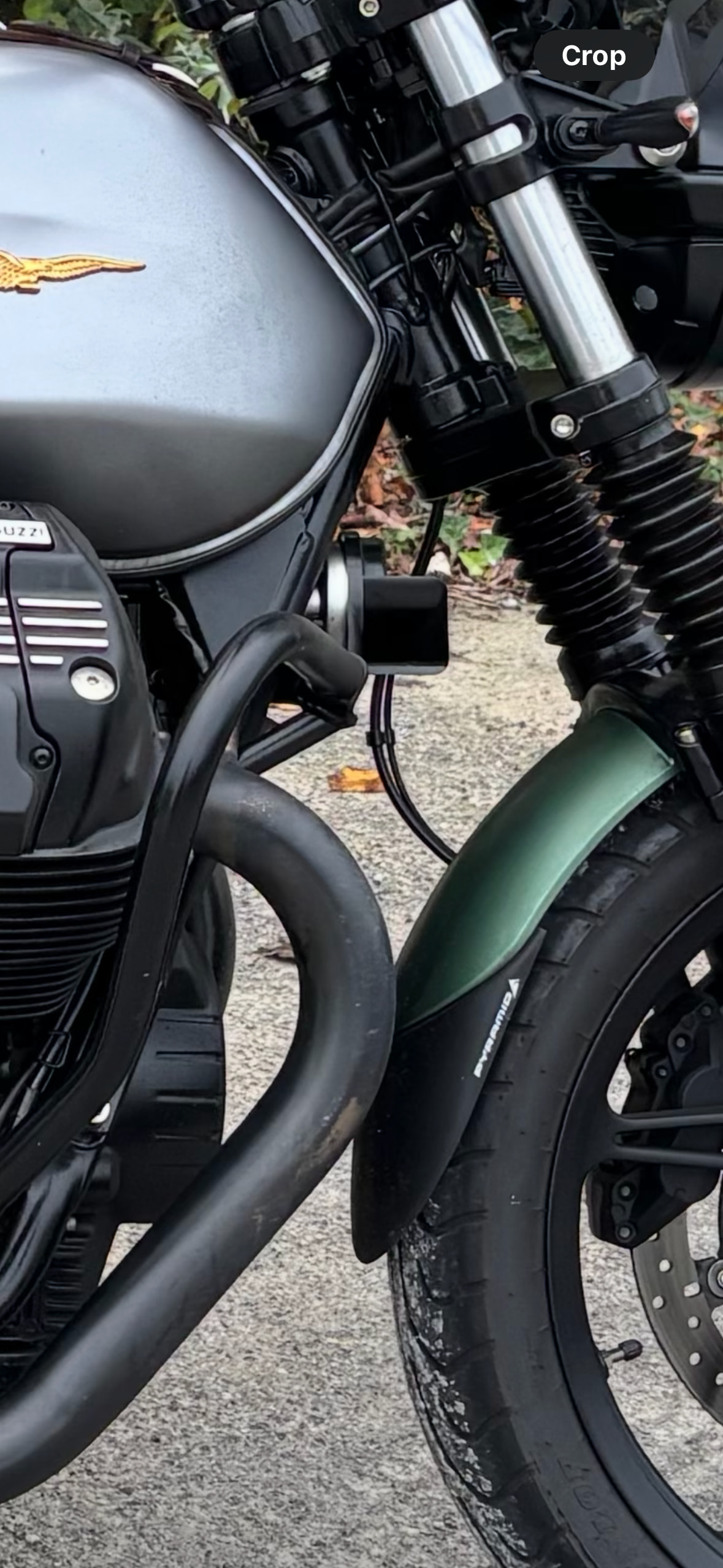

The horn on the V7 is, unfortunately, the other end of the scale of desirability, it sounds like a wasp in a tin. So I thought, no stress, I’ll avail myself of a ‘direct replacement‘ Denali Soundbomb Mini and bolt it to the oem bracket, job done. That is until I viewed a YT video of an owner who’d done exactly that only for the horn to impact the rear of the front mudguard when the forks compressed causing unsightly damage. Any advice in terms of a fitment solution gratefully received.

If you want to be certain that it will not hit then put a tiewrap tight around the fork stanchion just below the fork seal. After a few weeks riding it will have been pushed to the maximum the suspension will allow (this is rarely what a manufacturer claims).
Put the bike on the centre stand and support the sump. Measure the distance from the fork seal to the tie wrap - that is your wheel-travel under full suspension movement.
Now slacken the fork clamps and slide the forks up by that distance. The wheel and mudguard are now where they will be in relation to the frame under full suspension compression so you can see if there is enough room for your mini sound bomb (on my v85tt there is enough room but the steering angle is very flat on these bikes).
When you have done that put the forks back where they were and torque up the clamp screws to the factory figures.

I fitted a Soundbomb to my V85 and recently fitted an Oxford equivalent to my V7. It can be turned and positioned so the mudguard doesn’t hit it but took a bit of trial and error. And best of all the Oxford horn is less than a tenner from Sportsbikeshop.
Have you ridden the V7 with the horn in place and experienced no mudguard damage? A photograph of the fitted horn would be appreciated when you can. Thanks in advance.
I’ll have a go:
