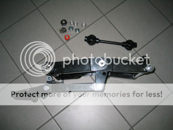

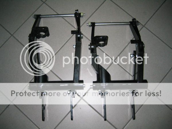

Some confusion here. It’s not a monoshock I’m after it’s a parallelogram swing arm which utilises twin shocks, requires no modifications to the frame and reduces pinion climb when opening the throttle thus allowing you to open the throttle quicker on the exit of a corner without a change to the steering geometry. It also allows you to run softer shock absorbers thereby getting a comfier ride. I’ve got some Ohlins ones in mind to replace the Konis that I had built for me by the Koni overhaul facility at Farnborough when my mate Paul worked there. Here’s what it looks like on a LM3

From memory the Harris one is twin shock.

I understand that this is off topic but the Harris conversion was mono shock, I have seen it and have photos to confirm ![]()

Might be a shot in the dark but have you tried talking to Stein Dinse in Germany? I have a vague feeling they might be agents for Magni or something, or if not might know something. Mandy there speaks English. I have seen a Magni swing arm assembly on a MK11 Lemon last year so they definitely did a kit at one point.
Failing that it might be worth trying Teo Lamers in Nijmegen.
