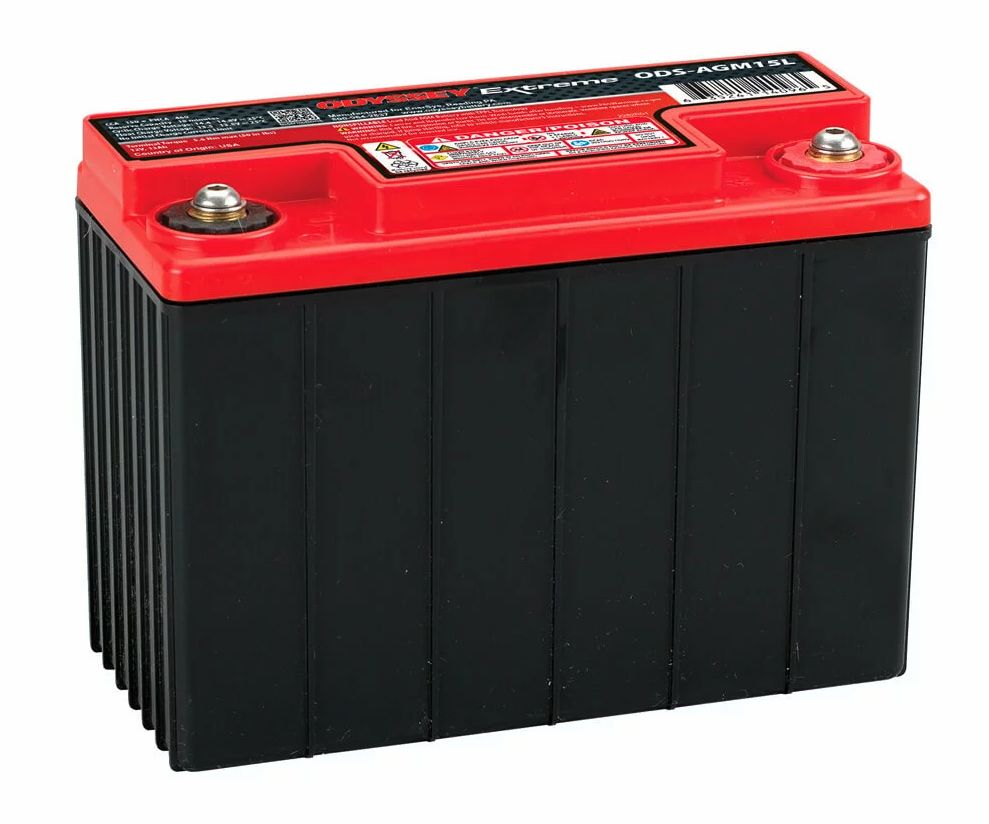

I get Odyssey batteries from www.Motorworks.co.uk

My personal view is that the Wesco variety are better value for money than the Oddysey. I have had both in the past.
