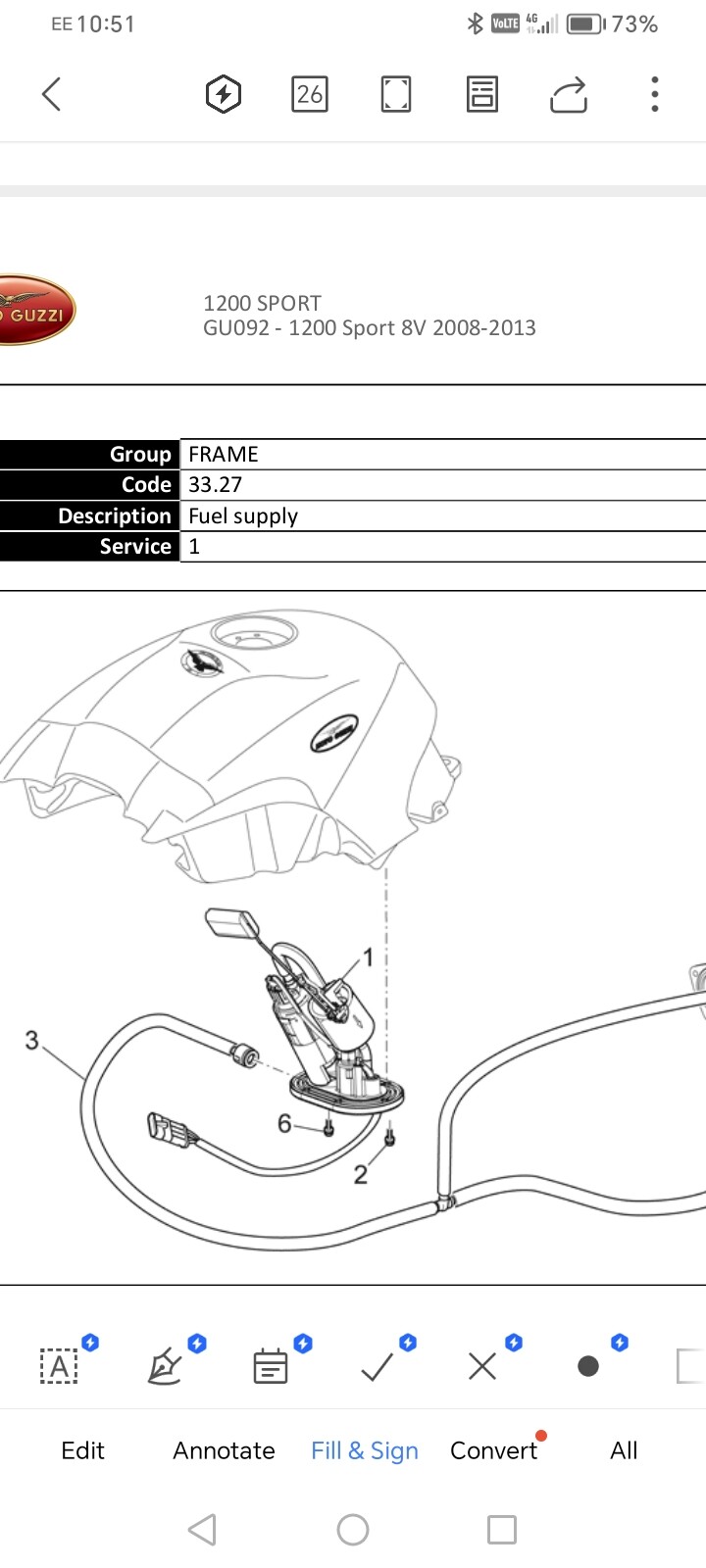

Hi all, I’ve just bought a 2006 1100 Griso and discovered the low fuel light doesn’t work. Looking at the parts diagram, the sensor doesn’t seem to be listed separately.
Has anyone replaced it on theirs? Any help, ideas and tips appreciated.

I am pretty certain that it is part of the pump assembly in the base of the tank. If you are taking that out be prepared to replace the fuel filter (some are plastic and swell and burst) and the internal hose to the pump (some are not rated for fuel immersion swell and fall off- seriously!!).

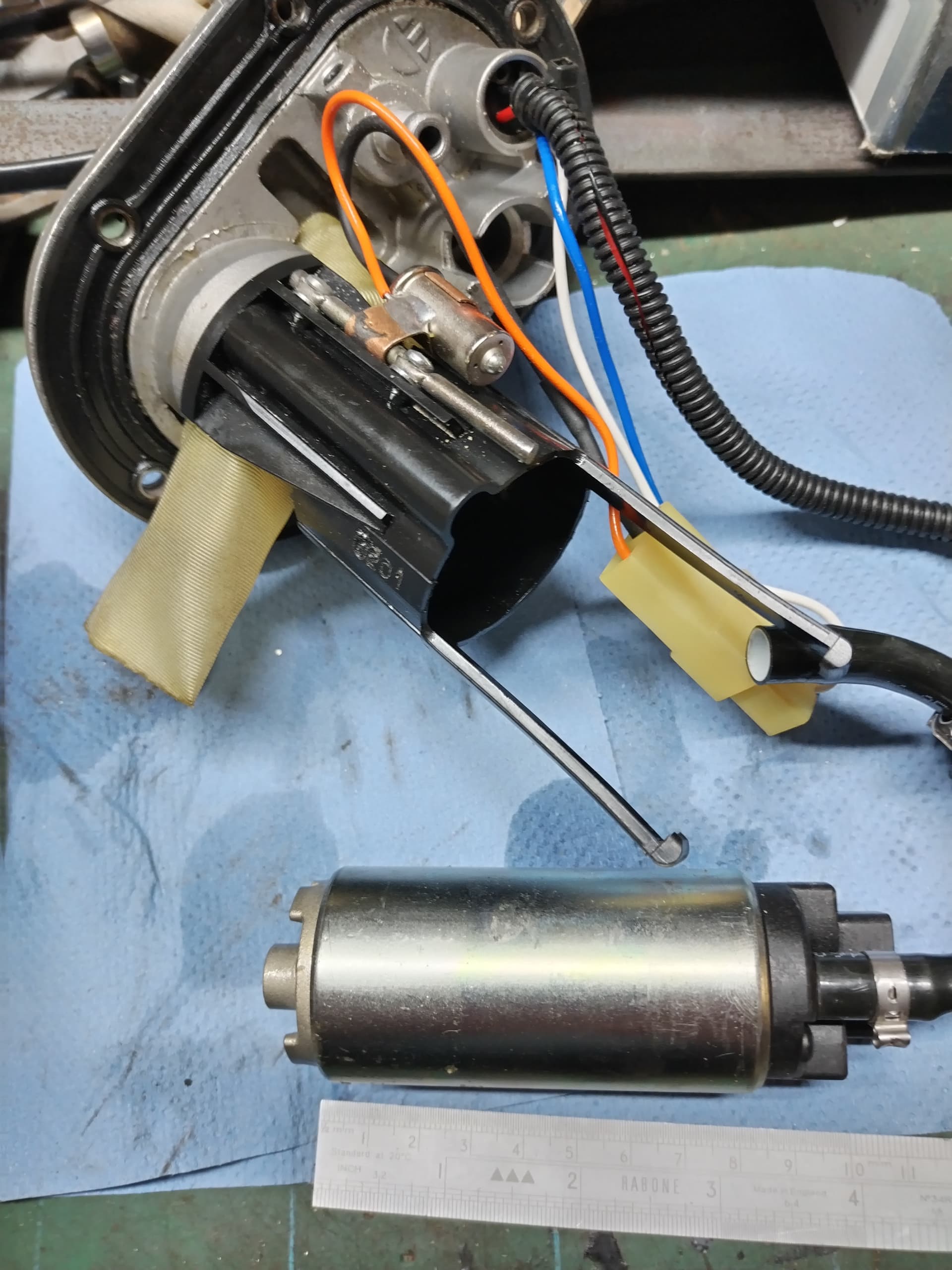

It may be a small sensor
The component in question is that cylindrical thingy, a thermistor, under the loop of the orange wire in the picture from Brian.
Assuming the bulb and wiring are sound then most likely the thermistor has blown.
Inside that cylinder is a thermistor connected to the input wire at one end and the other end to the cylinder body, with appropriate insulation.
Whilst there is fuel in the tank to absorb electrical heat, the thermistor maintains a high resistance thereby breaking the circuit. As fuel level drops, less fuel to absorb the heat so the resistance reduces allowing the lamp to illuminate.
I repaired mine when I wanted to reduce the level at which the light illuminated. I’ve got it down to around 5 litres now. It used to come on when there was still half a tank of fuel!

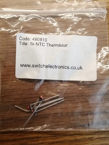

Traced old invoice.
Bought 5 x 1k Ohm thermistors for £4.58 delivered. Blew one when playing, another lost to over zealous soldering, one fitted last April and the remaining two were put in a safe place for future use. If only I could remember that safe place :grimacing:

Hi Gussitano I have the same problem with my 2007 Griso. Can you be more specific with regard to the thermistors as when I look for these these come in many shapes and sizes. Thanks.
Hi Tzindo, hopefully he will as I’m also slightly baffled by the choice and struggling to find a metal bodied one but I believe it will need to be NTC.

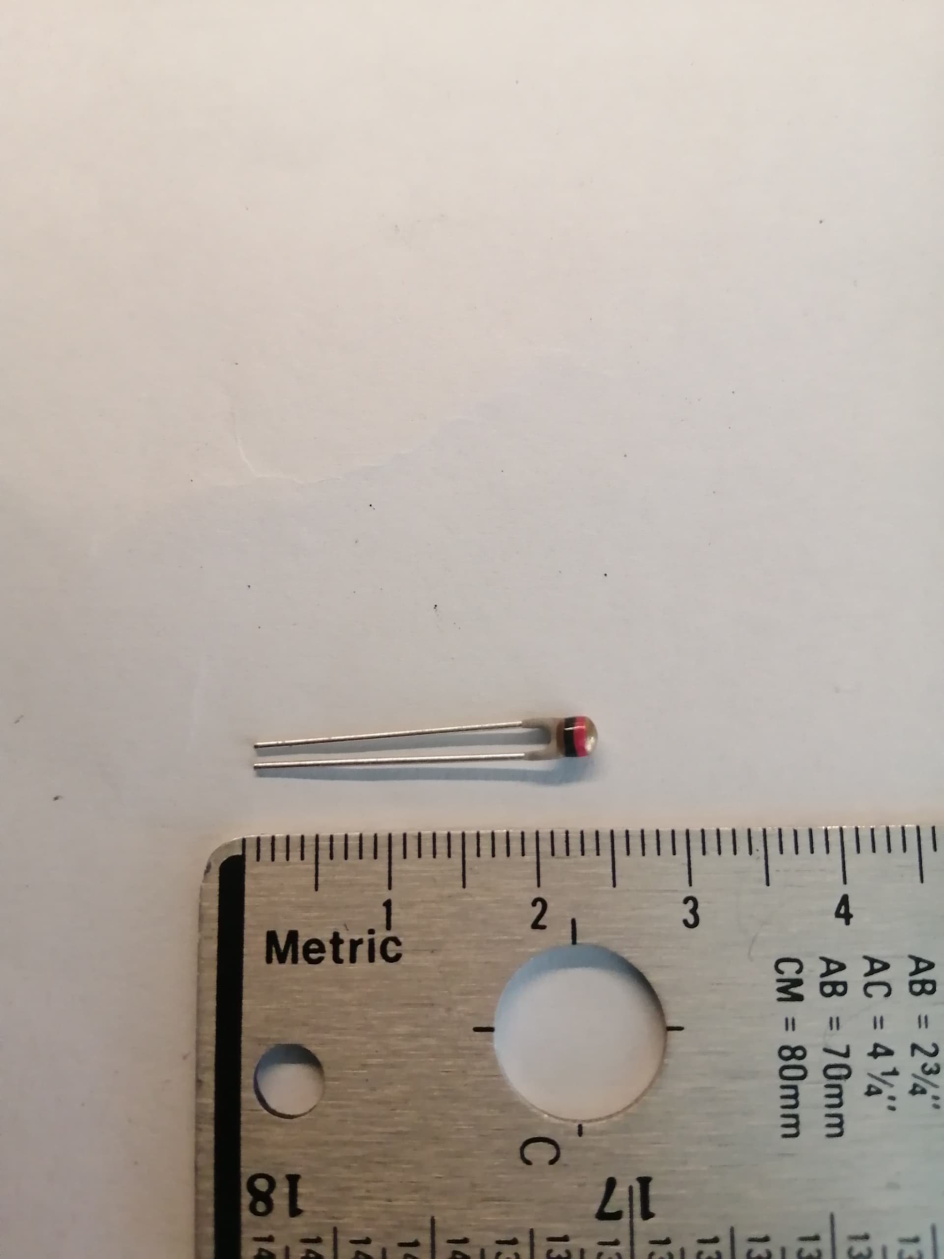

Hi guys,

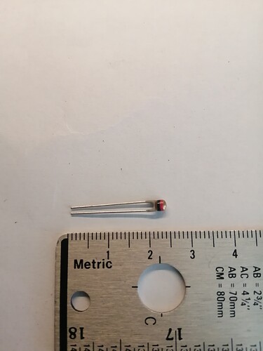

The thermistor is inside that cylinder which itself is soldered onto the mounting bracket. Thermistor is about 3mm long with a connection tail at each end. The feed wire from the wiring loom / plug connects to one tail, insulated from the cylinder and the other tail pokes through a small hole at the base of the cylinder and then soldered.
Here’s a couple of pictures.
I am not connected in any way whatsoever with the retailer.
I had to unsolder the cylinder ‘holder’ from its mounting bracket. Then carefully prised open the crimp of the cylinder which is folded over the insulation cap. Less damage the better as you need to reassemble / crimp. Inside I found the thermistor with a broken tail which proved the open circuit. Still unclear as to what caused the break. Then I bent the tails North and South to reach the input wire and poke through the hole at the base of the cylinder. Once suitably bent and cut to length, I fed the input wire through the insulating cap, soldered one tail of the thermistor to the input wire, poked the other tail through the base of the cylinder, trimmed it and soldered from the outside.
Then in my excitement I rigged up a temporary circuit to test and yep you guessed it went POP!!! Well I did by 5 units.
Repeated the process.
Then did the test rig again. This time immersed in a jug of petrol. It gave me an opportunity to research read and learn that petrol is not conductive to electricity. I did not know that. The test proved all good and so it was remounted onto the bracket which I had repositioned a little lower.

Omitted to say that the NTC bit is important. It defines the operational direction of the thermistor.
This is an extract from Wikipedia:
Thermistors are categorized based on their conduction models. Negative-temperature-coefficient (NTC) thermistors have less resistance at higher temperatures, while positive-temperature-coefficient (PTC) thermistors have more resistance at higher temperatures.
